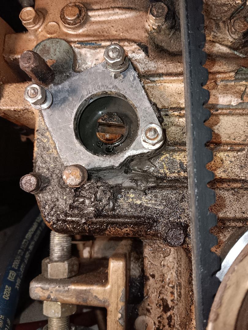

Any ideas on how to repair this (see picture). Atleast good trheads still exist in the bottom bolt hole. Thanks

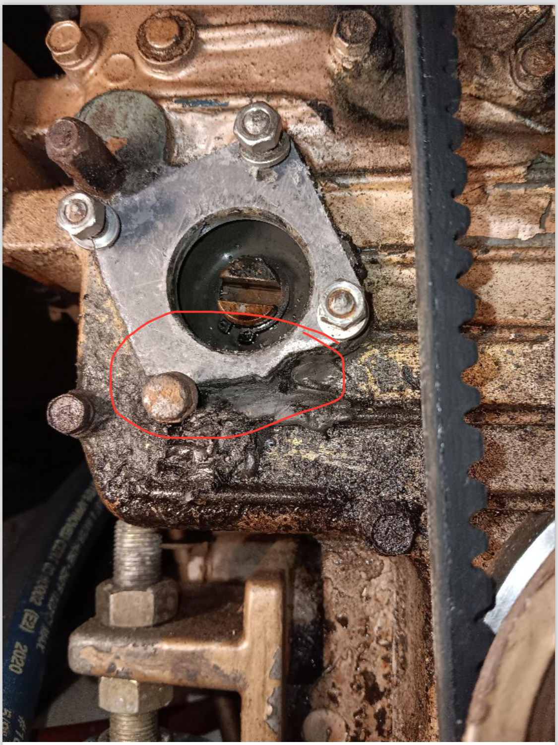

I had to do that but JBWeld is ineffective for that application. I used DEVCON. Comes in large cans or small tubes. They're not bolts, they're studs into the engine gear case cover.I've read of owners cleaning the area really well and using something like JB Weld to rebuild the flat surface and around that area to rebuild thickness.
