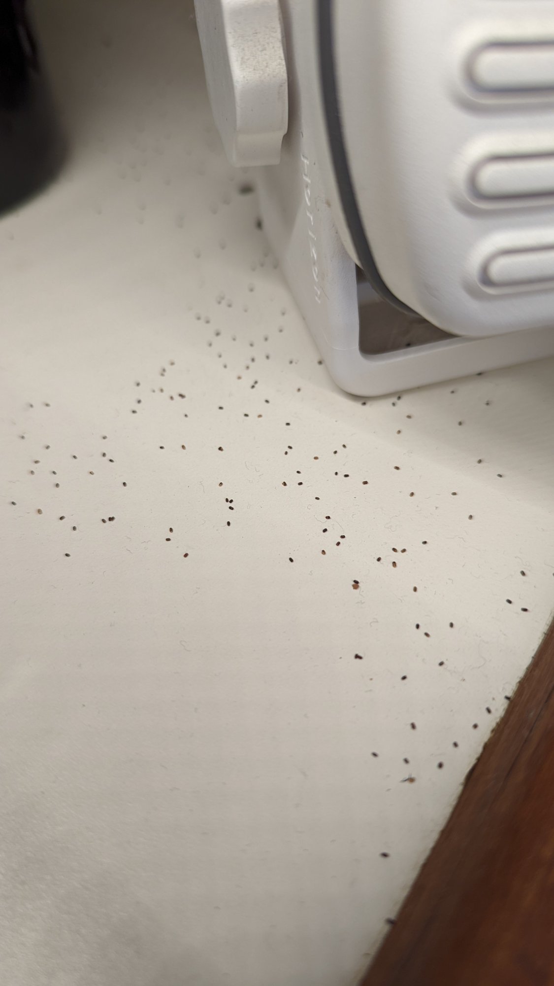

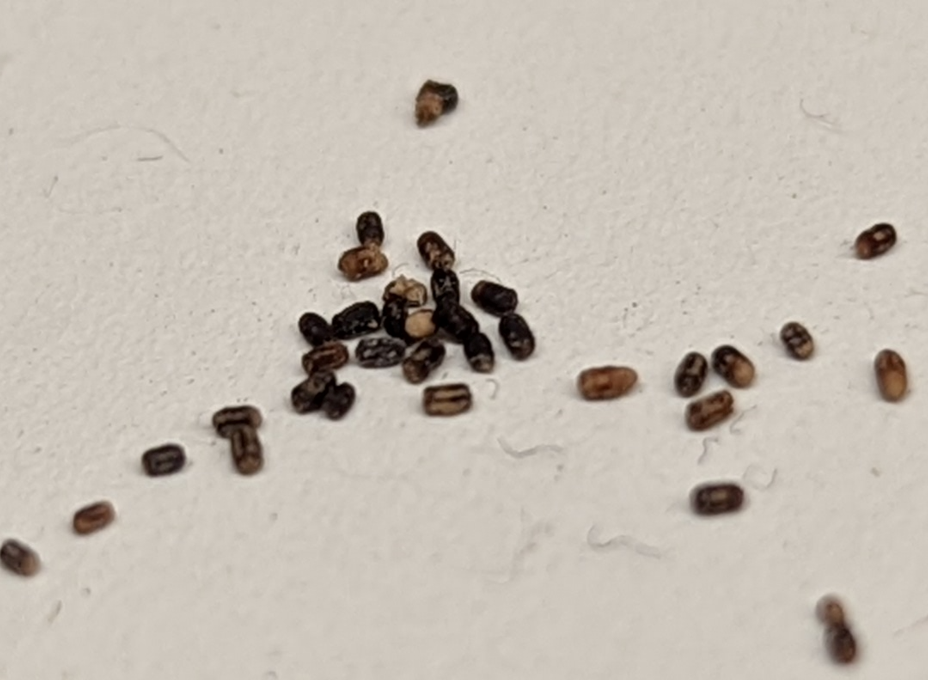

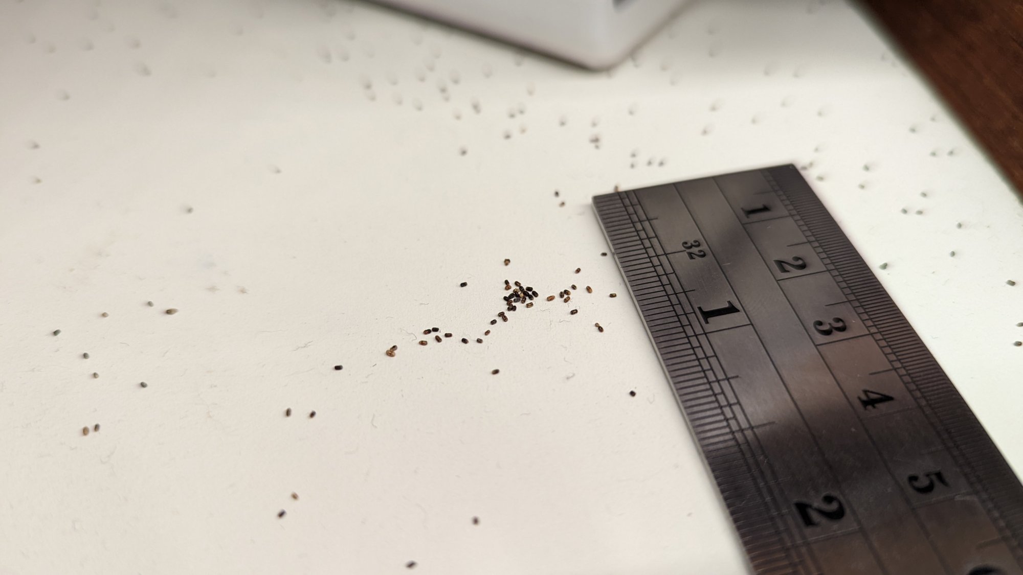

I think I have Termites - Help!
Mar 6, 2008
1,515
Looks like rat droppings. Termite droppings are much smaller, more like sugar granules.
