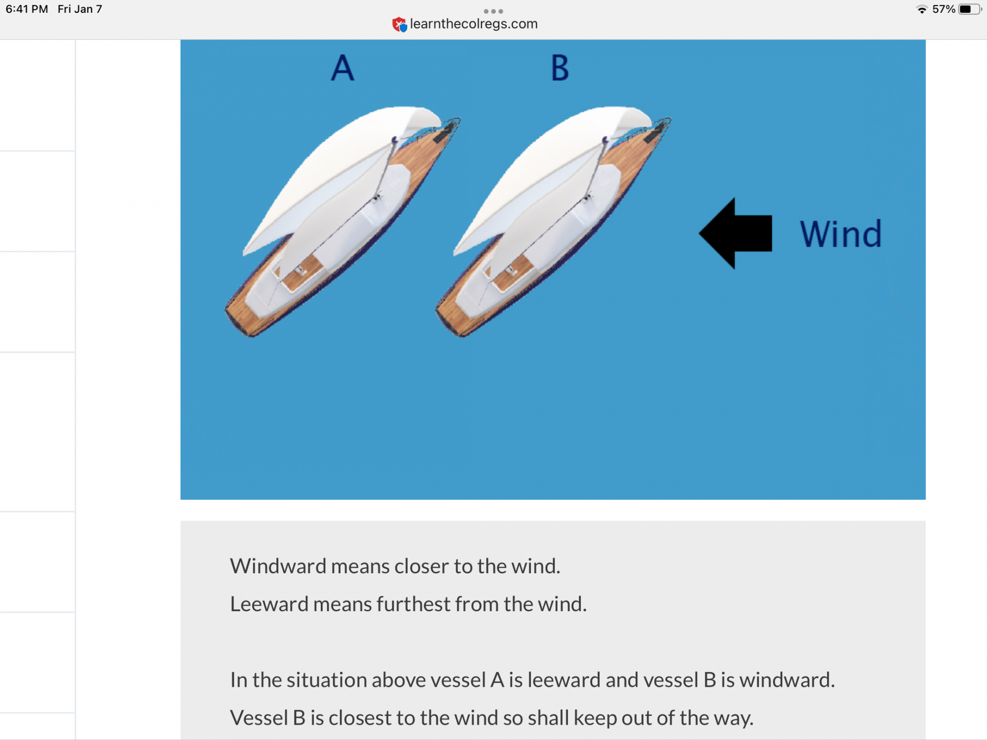

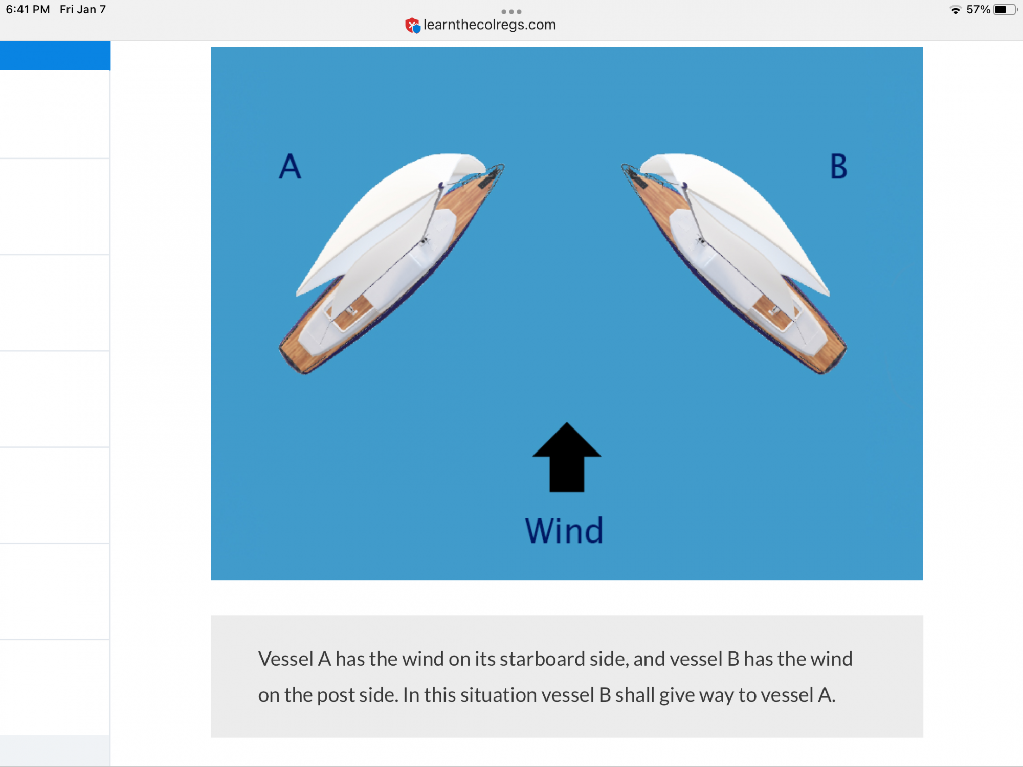

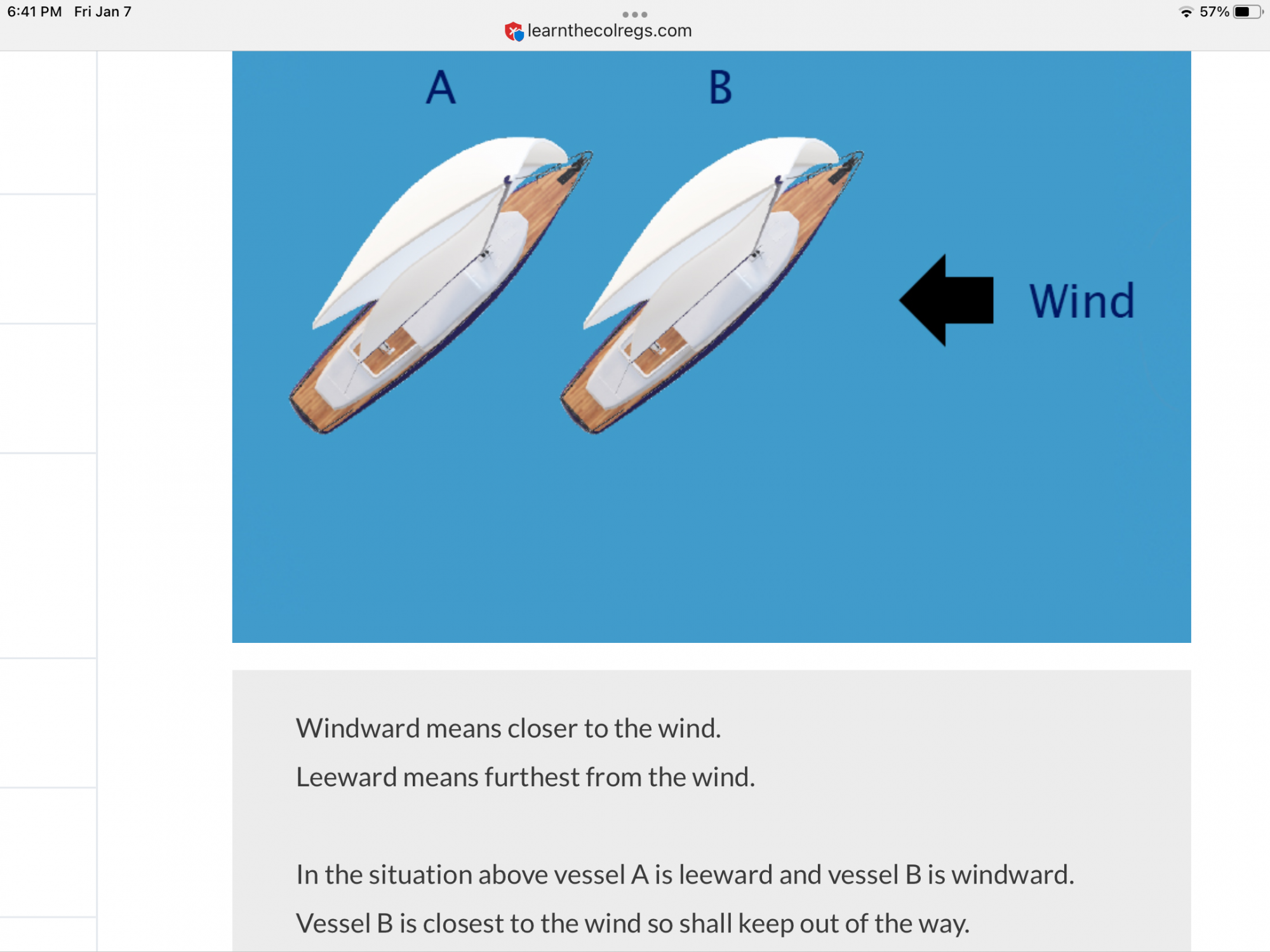

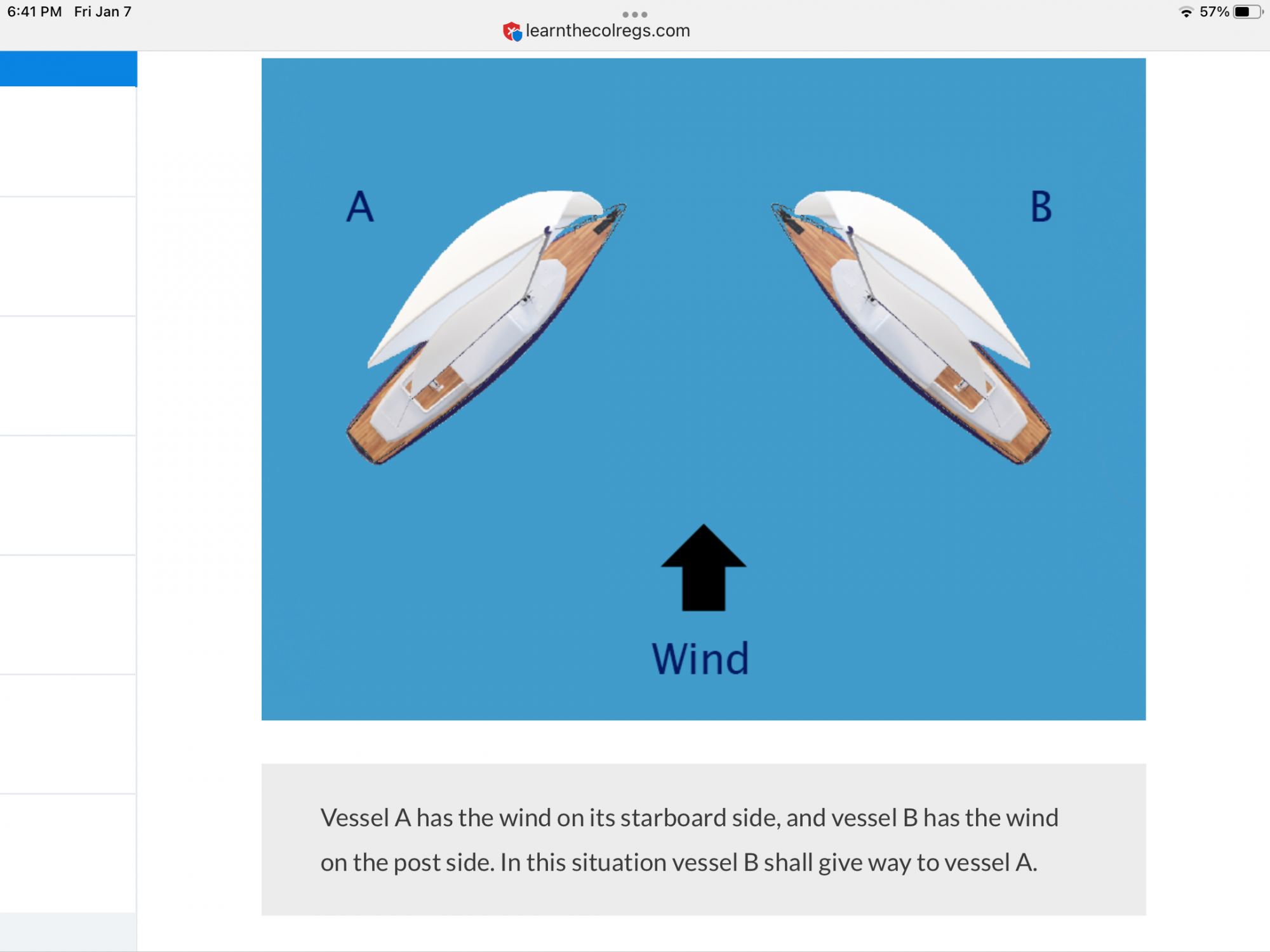

Sailboats, as long as they’re both purely under sail, do have their own COLREGS rule. It’s rule 12 and it does have the port tack/starboard tack and Windward/leeward provisions. Like sailfanatic said above the video is targeted for power boaters where that rule doesn’t apply.
Ok…thanks. I think I understand these…
EE4A39D2-1157-4A82-A0E3-5522AE0CDBD9.png And 468AF67C-A67D-4973-9D12-4194A694C588.png
Thanks for clarifying that these are applicable for sailboats under sail.
