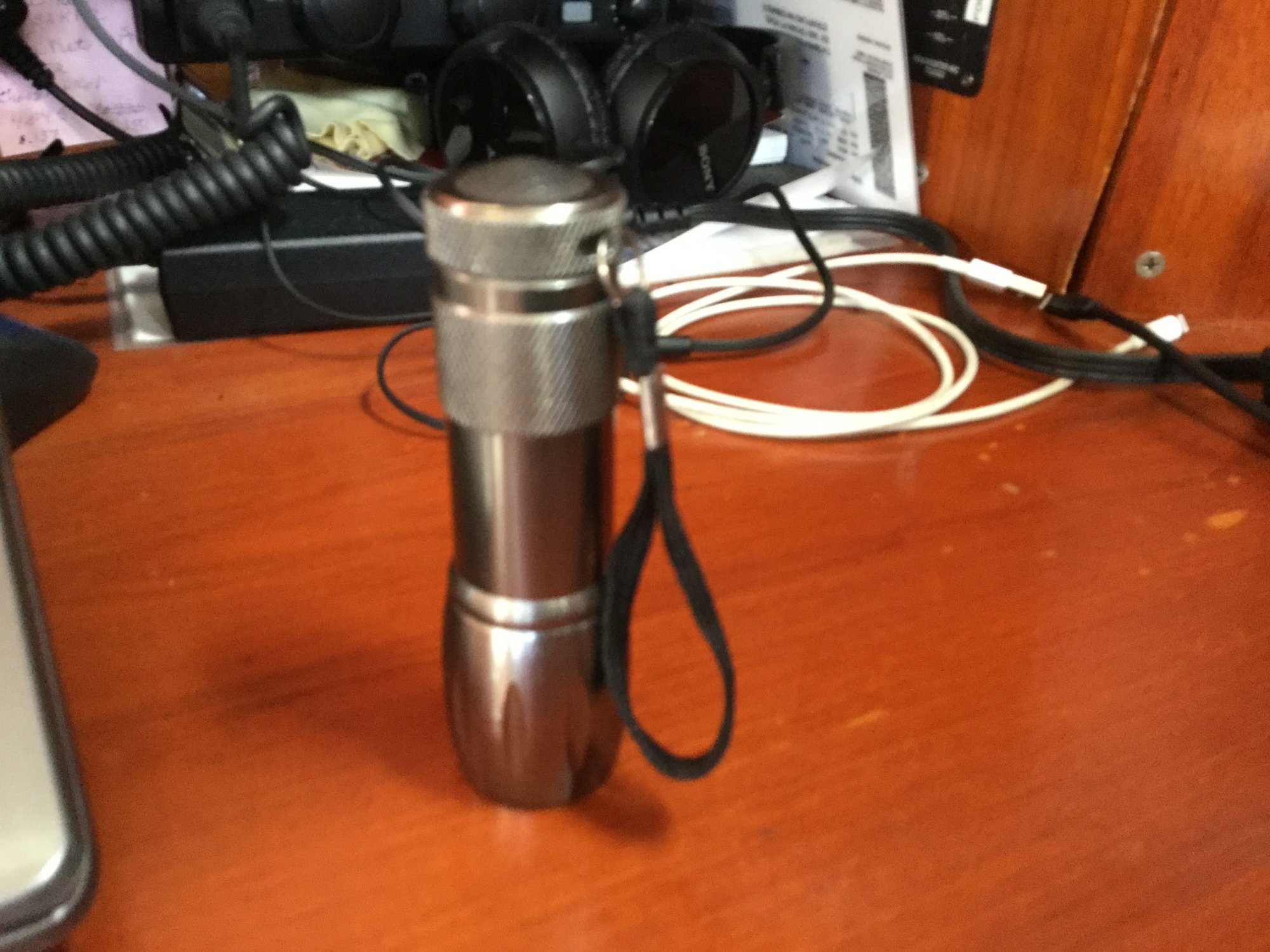

Hi all,
Its that time of year when I post one thing you may find useful on your boat. This year I have been reviving my LED flashlights by adding a new penny. Most of these lights have a battery pack with three AAA batteries and can’t maintain contact well enough for good lighting. I’ve been putting the new penny between the little spring and the negative end of the battery pack. The light is now stronger and doesn’t go out when you turn it around.

.View attachment 172650
Cool idea. I have several of those intermittent LED flashlights. If a new penny isn't available, an old one could be cleaned up with some copper polish or ketchup.

I think every bloody LED flashlight I've ever bought (with the three AA batteries) has that intermittant problem. Got to try the penny spacer.

This is absolutely brilliant. I have seven of these lights and many of them no longer work correctly. I took one of the worst offenders, inserted the penny, and voila, bright light.
Thanks so much. One of the better tips I have seen on this board.
