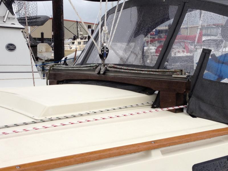

Patrick, ours has the traveler moved to the cabin top. It's the original Nico Fico and going to replace it with a Harken. Only downsides are its away from the helm and it's farther forward on the boom so less mechanical advantage. I can post some pix but not for a week or so

cabin top traveler
Here's a shot of our traveler on the cabin top. the PO made it out of teak but Harken has the whole kit. I'm going to retain the teak as it's already made holes in the cabin top. The only weak spot is the PO did not use backing plates inside. Easy fix. Hope the pix works.

Thanks. Interesting teak bridge. I am going sail her for a while more and most likely purchase an entire kit towards the end of the summer. I think I would make the traveler track longer.

I agree the track could be longer. But, I'll live with it (at least for awhile). Also, when we bought this boat, both cabin windows below the traveler were cracked/actually broken and leaking. I had a question if this was caused by loads induced by the traveler on the cabin top. The surveyor did not think so and the local yard guys here did not think so either. And, it was pretty evident the boat had not been sailed much. Motored yes but not sailed.
