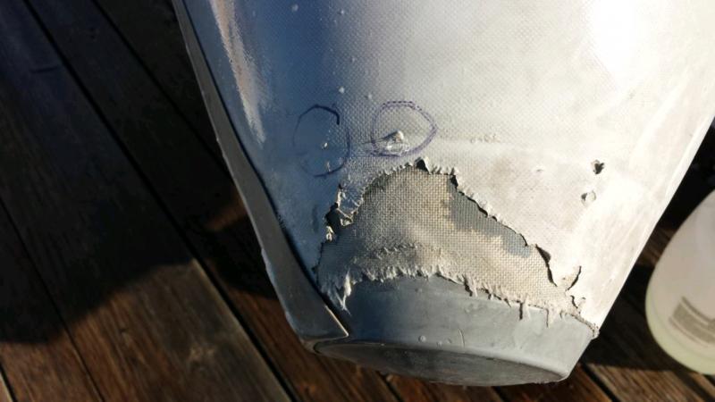

Beautiful! I exclaimed after seeing the dinghy cover for the first time. It was a hassle to put on, but no problem. It's protecting my dinghy. It obstructs my view behind me, but no problem! It cost a bunch of money, but that's okay. It's protecting my dinghy! Many people get 20 years use from a hypalon dinghy but I only got 10. That expensive, work intensive, view blocking cover rubbed a hole in my Aquapro. Even a professional patch attempt could not repair the damage. $2000 learning experience!

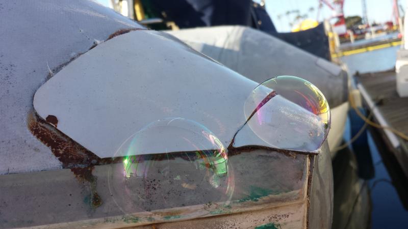

I guess the only thing that can be said for the benefit of others is to inspect the dinghy frequently to catch any developing problems in time. Canvas covers can be abrasive and in time will wear the finish off of metals so it is not surprising what it can do to Hypalon. As far as fixing, check with a life raft repair business and get an estimate to see if it is worthwhile. It seems you have placed a patch and still have a small air leak but pumping it up before every use and keeping a pump handy might be a solution depending on your needs.

If that's a professional patch, I'd get my money back. No way that repair job is anything more than a 'botched job'.
We do better work than that and our repairs work for YEARS, using epoxy glue, and we don't have the availability of a shop and the proper tools out here on the anchor. Even our lifting points for the davits have stayed on for years now.
If you can clean off all that glue, I'd paint the bare cloth with the proper paint first. Once saturated with the paint, you can identify any leaks and patch them separately. I do not see your dink as a total loss, if you can clean off that mess your "professional" made.
