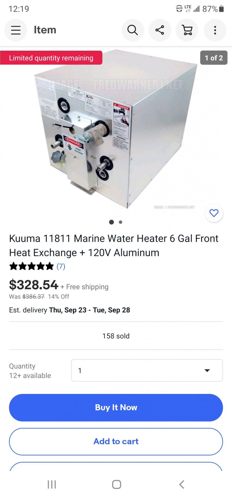

I've decided to upgrade the plumbing on my 1986 C30 Mk2. It came with just the hand-pump faucets. I've already ordered a hose connection for shore-water, an electric water pump, little pressure tank, galley/head faucets, and a hosed showerhead that connects to the head faucet in place of the aerator. The last big thing I need to decide on and purchase is a water heater. The screen shot photo attached shows what seems to be a pretty good deal on a new Kuuma 11811 from EBay. Does anyone have experience with this heater or at least one from the same manufacturer? It seems to me that this model must be very similar to OEM for boats that came with heated water, right? I haven't done any measuring yet and figured out exactly where it (this model or another) should be installed yet. Has anyone else done the same upgrade to your C30? Thanks in advance for sharing any lessons learned.

Hi Jim, That's interesting, do you know if the model you installed was the Kuuma 11811, or was it a similar model? This model has these dimensions: 19.75″ D x 13.75″ W x 13.625″. Where in your boat did you put it? I think I saw a drawing that showed they are typically under the quarter berth somewhere?

Thanks a bunch jssailem! That is a bit cheaper than the next best price I've seen. Were you referring to the Isotemp cylinder shaped ss heaters? I did some looking at them and absolutely like several of the features, but I'm also concerned about some reliability issues that they seem to maybe have as well. Checkout this YouTube video and read the comments from a few others who have had leak issues. One guy is on his 3rd one and it's leaking again...

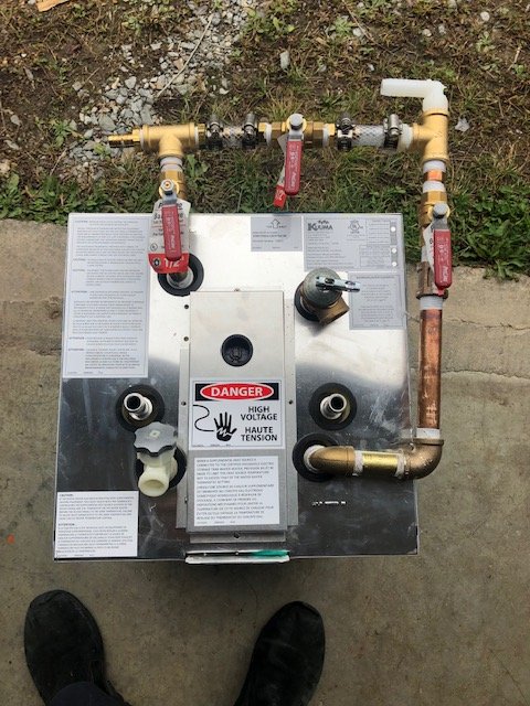

I installed the KUUMA as well. In the attached pic you can see the winterization manifold. When all valves are in the vertical position it is on summer mode. Turning all horizontal, bypasses the tank so that I'm not wasting 6 gallons of RV antifreeze.
Likes: Mooseman

I installed the KUUMA as well. In the attached pic you can see the winterization manifold. When all valves are in the vertical position it is on summer mode. Turning all horizontal, bypasses the tank so that I'm not wasting 6 gallons of RV antifreeze.View attachment 198481
Well done! I used lay out piping l for hydronic heating systems houses and small buildings with radiant floors baseboards radiators boilers heat exchangers water tanks modulating valves circulators... but I hope you most frugal boat owners aware, a kit to bypass a water here can be bought for under $50! There's one on the water heater in my boat surprised me, it will get transferred to the new water heater!
