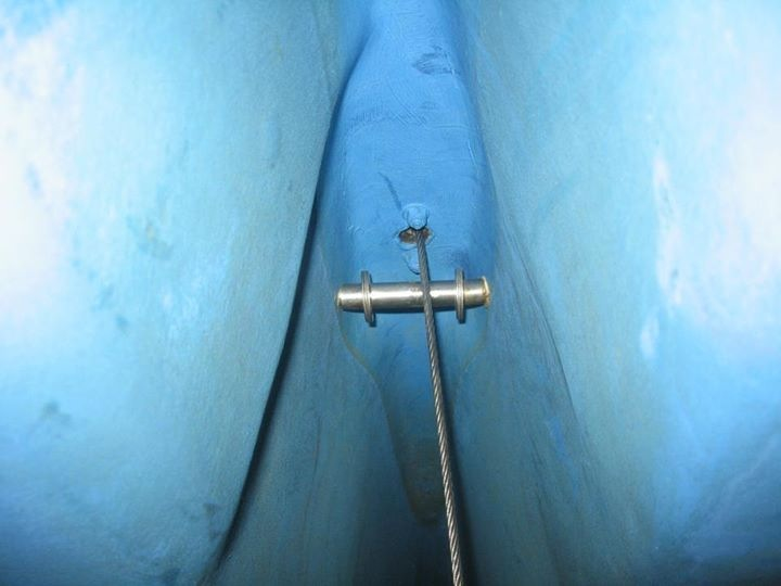

CUSCUS, with the swing keel there is some abrasion that takes place at the bottom of the cable exit hole of the trunk as the keel is lowered away or raised.... I am not aware of any boat with a true swing keel that doesnt have some abrasion in this area.
I would think a cable would be more durable and dependable under these conditions... IMHO;)
I thought about the synthetic as an option but the wear issue decided against it. I would agree with you about the abrasion. Looking at the stainless steel exit fitting that the cable passes through there is a noticeable groove worn in it. Will go with the 7x19 wire.

CUSCUS, with the swing keel there is some abrasion that takes place at the bottom of the cable exit hole of the trunk as the keel is lowered away or raised.... I am not aware of any boat with a true swing keel that doesnt have some abrasion in this area. I would think a cable would be more durable and dependable under these conditions... IMHO
Yeah, forgot about the stock Macgregor exit point being a rub spot. I didn't even like the wire rubbing, so I modified it. Now with using the Dyneema, I got rid of the ss tubing, and just let it run in the bare bolt.

The only abrasion I found on the Mariner was where the line from the exterior pulley went through the top of the trunk. The steel cable had worn an irregular hole in the fiberglass. I drilled the hole larger and made a bronze bushing to fit, which was epoxied in place.
