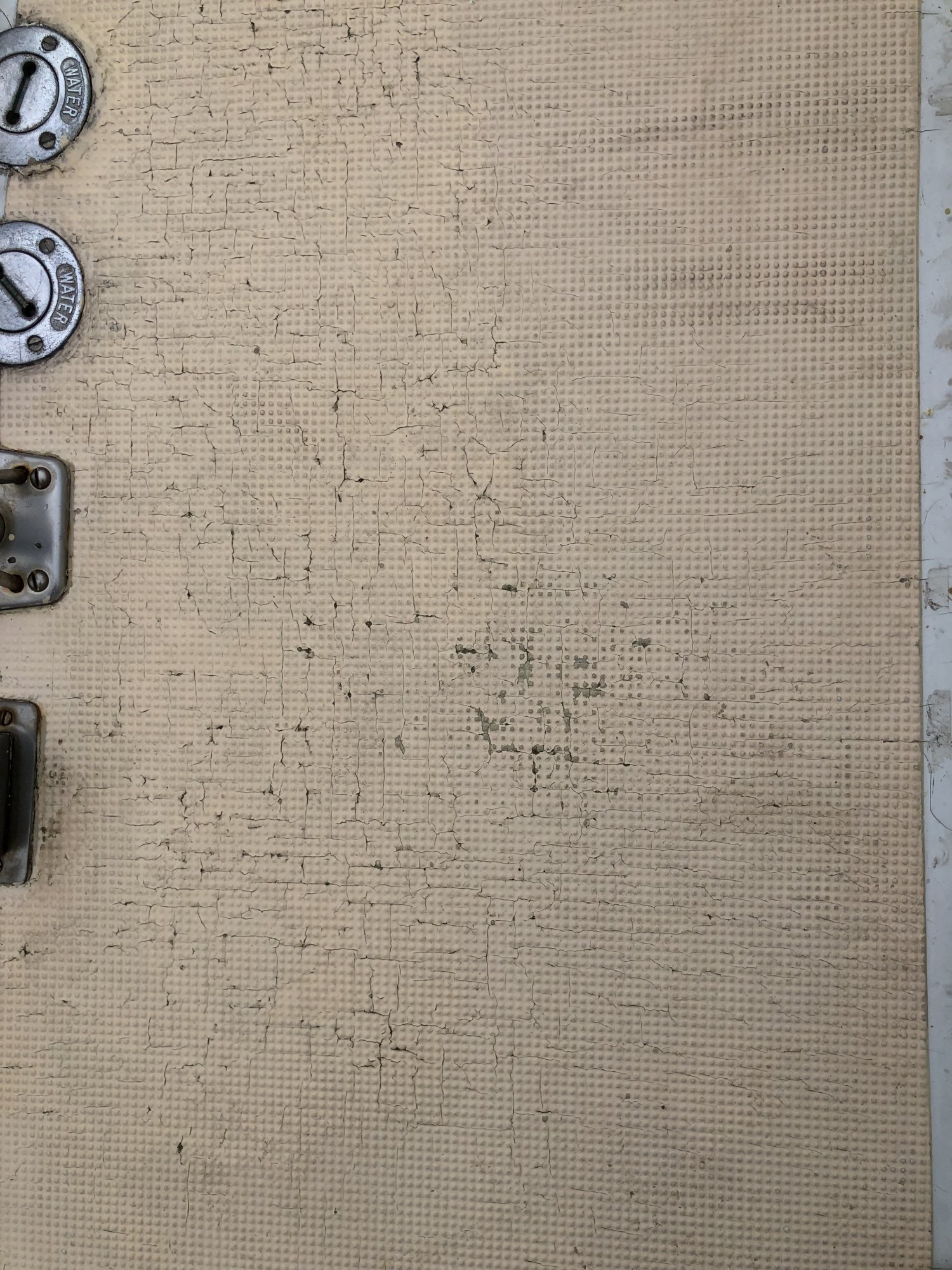

I’d like to correct my initial post. On further examination Mirage has a lot more than a few spider cracks. Here’s what I’m dealing with:
I can’t see gouging out and filling every crack. That would take forever. What do you advise?

Do you have something more than gelcoat flexing going on in that area of the deck?
You have 4 potential thru deck fittings that could be letting water in beneath the top deck into the core. Creating a "spongy" feeling deck. I would first try to affirm that the core in that area is not compromised.

Yes, those cracks could be caused by water in the core freezing and expanding. Get/borrow a moisture meter to see of the core has high moisture content.

Moisture content was checked out by the surveyor last October. He found nothing significant. There are many areas like this around the deck, not just one patch. It looks more like general wear and tear.

You may have to sand the deck flat, Fairing compound to smooth, and then paint with a "non" skid paint or a paint and additive product.
I found the BoatWorksToday - Youtube site to be helpful in showing solutions for fiberglass repairs.

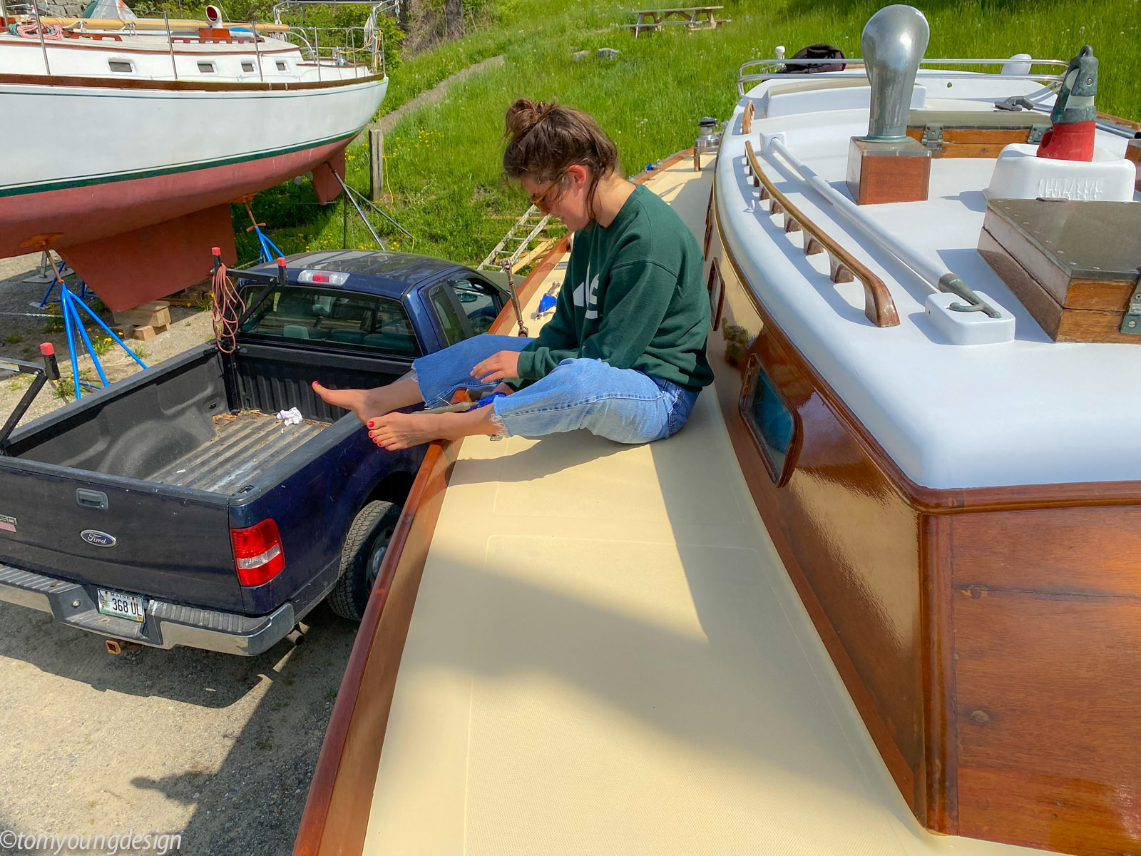

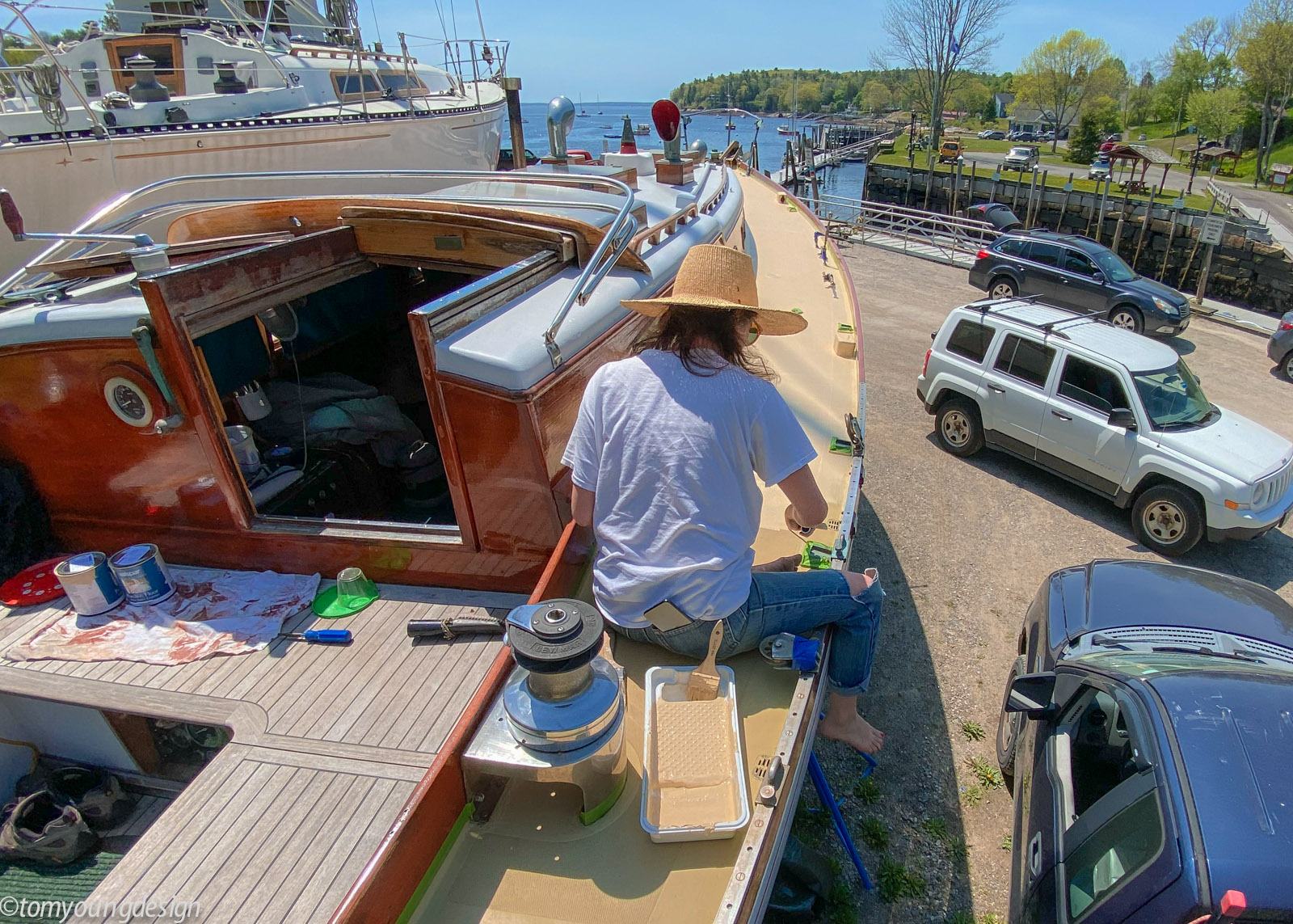

Yes, you can. :)
No 'slapping' though. Roll and tip.

That was Valspar Acrylic enamel (floor and deck I think). I've used Rustoleum acrylic enamel also and was pleased. That's a base and can be used for several shades of 'buff' or whatever.
Acrylic holds up better than oil for me, anywhere it gets a lot of abrasion like on the deck or the dinghy interior, house top.
Plus it doesn't flake like oil, I think, because it is tougher and goes on thinner.
That is also the reason it doesn't cover as well as oil and may need another coat over oil, if you have a lot of contrast to hide. Figure 2 at least. AND, it takes longer to cure than oil so allow a couple days of drying and at least that long before using.
It's one part but I think I got about 5 seasons out of the last coating of acrylic. I'm happy with that. It's far from perfect but I'm happy to be using the same nonskid pattern that was cast in the decks 60 years ago. If you want 'yacht quality', you should remove everything, sand it down, fill, spray two part, inside a building.
My daughter and I can paint these decks in a few hours. We should have done another coat this last time as it's a little thin. Taping is as big a job as painting. But it'll serve for a few years at least.
