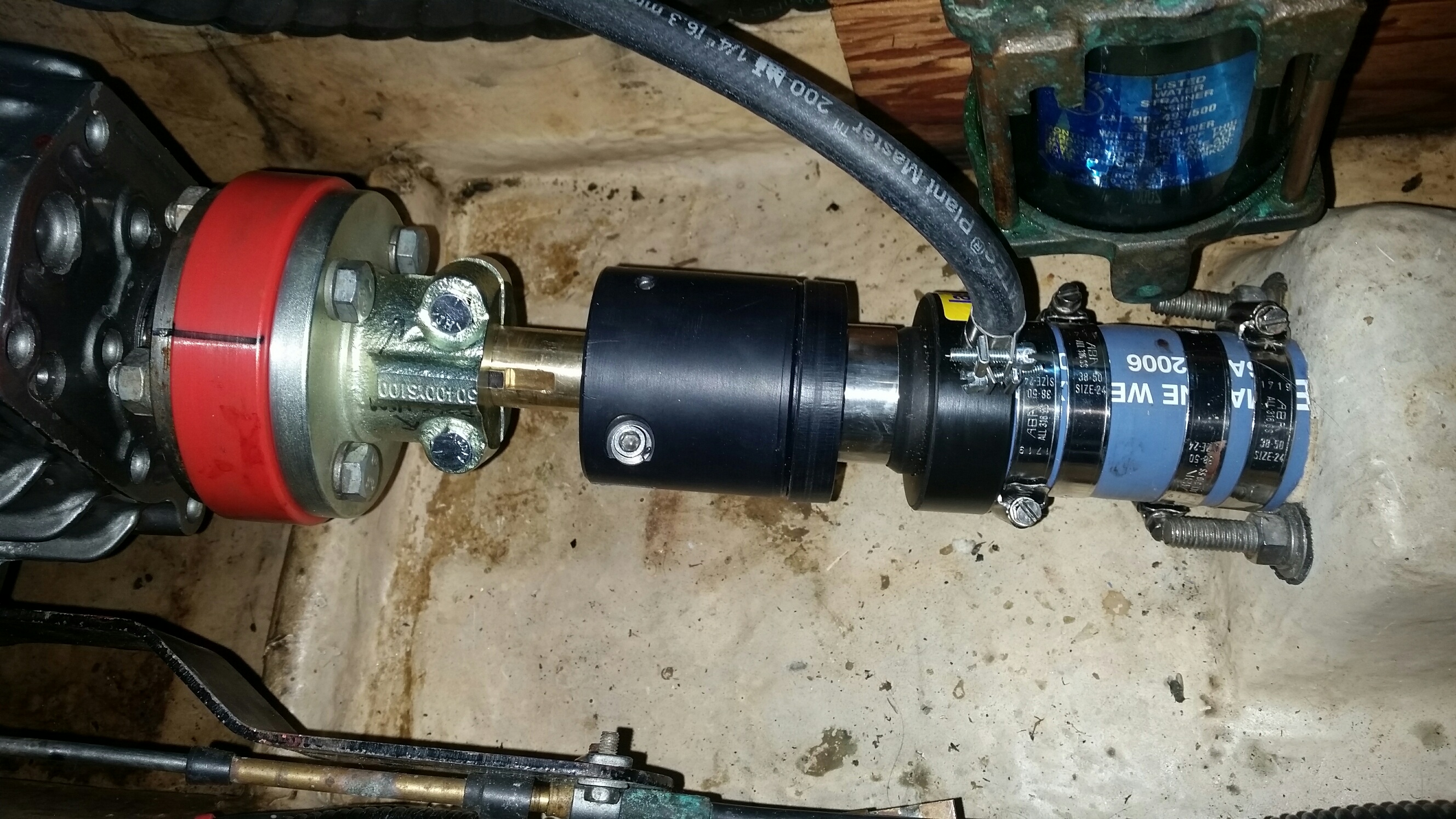

Finally got my new coupling fitted and faced, installed and the LasDrop dripless seal installed as well. Not much shaft to work with. Not enough left to reinstall the ground strap that rode on the shaft. What is still exposed has a groove for the shaft key. Not a smooth surface to ride on. I will have to add a ground wire from the trans flange to the coupling to bridge the Drivesaver.
Then I can put my rudder back on. That much closer to getting in the water.

I fastened it to the siphon break at the top of the mixing elbow. The directions say if you stay under 20 knots it is used as a vent. If faster it has to be hooked up up to a water source.
You water source will be the water you sail in, Silt and all. It is the reverse thrust that compresses your spring.
Also remember the high point of your vent MUST be above the water line of your full cargo loaded boat.
Otherwise it will back flow into your open engine valve.
