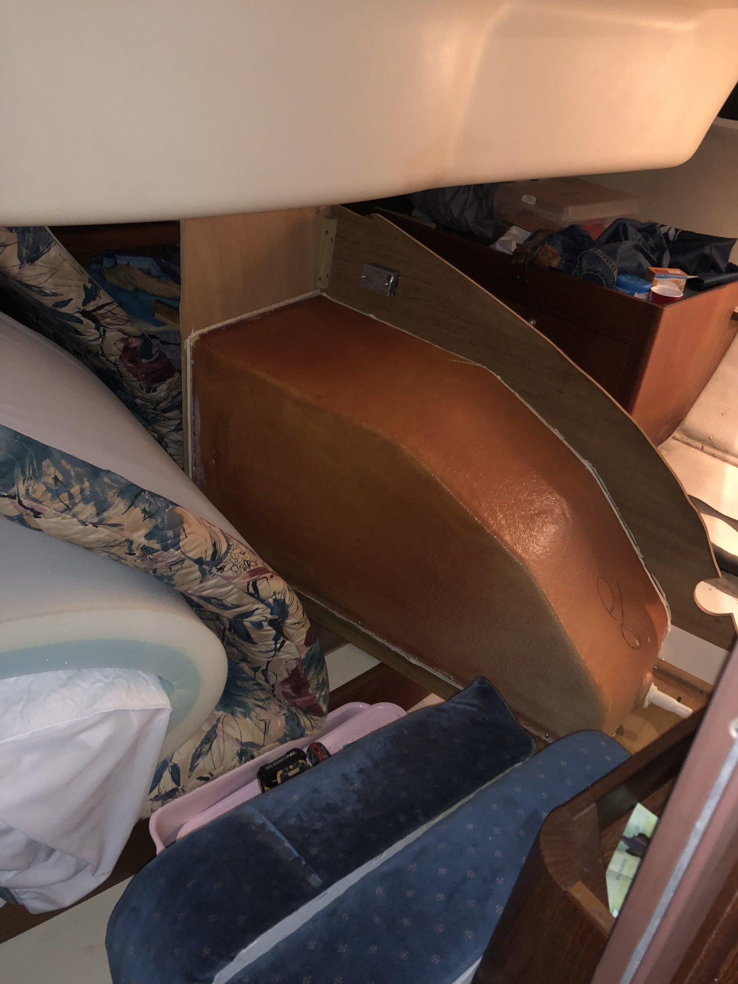

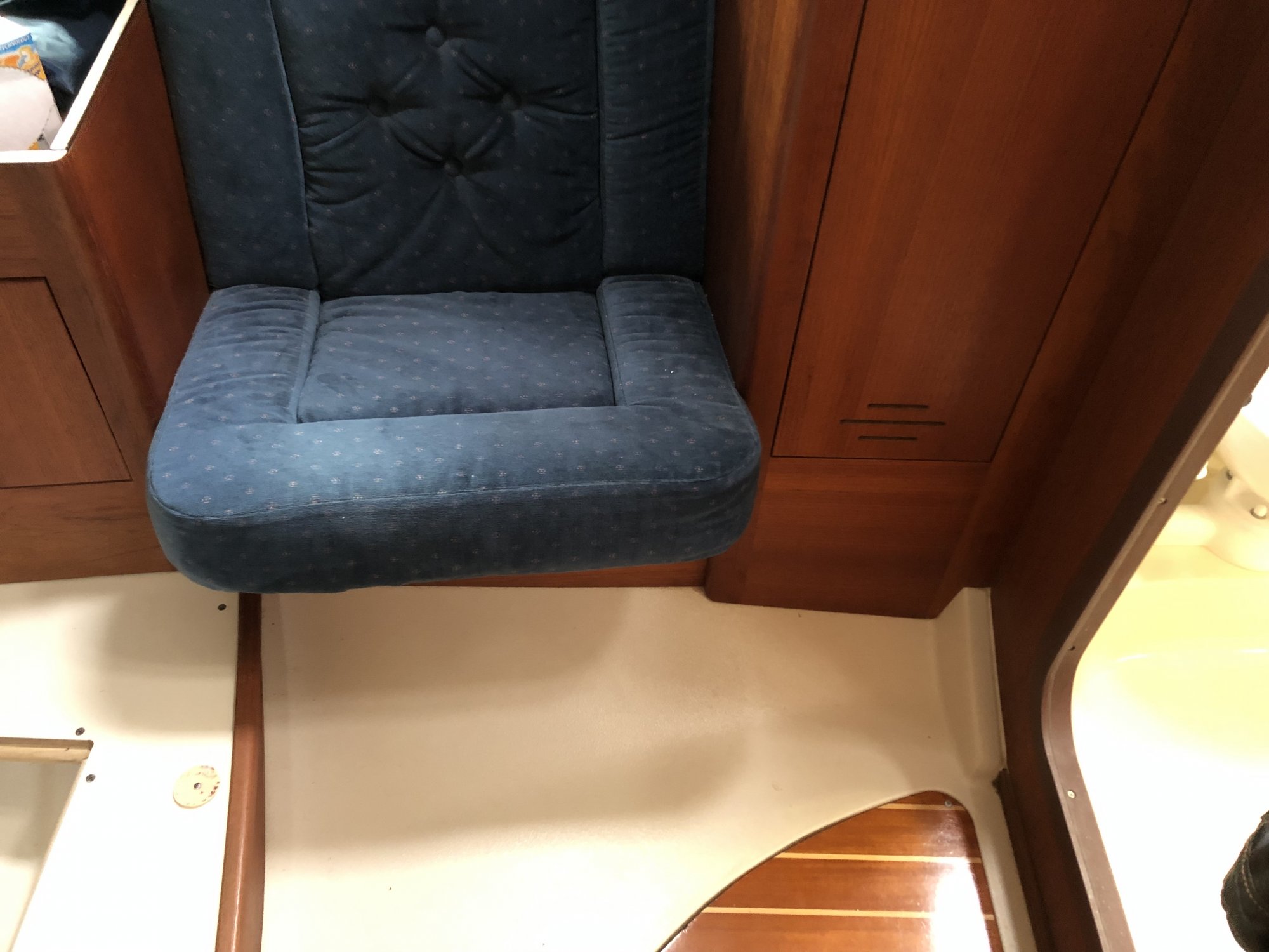

Update
so as it turns out you need to take apart the port side of the aft cabin to access the hose. Due to the bend it makes between the head and cabin, the old hose would pull through ( and I don’t think pulling the new would have gone either.
still working on getting this out but thought I would update in case someone else tries this

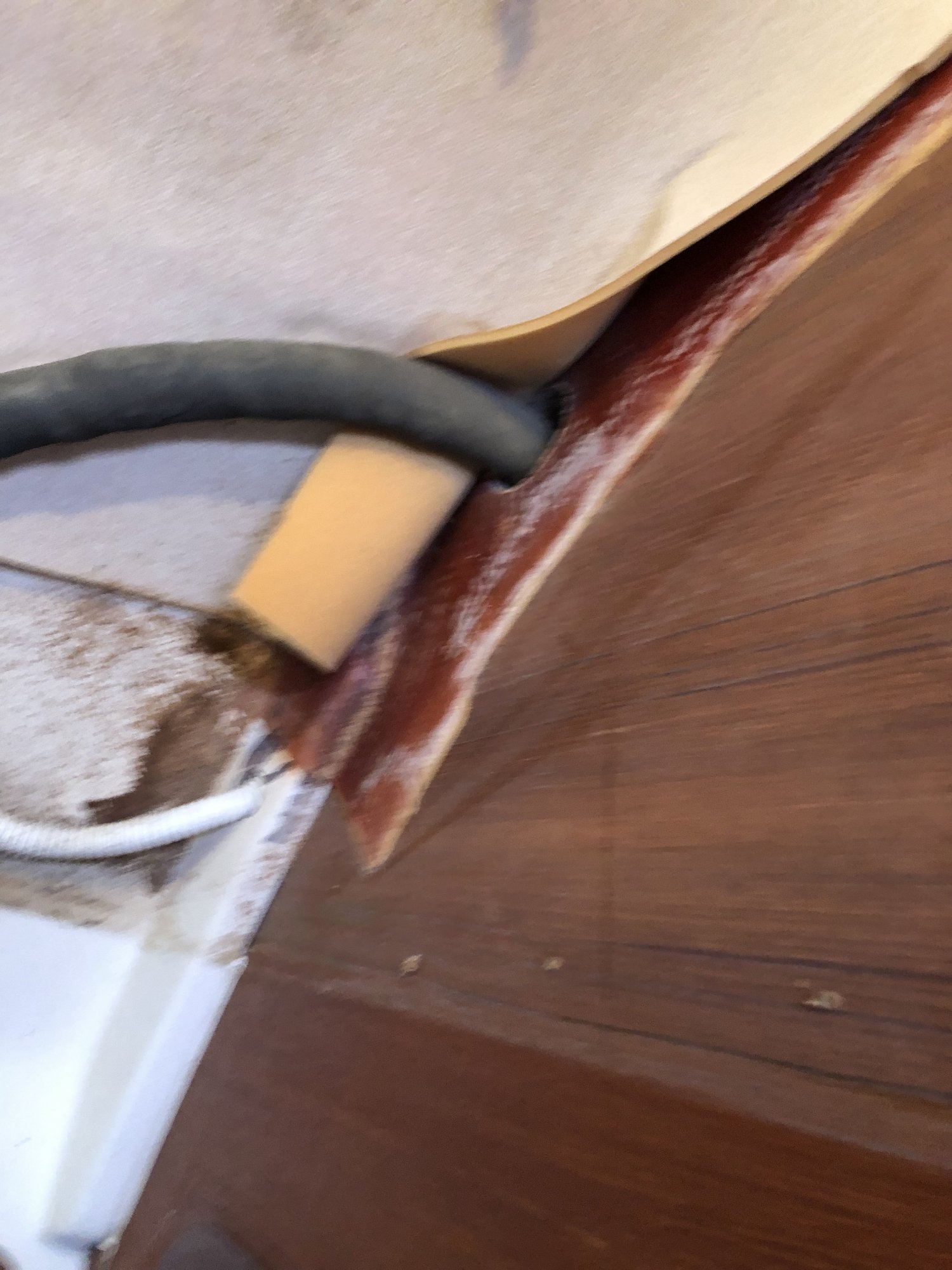

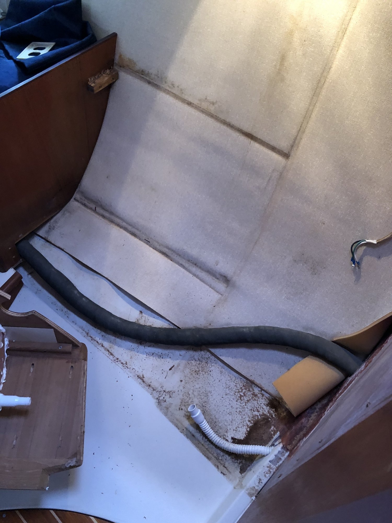

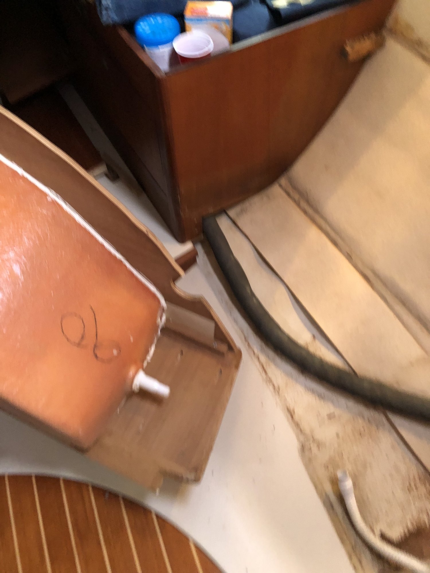

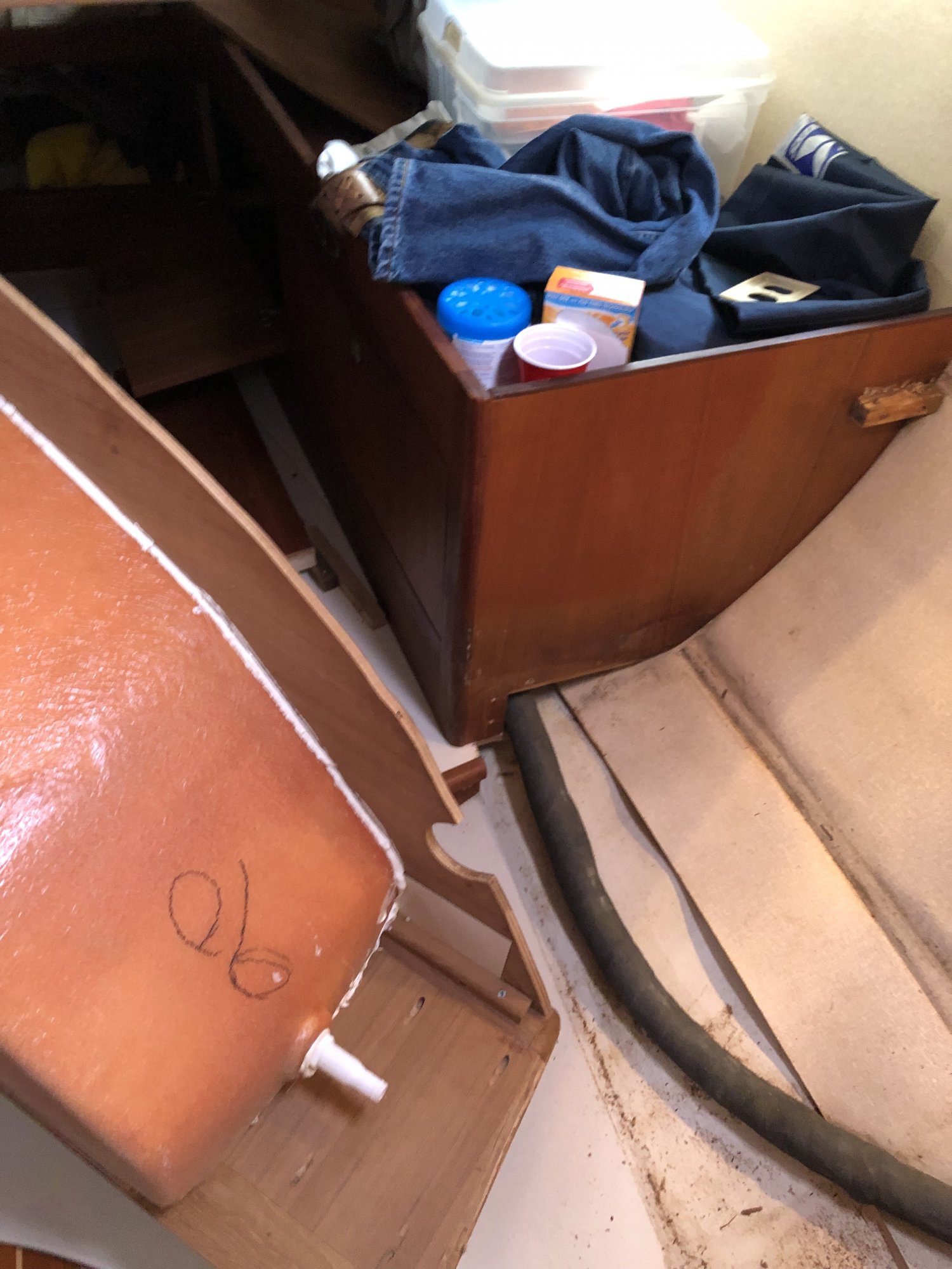

Day three update
Well I have taken apart the aft wet locker. Taken the chair next to it our. Trying to get the cabinets taken apart but not having much luck finding how they are attached. Still have not gotten this hose out. What a nightmare. Being a live aboard I have seriously run out of space and the high winds and rain last couple days have eliminated using the docks to stope anything.

Update
Well after 4 days of removing items along with cutting a larger hole, the old hose is out and the new one is in. The new toilet is in and working after a slight issue ( no valve from the factory ) and the business end looks to be done. I am working on the vent hose but will be leaving the pump out hose as the only access to back of the tank so far is to cut out a bunch of fibreglass and redo it.
