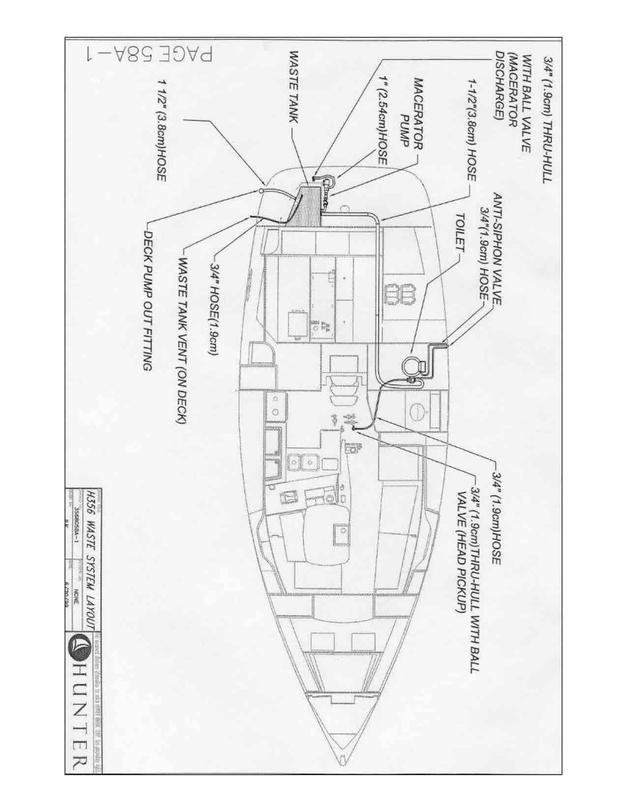

part two… according to the manual it looks like it runs behind the chair, closet locker and cabinets. If they need to come out does anyone have experience as to how? Can’t seem to find any attachment points to them except for the chair.

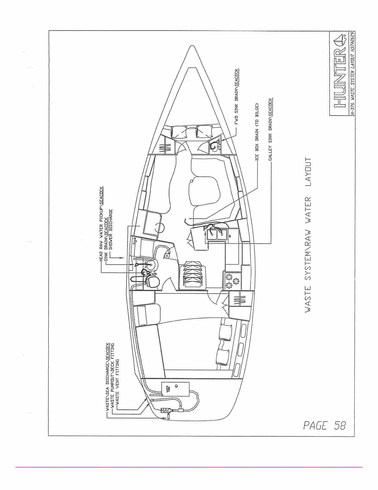

the diagram for the 356 is laid out different Thant the 376. On the 376 it runs on the outside against the hull
oops , my bad. I needed more coffee.:banghead:

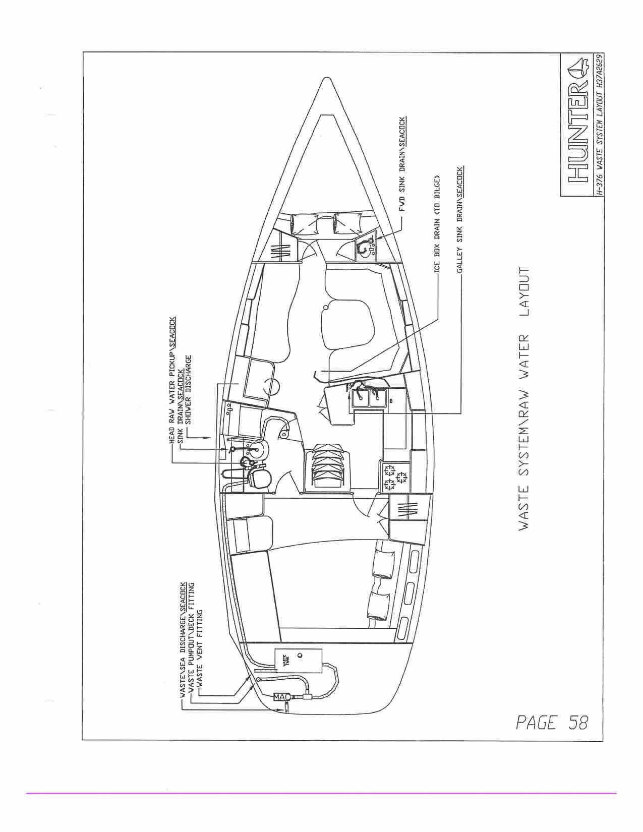

Here is your H376 waste system layout.
4- very likely one of the problems is in fact the vent and if you continually flush water through it will quickly slow down. Usually meaning the air in the tank has no place to go as the vent is plugged someplace.
There are 2 vents that are needed for full function.
1) The Hold tank vent [Waste Vent Fitting in diagram]
2) The Toilet pump vent [shown and a loop behind the head]
One way to check the Hold Tank vent is to open the Deck pump out fitting to allow Air in the Hold Tank.
Then open your macerator and pump out [per Law rules]
Does you Hold Tank level transmitter work? [also needed per Law]
Jim...

thanks for the input. You can see in the diagram that it runs down the port side. This is where I am having issues as in the diagram it goes through the wall ( no problem ) then under a locker, a built in char, and then long cabinets. Just can’t seem to figure out how to get the cabinets out.
