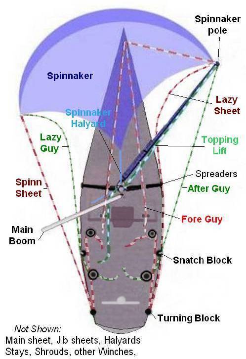

So let me understand better.,
The idea is to launch the kite behind the main, or closer to the mast to cover the sail as you raise it then pull the pole back after its up to fill it? no change in course.
OR, more like,
clip the turtle to the lifeline, then steer the boat downwind to cover the spinnaker launch, and keeping leading edge out of the wind, working guy very slack, then pulling the guy to open the sail? again, no change in course?
I figured you would want to steer the boat to cover, then head up, to fill vs pulling the guy (lazy sheet) ?
FYI:
http://www.teamthunder.org/ThndrBot/x-spin_rigging.jpg
Nov 8, 2010
11,386
Re: I need a tutorial video on how to use a symetrical spinn
Mr Bill,
good questions!
First your turn down to your course, or slightly below. The kite is in it's bag on the leeward rail and rigged. When ready, the guy is in the jaw of the pole, and the windward clew is run out to the pole. This is called 'pre-feeding the guy'. The pole often moves a few feet to windward during the pulling of the guy, but it will blow back during the hoist. Here we are in 20 knots.
The kite is quickly hoisted, but it's behind both the main and the jib. Even in the 20 knots, its just wiggles in the back-breeze.
We bring back the pole, and it starts to fill. Furl the jib, and and we're out of there!
