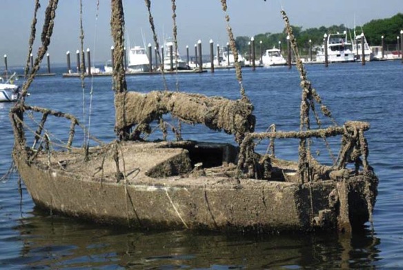

I was reading Webb Chiles' blog about his 6th circumnavigation currently in progress aboard his Moore 24 GANNET and came across this photo. Apparently it was reported missing from its mooring and found a couple of years later by a diver inspecting the mooring ball and tackle.
j24.jpg:yikes:

That’ll buff right out.
The Craigslist ad will read “environmentally friendly racer / cruiser with a bottom as well kept and smooth as the topsides”.

Sank several years ago in NYC City Island. Pulled from the bottom the next year.
J24s like to sink.

A couple of hours with a pressure washer and she'll clean right up

Yeah, she's a little dirty and the sailcover looks like it needs to be replaced. I couldn't tell from the picture, does she have roller furling? She floats pretty high for all the extra weight. Probably could sell her to Hollywood or Disney for a lot more than you could get on Craigslist.

I'm unfamiliar with the J24 particulars. What makes them more susceptible to sinking than other boats of similar size/design?

Older boats had only a partial bulkhead between the aft lockers and the cabin - did not run all the way up to the deck. When the boat heeled to extremes or was held down by crew in the water trying to hang on or get back aboard, the locker top would go over center and flop open allowing water to enter that locker. Once that filled and flowed over the partial bulkhead, the cabin would begin to fill. From there it was a matter of time until it sank. J Boats changed that bulkhead along the way so the locker was a sealed compartment and offered a retrofit kit for the older boats. We always used a snap hook on the hasps for those lockers to prevent them from opening that way.

First up, the J/24 has an Angle of Vanishing Stability of less than 90 degrees. This is almost unheard of in modern yacht design. AVS is the angle of heel that the boat will last turn upright. More than this the boat will want to turn down. In most boats, this angle is between 100 and 130. On a J/24 the mast does not even have to be in the water before it turns!
The boat's cockpit and companionway design are very susceptible to downflooding at moderate angles; water entering the boat proper when heeled. This compounds #1
The cockpit lockers do not positively latch unless locked, a dumb builder trick shared by lots of small boats. They will flood the boat if opened.
The boats are race aggressively under spinnaker, which compounds the likelihood of wipe-outs.

It looks like the owner left the hatch open during a couple of storms, in the picture. Left her on her mooring and was unable to get back for a while. On the other hand, the hatch is open because the recovery people needed to empty her out. Why did she sink from the locker bulkhead while on the mooring? Is there a point at which she just keeps filling once there's a certain amount of water in her? Or, am I mistaken in assuming she was moored when she sank?
