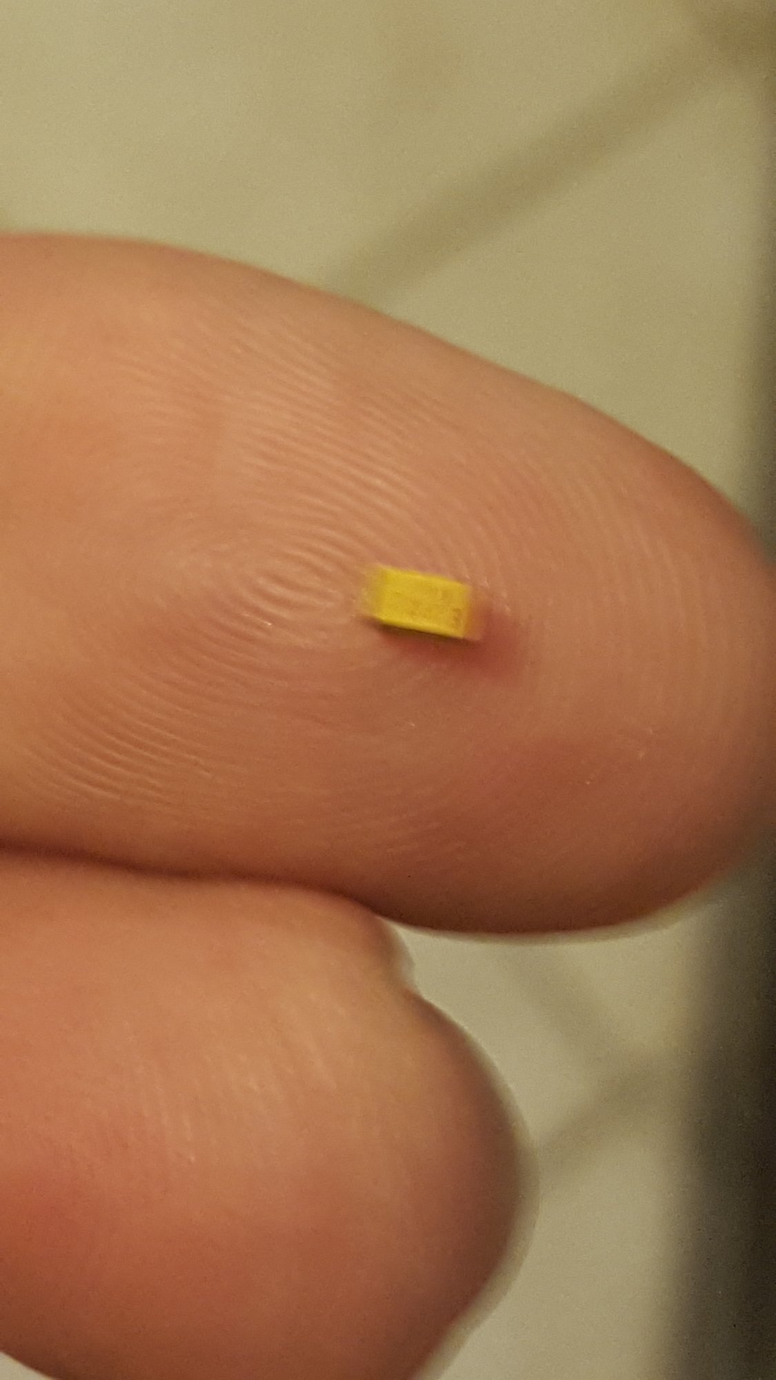

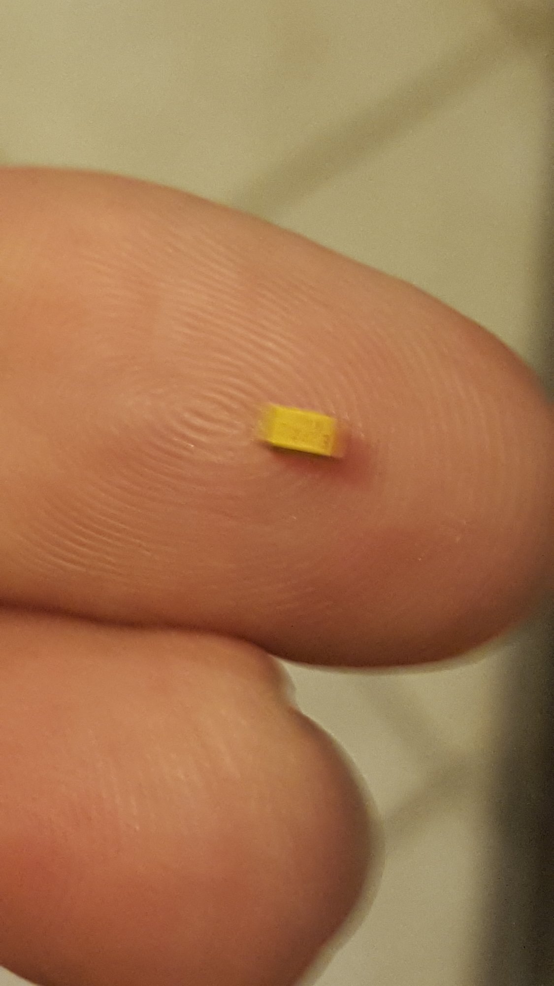

I'm sure it's fixable. I had a similar/same unit that the compass began drifting significantly on. I learned that the factory had installed a capacitor in the control head backwards. Raymarine has a TSB on their website about it. I removed and resoldered that tiny part and it worked great after that.
