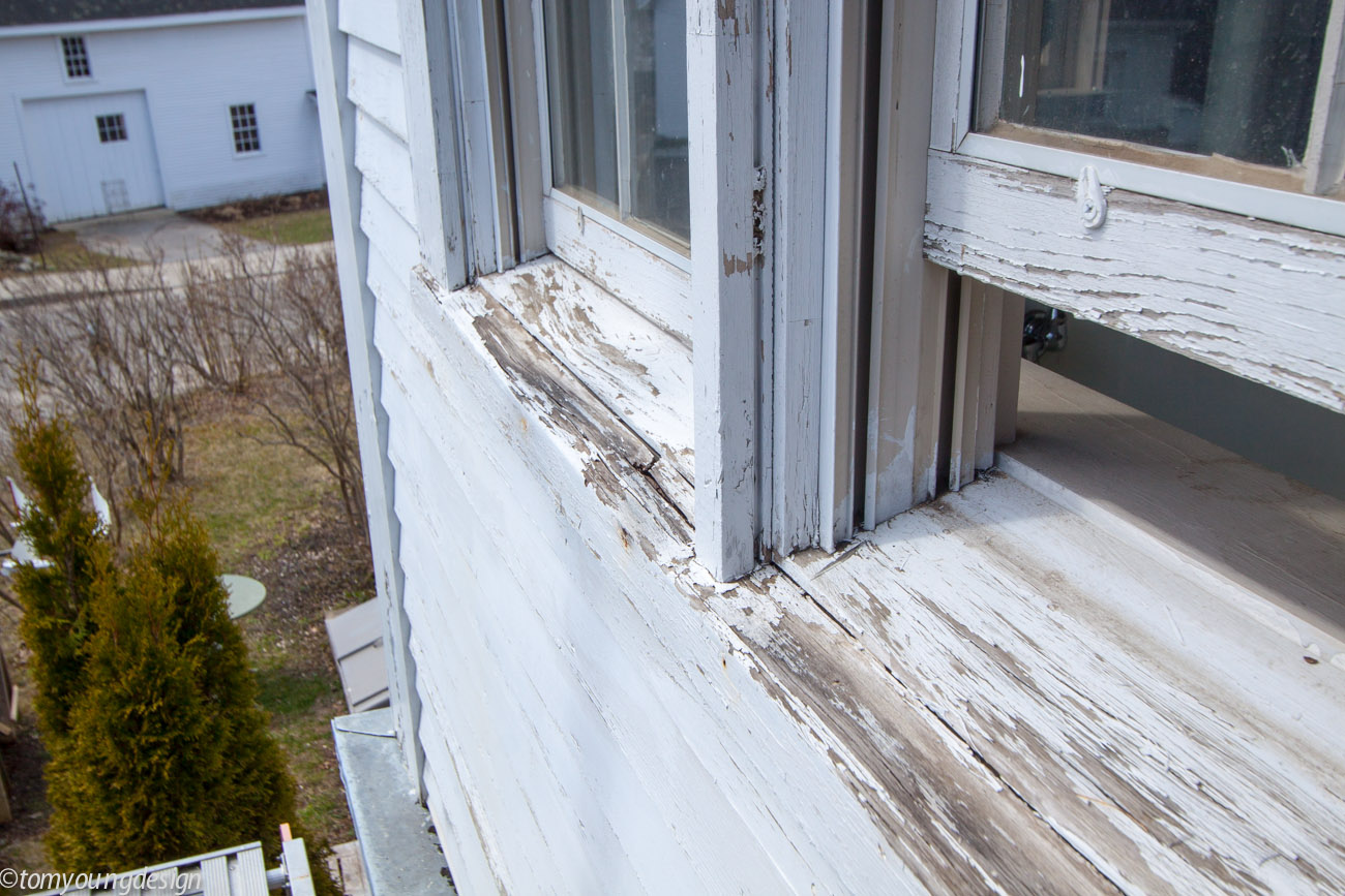

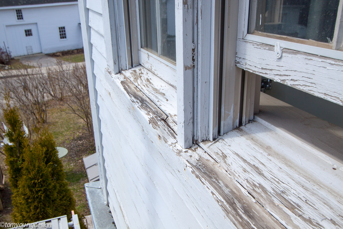

Caring for buildings old and 'new', rot is my life.
20 year old 'new' windows that were not maintained.

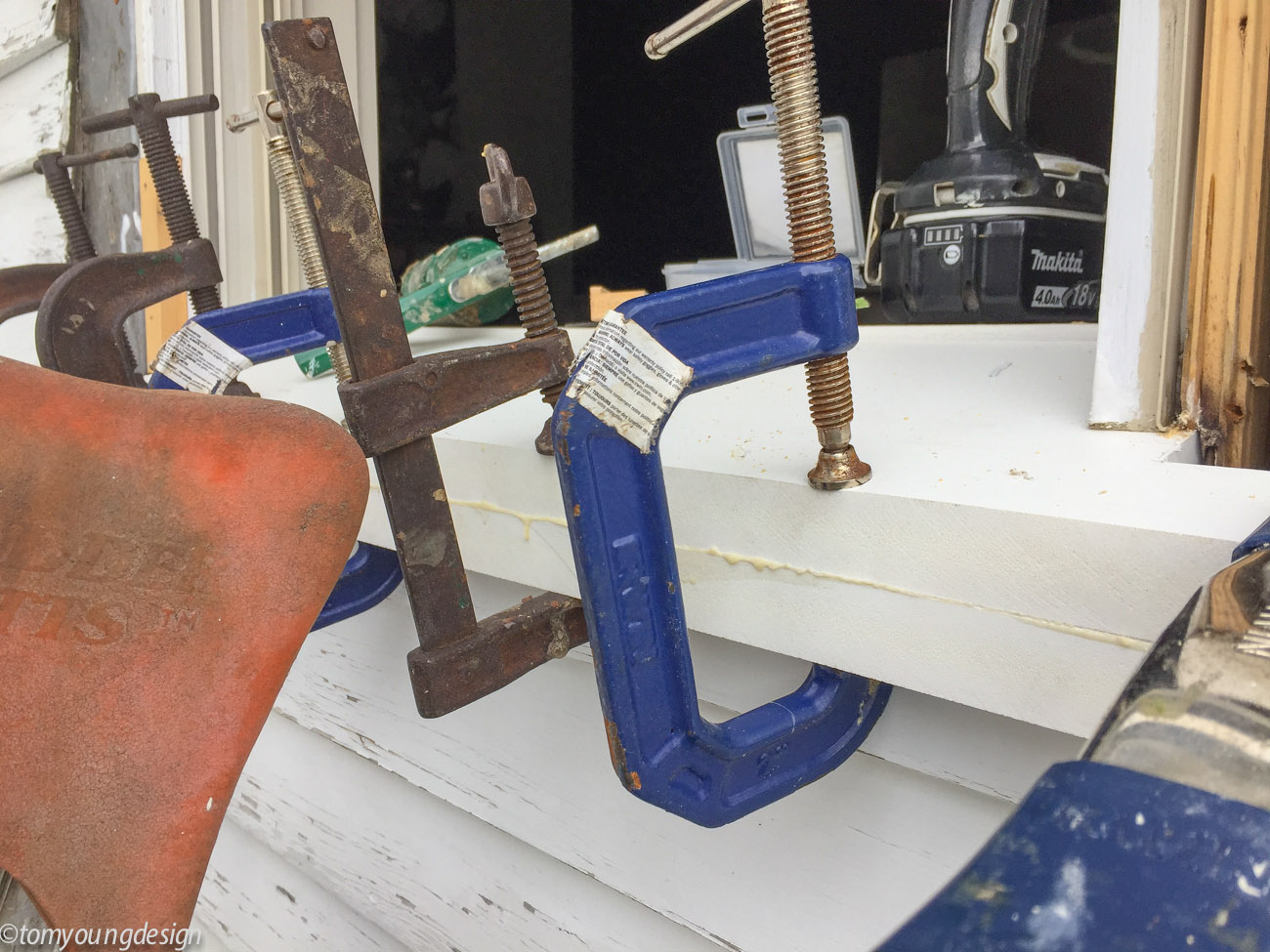

I love composite material, especially for areas of high abuse from the elements.
A coat of lumpy paint to make it look 'old', and Bobs your uncle.
