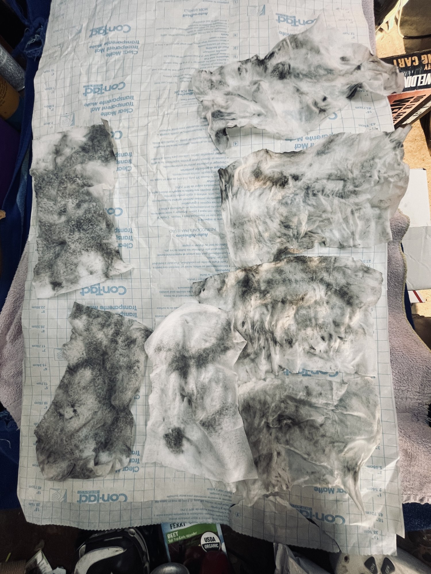

I tried the alcohol and it worked pretty well, it removed lots of old black plastic. It actually removed almost completely the small ribs on the side of the radio. My alcohol wipes are 4x3 inch. This was a 90% less sticky than what it was. I finished it off with a little odorless mineral spirits and that made it a little less sticky. Overall I would say it was a success. The attached photos are the wipes I used.
