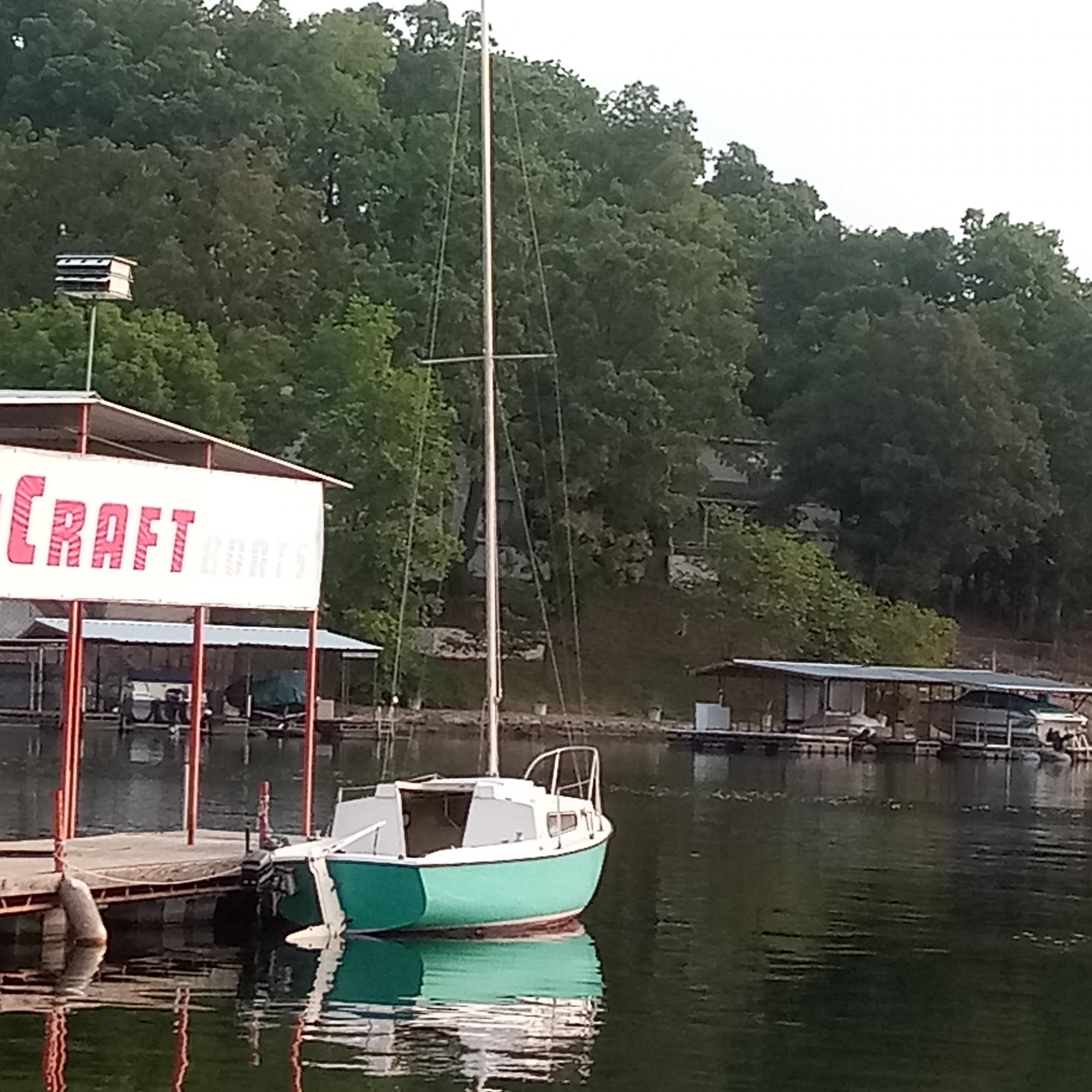

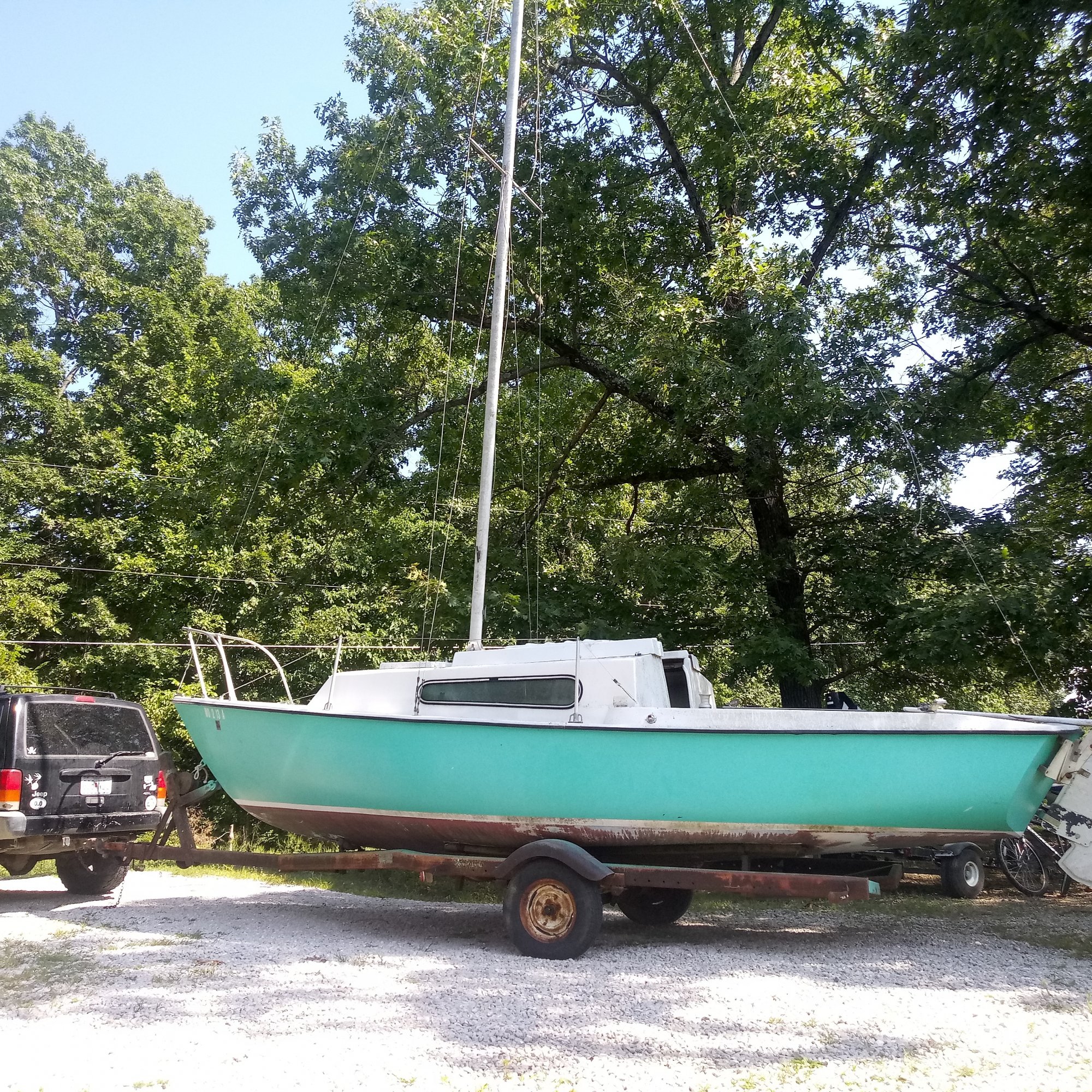

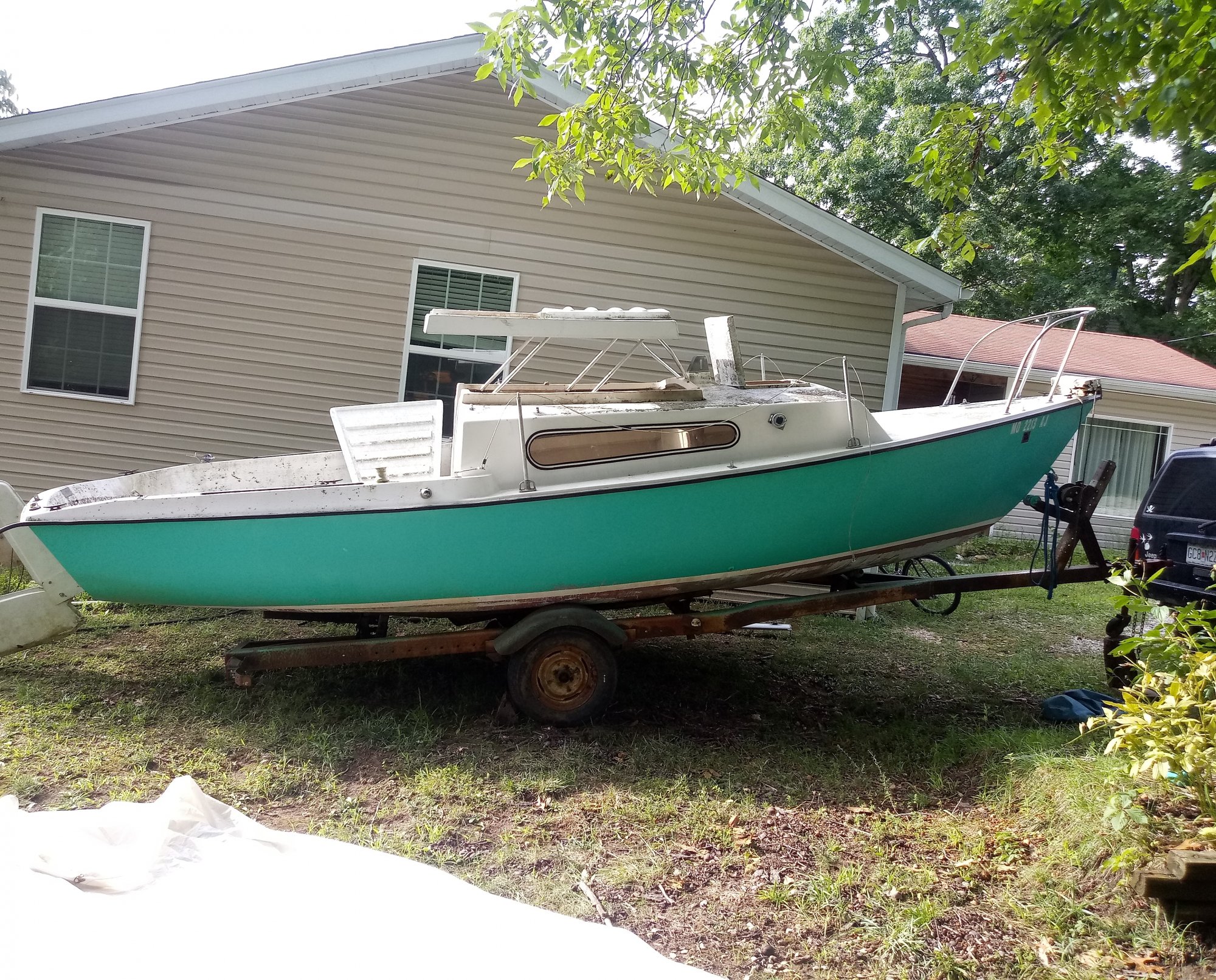

I have a knack for junk boats though. I will post pics of the progress. I've already fixed a hole where the bunk broke and shoved a bracket through the bottom, and cut out most of the interior, removed disintegrating foam and dead possums. The front deck is pretty soft, so I shot it full of foam ( poor man's injectadeck).
She will motivate with a 9.8 merc and a set of brown Hobie 16 sails that I had stashed back and measure out about right.

I am in no way saying it's the correct or proper repair, but I've gotten by doing this on a couple other cheap old boats where the deck is soft and floppy. How I go about it is by wedging the inner layer back up where it should be with so 2x4's or whatever scrap lumber you have laying around. I take a 1/4" drill bit and perforate the inner layer ofglass randomly, but roughly every 10" or so. Drilling into the void where the balsa core originally was. I then slide the tube in a couple inches and try for atleast a couple second shot every 90 degrees. Work from the bow back so it doesn't ooze on you.
Loctite make a foam that is much denser and more consistent than store brands or "great stuff".
Let it set up over night, kick out the supports and try it.
I ended up leaving one support in this one, but it was very far gone. It no longer flops around as you walk across it and barely flexes at all. I did this to a 22 oday awhile back and got by with now supports. I've done a couple old runabouts this way too.
It's not the right way, but i have no interest in recoring a 40 year old boat deck on a $1000 boat in good shape.

The boat was given with titles for boat and trailer. They are signed, dated, priced at $100 each with corresponding bill of sale to match. Missouri is a stickler in titles, and so am I. So no, it isn't currently registered. The pictures are from the trial run.

Did you take the bulkhead(s) out?
no. the chainplates attatch to the bulkheads and they are still solid.
The boat sat bow up and leaning to the starboard on the trailer, so most of the rot I cut out was in that side. It was originally the galley, storage and seating. all 3/8 ply tabbed on one side..... not impressive construction.
I will probably end up glassing in a stringer and maybe making a flat spot/seat down that side just for rigidity.
These little boats are so crudely built. I am always amazed how long they hold up.

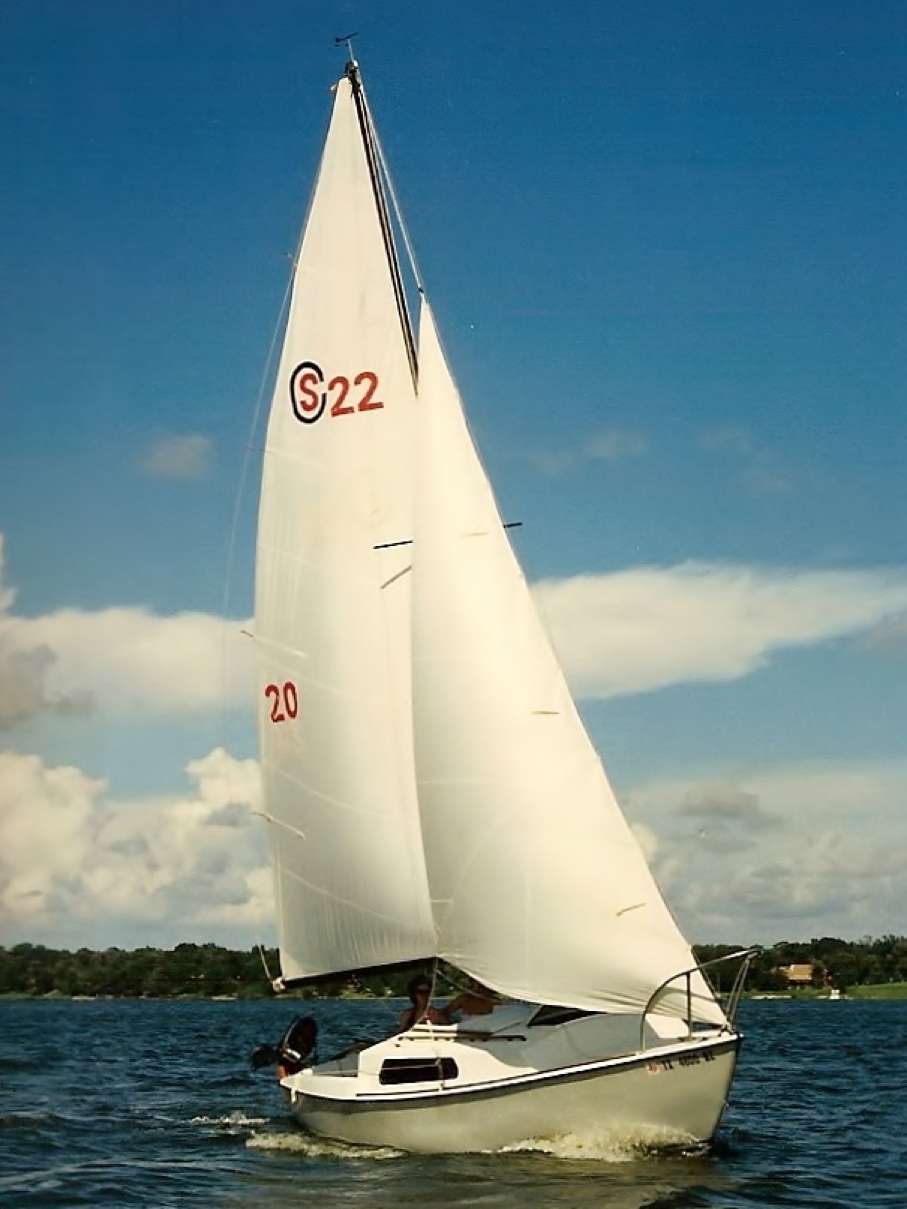

766
Hunter 340 Baytown TX
Another old photo of my SC22, she’s sailing fast, but you can see the dimple in the hull side where the chain plates attach. Reinforce it if you’re going to keep the boat for a while.
