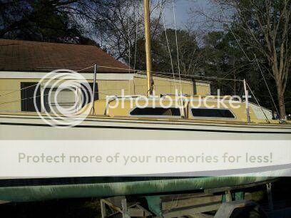

Thanks for all the support guys... perhaps I'm making a mountain out of a mole hill. As far as why I need it off the trailer, the trailer itself needs a bit of work as well and as you can see (I hope) in this as found photo the keel itself is 75% out of view the way the trailer has been setup.
Thanks Again
