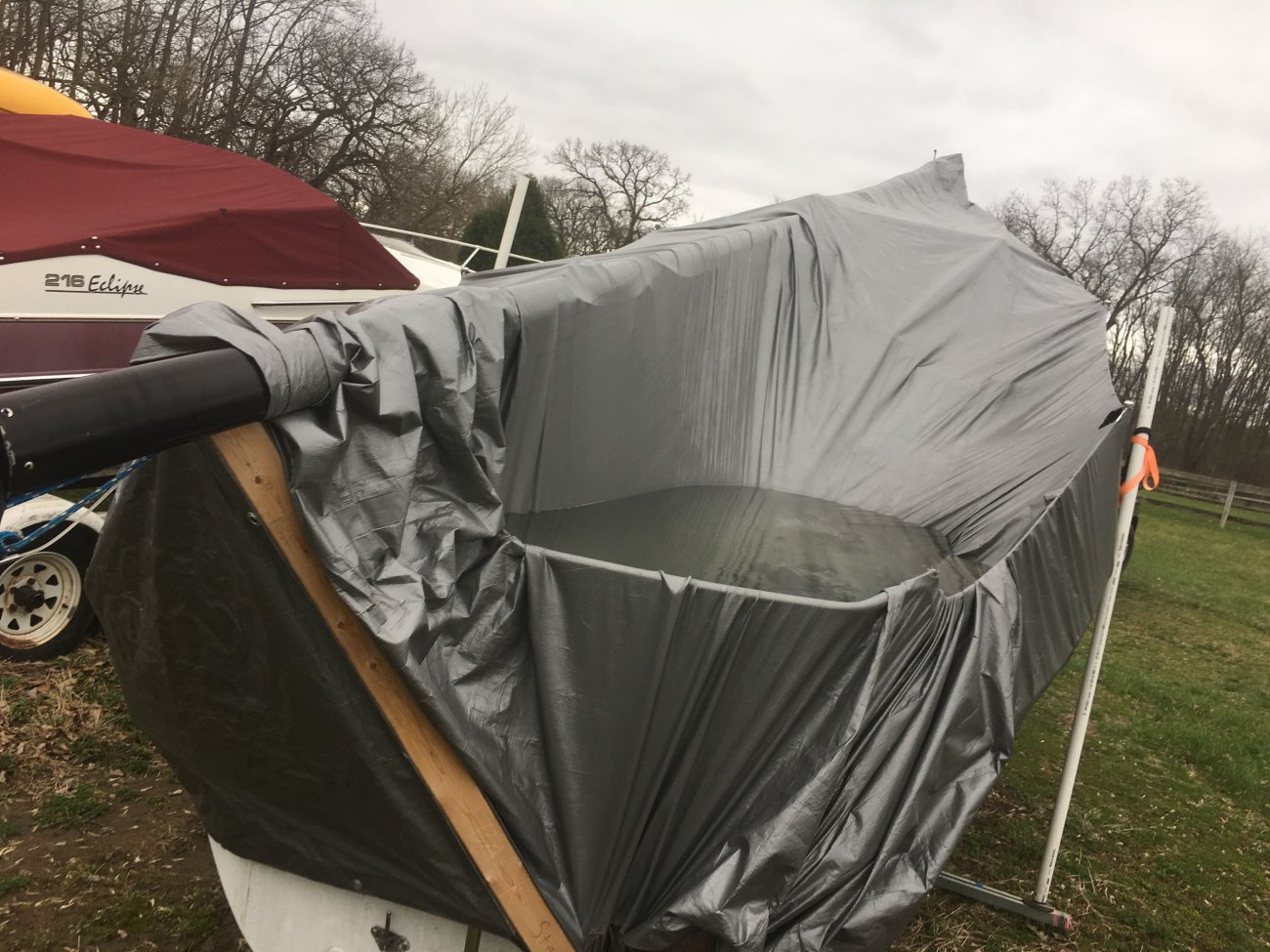

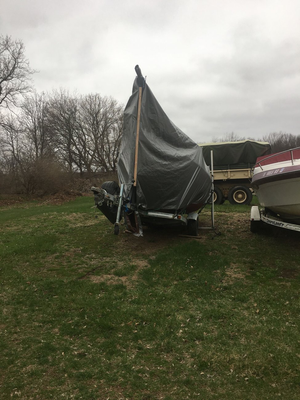

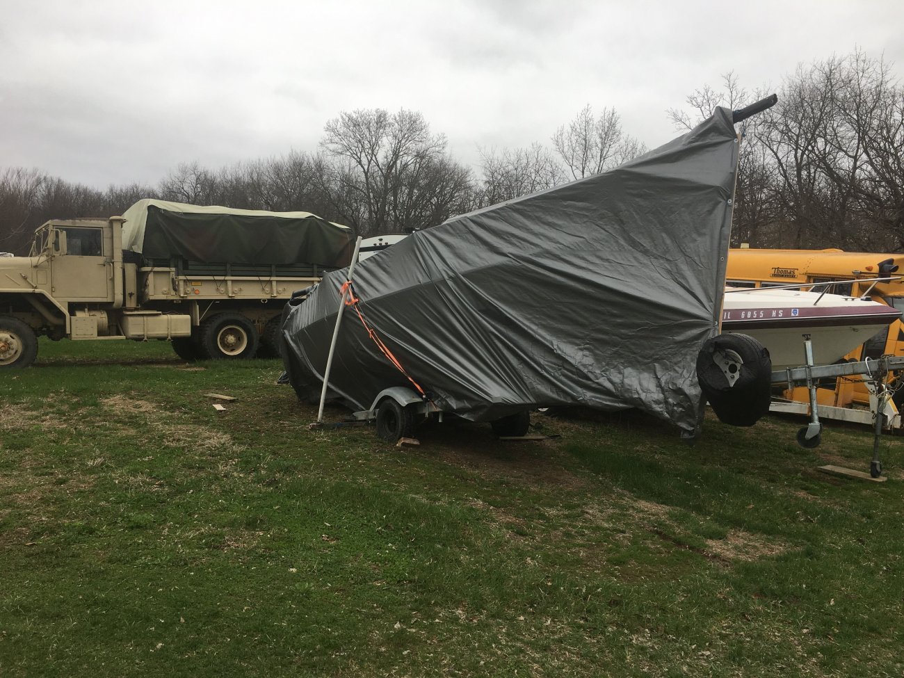

I went to go check on one of my boats today and found it sticking up in the air!
The property owner knew that it was in the air but but couldn't be bothered to send me a text. She thought that I was mad at her because I "didn't secure my boat properly". I moved the boat off of her property. I tried pushing the tongue down, then hanging from it, then I tried pulling it down with my truck but the ratchet strap broke. In the end I cut the caribeaner I had on the lifeline. After a few minutes of gushing water I was able to pull the tongue down. The swim ladder, transom and tires had sunk into the mud but thankfully I had no issues pulling it out. Other than a bent license plate there was zero damage

I would have suspected a prankster filled the spare tire with helium:yikes: So, was the cockpit filled with water?

Yep, snow and ice that collects and doesn't run off. Remember water weighs 64 lbs per cubic foot. So, maybe there is 15 cubic feet (3 ft x 5 ft x1), that's 960 lbs sitting on the aft end of the boat.
One of the ways boats sink at the dock is for the cockpit drains to get plug with debris with the cockpit filling with water, eventually the transom goes underwater and the boat goes down.

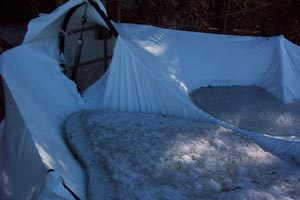

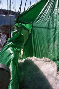

To tarp or not to tarp that IS the question.
One might think that water would drain off or flap off of a loose tarp as the wind blows, but snow and freezing temperatures create a whole new ball game. We have chipped ice during freezing weather, bailed ponds of water off the tarp, or purchased replacements for tarps that have succumbed to winter weather. We even tried making small slits in the places where water might dam......didn't work either. We have tried supporting the tarps with ropes around the hull and over the mast, a framework made of 2 X 2 wood, and no tarp. Choice #3 was the only sure way to prevent ice build up on a tarp. Once ice was so heavy that a stanchion was pulled out of the deck!

That must have been a shock to see. Glad there wasn't any damage to the boat. Good thing the rudder was off.
The first winter I had my O'day 25 I dropped the mast and tarped it much like you did. Bent a stanchion and couldn't prevent the water from puddling. The next year I didn't tarp and the freeze/thaw cycle cracked the cockpit drain fitting causing a leak that almost flooded the cabin.
What I eventually learned was a tarp would work well but only if you put it boom height and dropped it to the toe rail, not put it over the life lines/pulpits. That means cutting the tarp and Gorilla tape.
Again, glad the boat survived with no damage.
