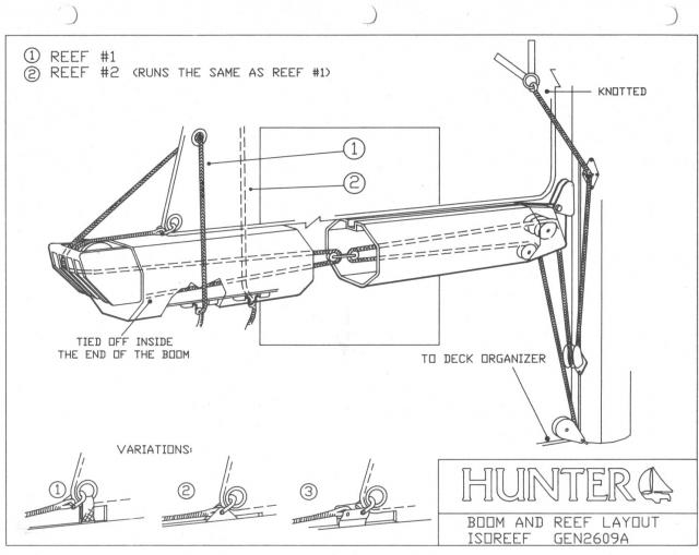

Do you have a digital camera or cell phone that takes good pictures? If so, take and post pictures of the gear at each end of the boom and you'll get much better (and conflicting:) advice here. Many production boats have less than optimum setups and you may be able to easily improve it. A scan of the manual would also help.

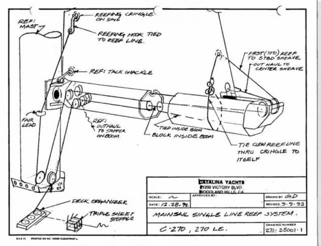

This is a diagram of jiffy reefing typical of Catalinas, it'll give you a starting point, just on a daysail last Sunday I had to reef and unreef so you want it as easy as possible because we don't want to do it unless forced anyway.;) You want the line at the end of the boom to pull the cringle down and act as the "reefed outhaul" and pull back towards the end of the boom to flatten the sail. Photo shows the end result.

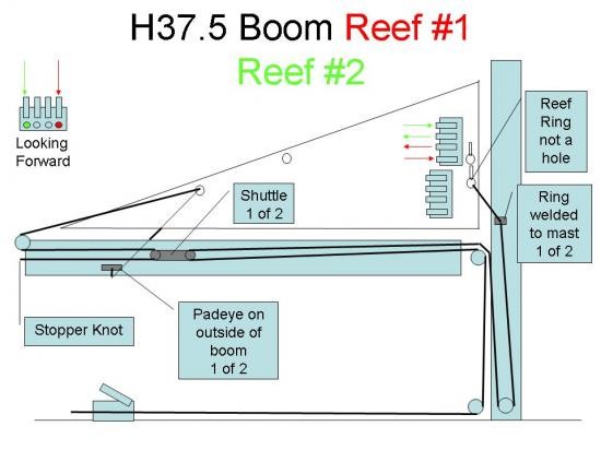

Hunters reefing setup is basically the same as the one for Catalina. The 'fly' in the ointment of this setup is the 'floating' block inside the boom. That block needs to be a roller bearing block with as little friction as possible otherwise the whole thing becomes a nightmare to get in tight enough (due to high friction) to be effective. After making this setup as friction free as possible it works like a dream.;)

then there's no block inside the boom and yeah, the reef lines will go up through the main clew cringle and terminate at the boom as the others have said. I would recommend passing the line below the boom through the eye that should be on the track on the under side of the boom The eye should be directly below or slightly aft of the clew cringle the line passed through. Tie a loop with a bowline (or similar) around the line's standing part above the boom. This will allow the line to self-tighten as well as articulate itself without twisting the gooseneck.
The angle of load from the reefing line to the main clew is important just as it is on the genoa.
After dousing the main I don't bother pulling my reefing lines through the clew and boom so that the slack is at the mast. I just coil the excess and toss it on top of the main before putting the cover on. That way it presents zero friction when hoisting. It also saves me having to pull it back through again so it doesn't create friction.

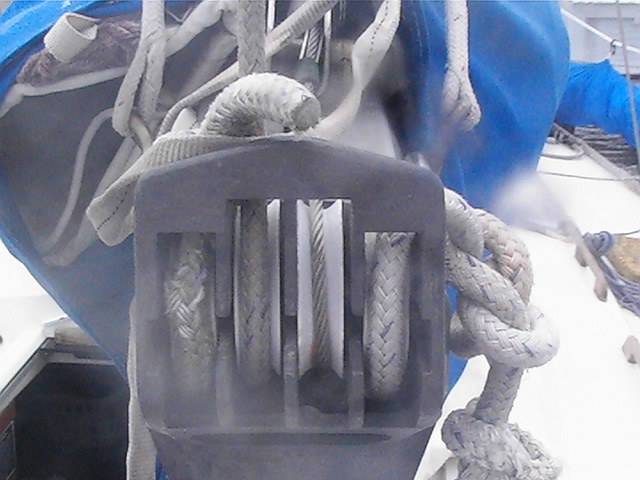

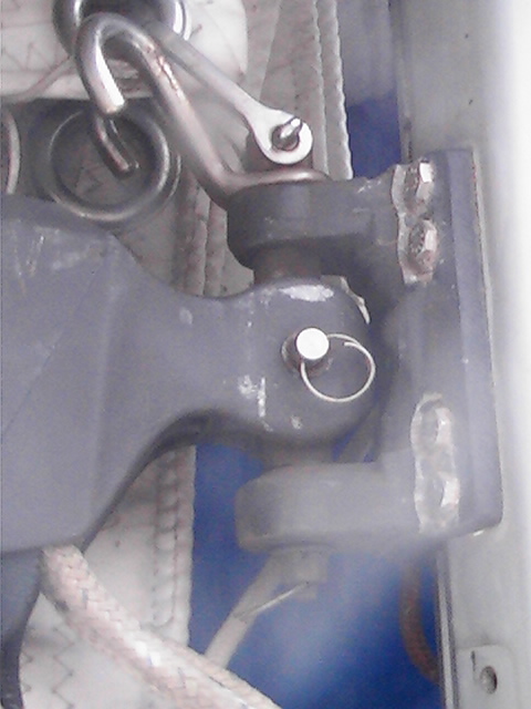

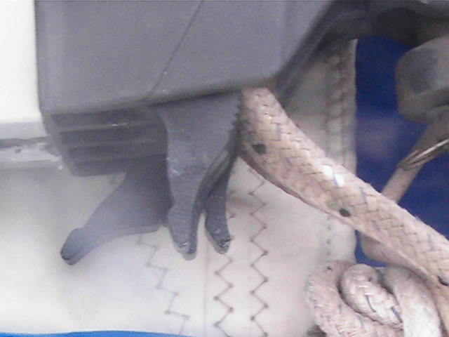

Thanks for the feed back! I took some photos this morning, but it's a H40 (1985) so I think it's all worked out.
The first photo is the end of my boom second is where it joins the mast as is the third, but it includes to hook for the tack.

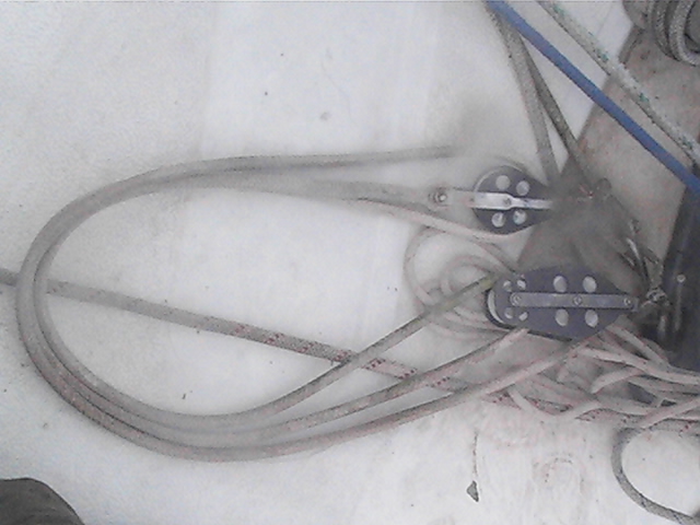

the forth photo is something I'm not sure of. It was hooked to the boom but is not the downhaul, which attaches further out....
Thanks for all the help.
Alan
Jun 2, 2004
4,174
Hunter 35.5 LI, NY
Rick is correct. You have a 'Jiffy" reefing system not a 'single line' reefing system. The line running through the boom forward to the stopper under the gooseneck is the leach reefing line. The luff reefing line attaches the luff reef cringle and is lead back to the cockpit.

I'm not familiar with the system on this boat, but it looks very similar to that on a h260 we had.
I believe the reef cringle on the forward edge of the sail, the luff, attaches to the ram's head shown in KandD's third photo.
The block and tackle in the fourth photo might be a vang?
Paul
Sep 25, 2008
992
Oday 25 Gibraltar
The fourth photo looks to be too "light" and maybe a little short for a vang.
How about a cunningham? There's looks like a there's a hook on one end.
Rich
Oct 22, 2008
3,502
- Telstar 28 Buzzards Bay
Second the fourth photo being a cunningham, rather than a vang. A 3:1 tackle is pretty light for a vang, especially given the size of the boat in question.
