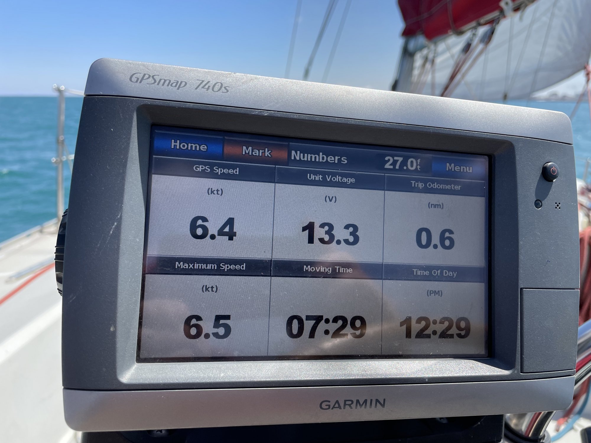

Just to close this thread (at least for now), I put the MRBF fuse holder and a 225 amp fuse back on the battery bank today and after bending the sails on, took Tally Ho out to stretch her legs and shake out the sails. Engine started fine at the dock, no fuses blown.
Only about 40 F today on Lake Michigan, and very breezy.
