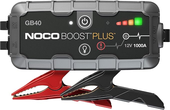

By portable battery charger, do you mean one of those "jump packs" used to start engines? If so, then you can start the diesel with one because starting a diesel takes very little total energy, a few tenths of an amp hour. However, the jump packs won't recharge a house battery.

That’s right.
NOCO Boost Plus GB40 1000 Amp 12-Volt UltraSafe Lithium Jump Starter Box, Car Battery Booster Pack, Portable Power Bank Charger, and Jumper Cables For 6-Liter Gasoline and 3-Liter Diesel Engines.
I'm thinking in case of an emergency.

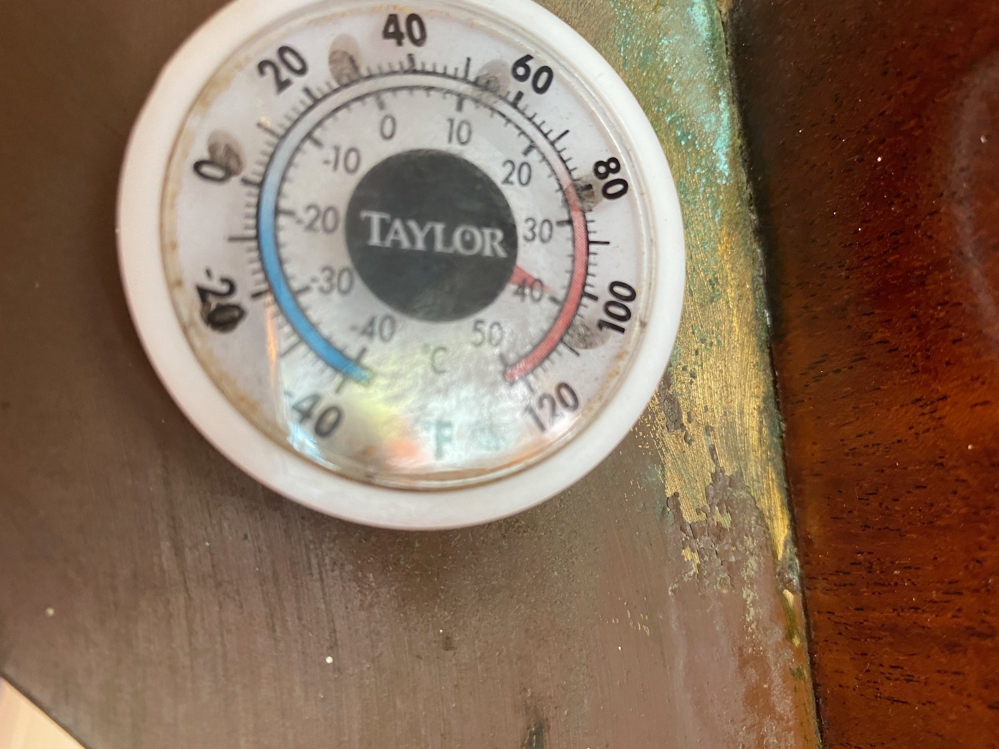

I picked up the new batteries and took them to my boat on the hard (waiting for launch - yard is backed up like I've never seen). Gave them their lift time lift up the ladder and put them below. Phew, it was hot in there! Opened the overhead hatches for some air. Started to wrestle them into place but it was still hotter than hell down below. I looked at the thermo in the cabin:
WTH? This is early June on the coast of Maine. We had the heat on last week. Went home where the AC was on. It was 90 in the shade there. The batteries can wait,.... :)
