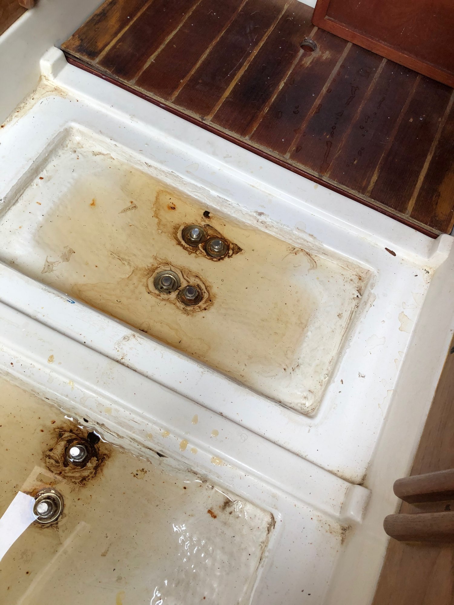

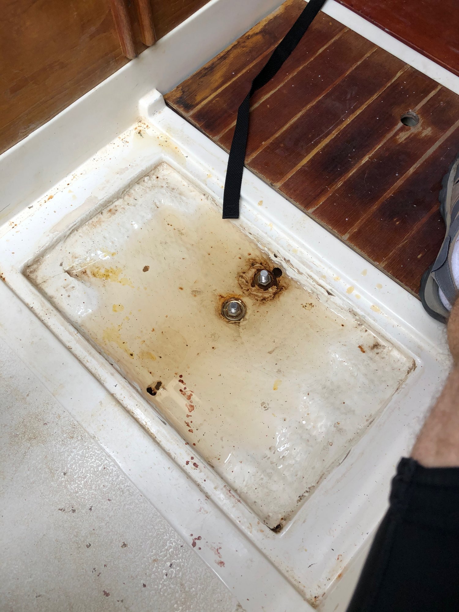

I've have an 87 Hunter 23 and I keep finding water under the floor boards in the cabin. It seems to be there after we have heavy rains, but I can't figure out where it would be coming from if it is rain water. I'll go for weeks without any water and then today I removed almost 5 gallons. There doesn't seem to be water anywhere else.
Any thoughts would be greatly appreciated.
