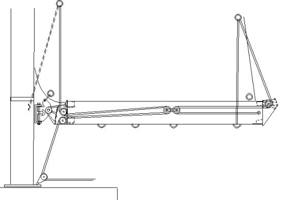

Derek:
I am not sure your setup is the same as our HV'36 but this was not the easiest reefing system to figure out. As I remember the blocks inside the boom should be in the aft position when the main is fully deployed. As you pull the reefing line the block is pulled forward as the sail comes down. The reefing line should pull that block forward.
There should be two lines that have knots at the aft end of the boom.
Do you have a manual with drawings? If you do not, I would call Hunter and see if they can provide them for you. Anyone that sells Isomat Spars may also have these drawings for your boom too.
The sheaves in the aft end of the boom are only held in place by friction (no mechanical fastener). I think once you get everything set up properly it will work fine.
The mast has an external track but I cannot remember what keeps the slugs on the track.
Dec 2, 1999
15,184
Here is a drawing.
Derek:
I do not know if this will help, but take a look.
