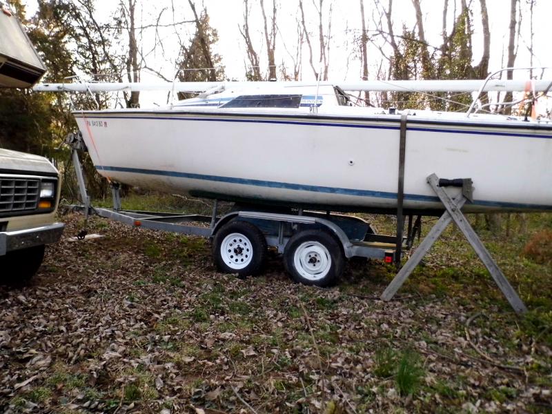

Another thing, the original trailer for the 23 is not that great anyway - the boat rarely loaded right and you had to brake-check it forward once you came out of the water.
If you managed to winch the nose up tight to the bow roller in the water, the cable would get incredibly tight and flex the trailer / try to pull the bow eye through the boat when it settled onto the bunks.
The extending tongue is a BEAR to move
The boat sat too high, and is incredibly marginal for 2 tires at highway speeds. Not nearly enough tongue weight
I flipped the axle to be undersprung and added a second axle, which helped a lot. I put quite a few miles at 70+ on mine, it lived a rough life (and is hopefully enjoying its next one!) It's certainly not a bad trailer, but somebody could probably look at these pictures and whip one together that is as good or better

The second axle was a good mod for handling and capacity, I'm sure. For anyone else considering it, if there was a problem with not enough tongue weight in the original design, the addition of second axle forward of the first would exacerbate it.
