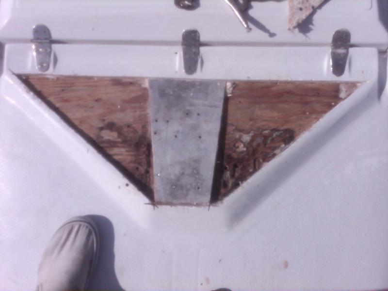

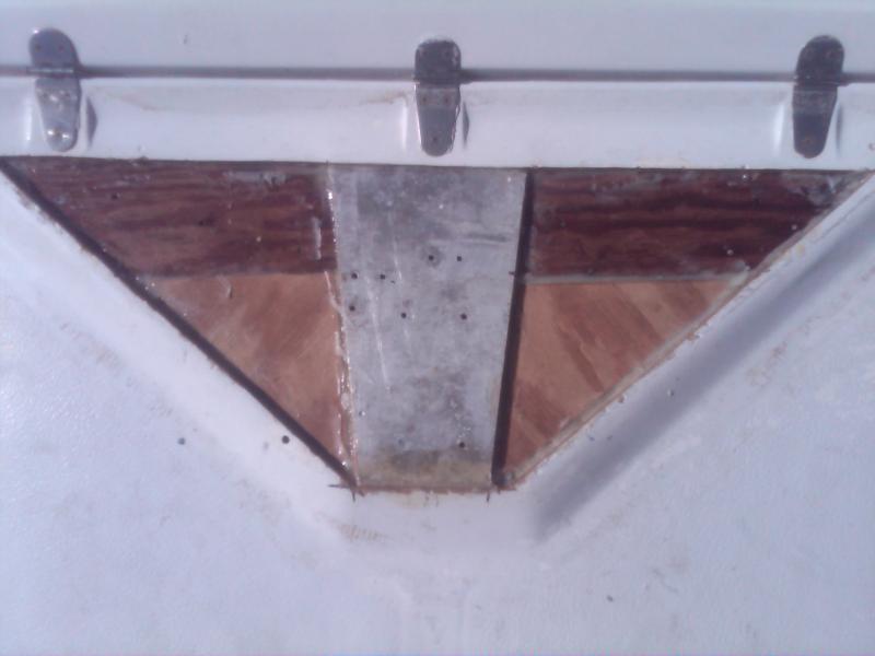

I have an 87 23' and had to replace some rotted core under neath the mast. In doing that I cut out the layer of fiberglass and gelcoat about an 1/8 inch down and peeled it off for reuse later. What is under there is a piece of aluminum plate that is set into the area and may go back up further under where the main hatch is. I did not take it back that far. It sits direclty above the support pole in the cabin.
I stripped one of the bolts while taking the mast base bracket off and had to redrill the mounting bracket and tap a new 1/4-20 hole in the aluminum plate. I basically moved the hole i stripped an inch or half inch and it worked well. I posted the pics, but can't find the post. I have also changed computers but will try to get you a pic or two and repost them.
