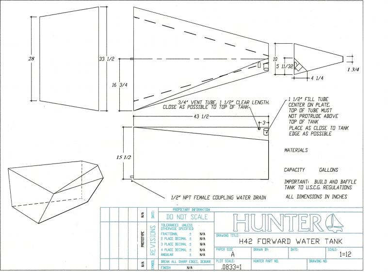

I carefully read everything and everywhere about water tanks replacement for HP42 and so far found that only right option for forward tank, will be cutting existing one off and to pieces and replace with new custom made polyethylene one.
The fwd. tank will be a bit smaller, so total water capacity will be about 5 gal. less. The reason for this is, that there is no way to bring original tank inside or out. I measured everything and decided cut 3-1/2"bottom portion of tank, so I changed original Hunter drawings and now the height of tank will be 15-1/2" this allow bring tank inside forward cabin(the door is about 15-3/4 wide).
See modified drawings. The port tank is going to be straight forward, I just told custom manufacturer make it 1/4" smaller in all dimensions to facilitate installation.

Hi Zaya, would there be enough clearance if you removed the door and frame from the forward bulkhead? Maybe you tried this already. I cannot imagine that Hunter would have installed the tank before they dropped the deck onto the hull. But then again...
