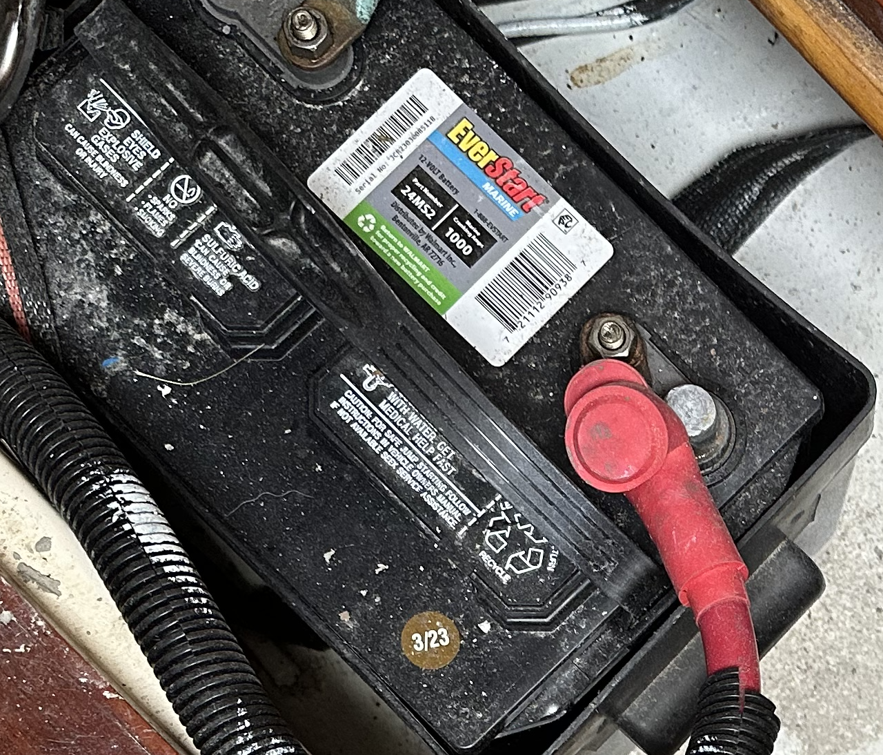

Take pictures of your batteries and post them here. Maybe we can help you decipher the problem.

The engine is the 60 HP turbo charge 4 cylinder Yanmar. I think it is a 4JH2-TE. I got a part number off the current battery and it comes back as a Group 24.
Our 1991 P42 takes a Group 24 starter battery. It resides in a covered plastic battery box secured to the upper shelf with a strap. Does your boat have a Genset?
I think mine is a 24 also. I have the same installation you described. We have a 9kw Kohler generator.
