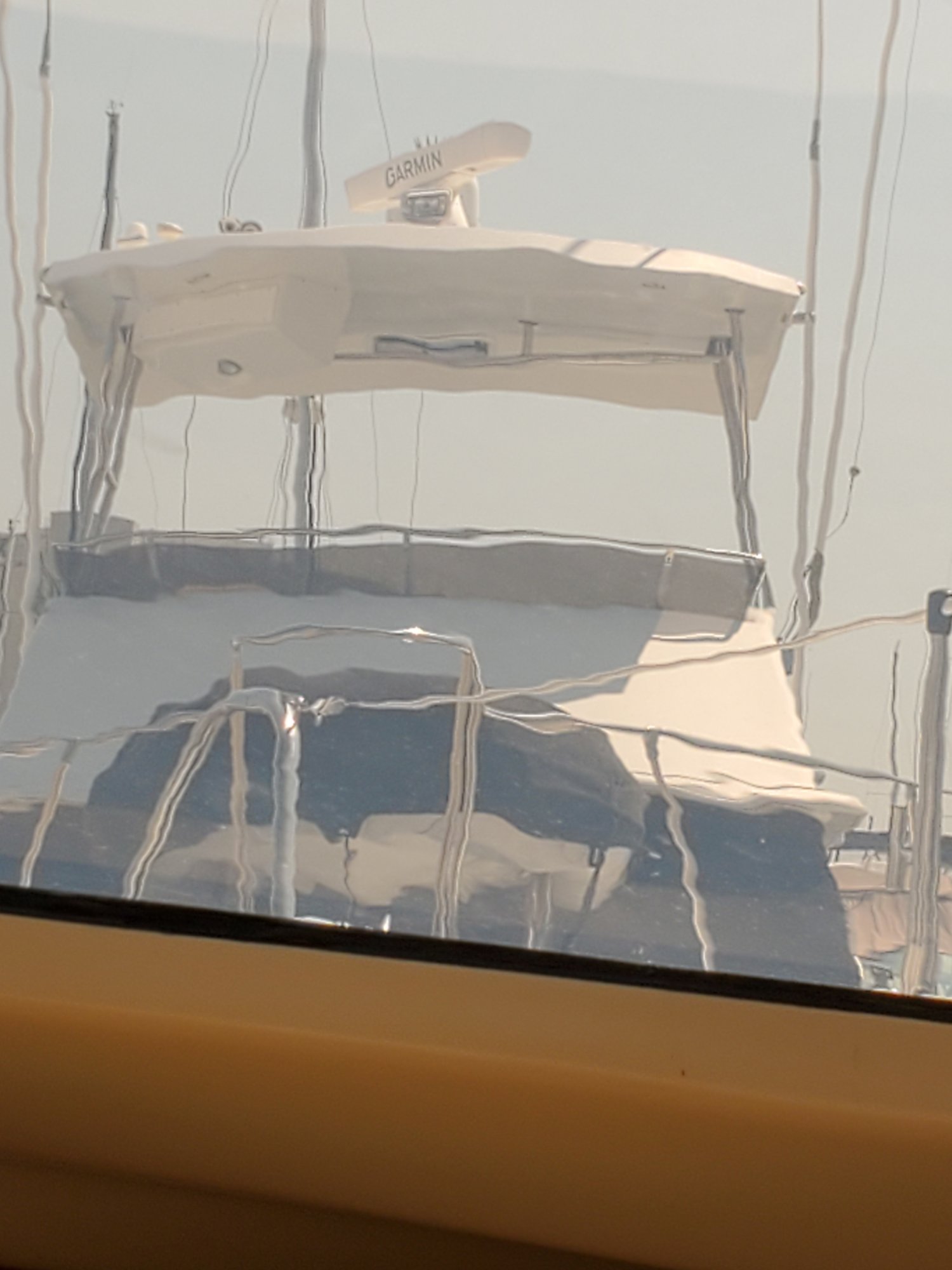

The forward window on my Hunter Passage 42 had crazing when I purchased it 6 years ago. I got a recommendation from Downwind Marine here in San Diego for a person that replaces boat plexiglass. I'm very disappointed in the result, and I'm wondering if anyone else has replaced their forward window and how it turned out. I showed the attached pictures to a plexiglass fabricator and he said what I have isn't normal.

Looks like he used extruded plexiglass instead of cast plexiglass. Extruded is less expensive and much poorer optical properties

I first thought it must be one hell of a hot day in San Diego with all those heat waves.
As @kloudie1 says, cheap extruded plexi as opposed to cast plexi.
You might want to thank the nice people at Downwind Marine for recommending this guy. Even for free, I wouldn't take it.

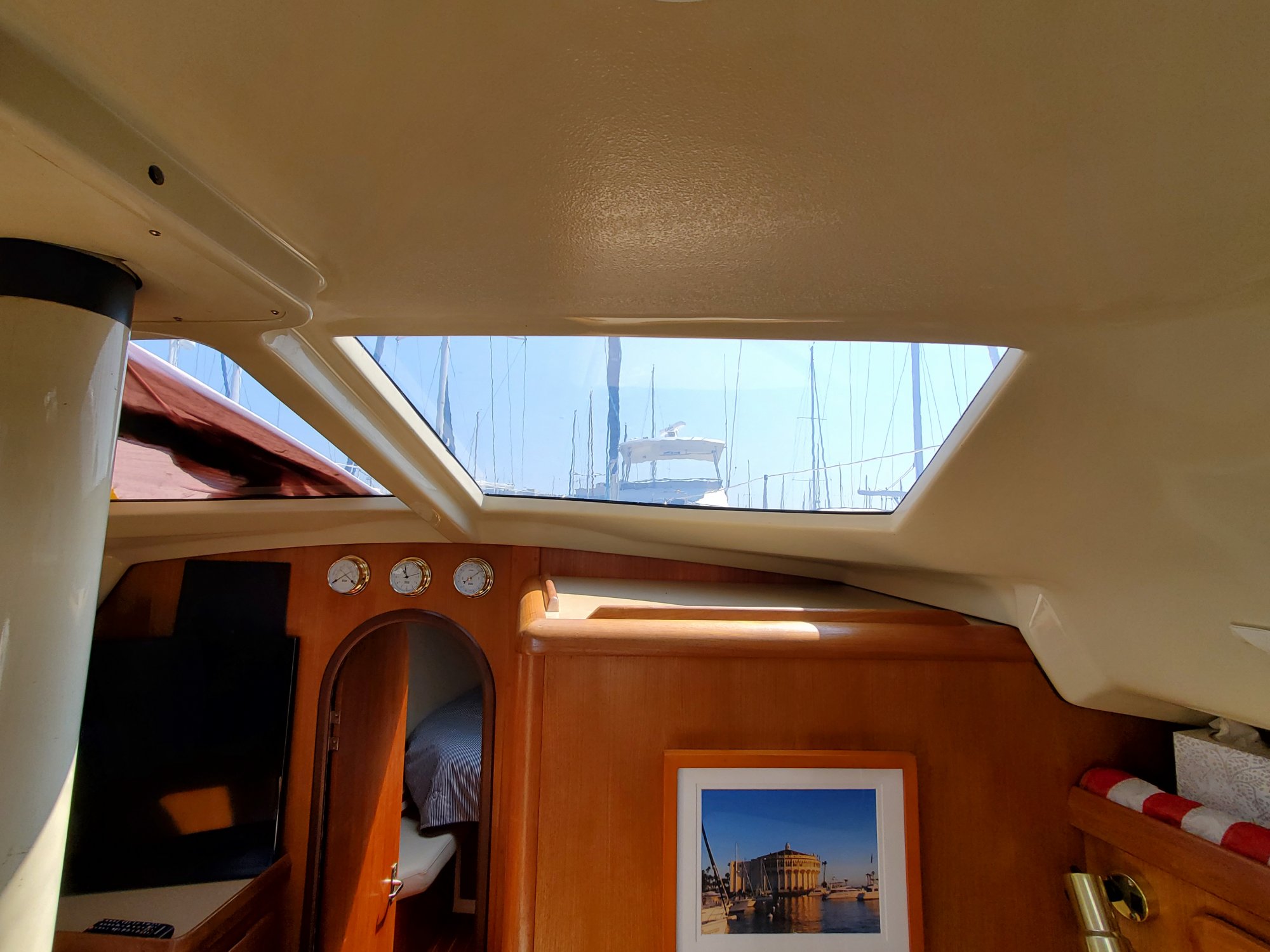

Thanks for the replys. I not sure what to do next. I haven't talked to the installer yet because I wanted to make sure this wasn't normal, and he hasn't sent a bill. I saw this today as I was getting something from the boat.

I'd offer to pay his quoted price, once he removes the piece of extruded plexiglass and replaces it with cast plexiglass. Of course, you know this was simply an accident on his part. Any problems and I'd tell him to hit the road.
I've seem a lot of boats at Vancouver boat shows and have never seen distorted glass like that ......................... because no one uses extruded acrylic for windows. Probably used in commercial work with lots of thermal bending. The waves don't show.
