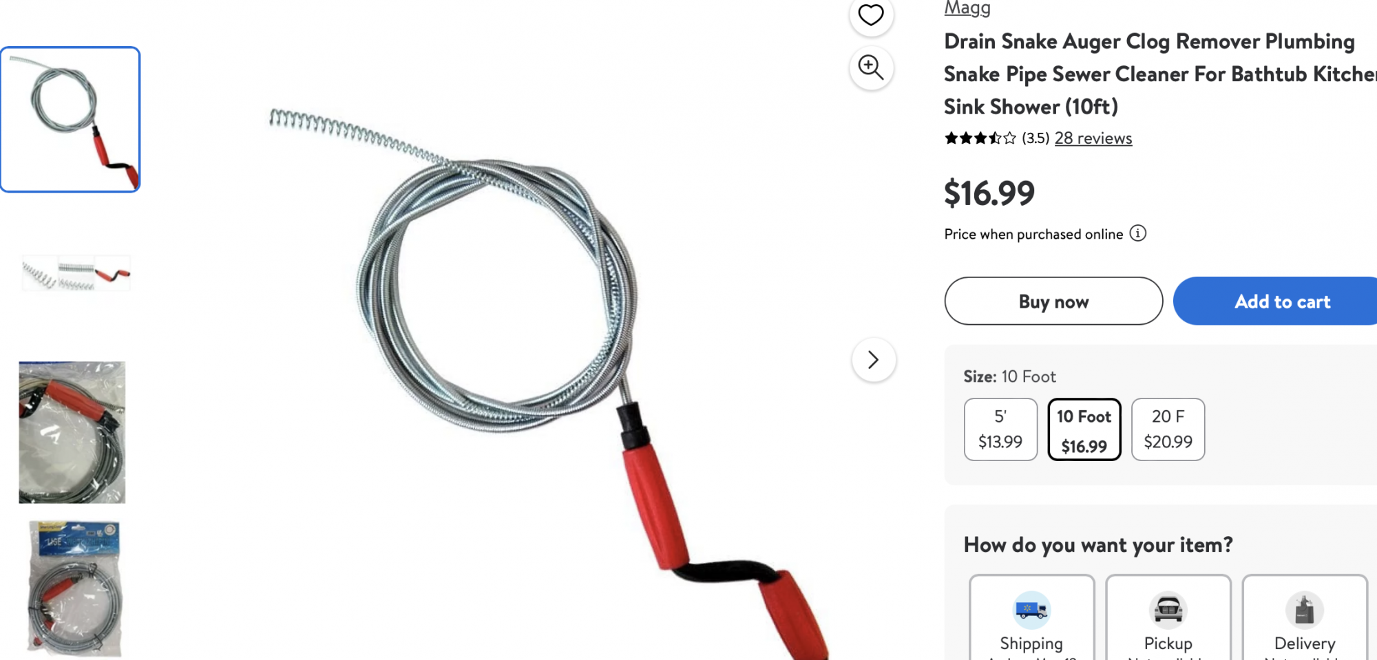

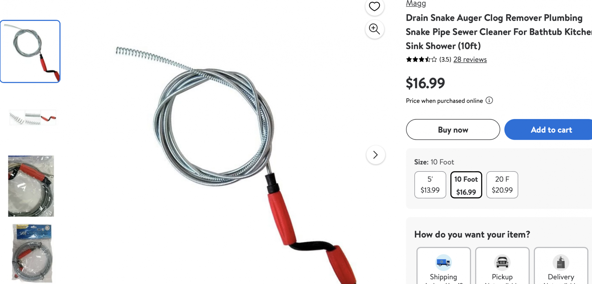

Thanks for responding. The picture shows the solenoid in the upper right of the photo and the vented loop in the lower background. The solenoid is the not part number you mentioned. This one is no longer available. You can see the loop looks pretty corroded. I think there may be a leak or hole in it because I removed the vent hose from the solenoid and folded it over and taped it so that it would not allow air in. You can see that in the middle of the photo. Toilet still not pulling water in. Gate valve works, water flows with hose removed. I ran a plumbers snake to get clogs out. There were none. Brand new pump. I have replaced them before with no issues.
