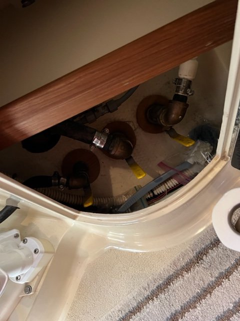

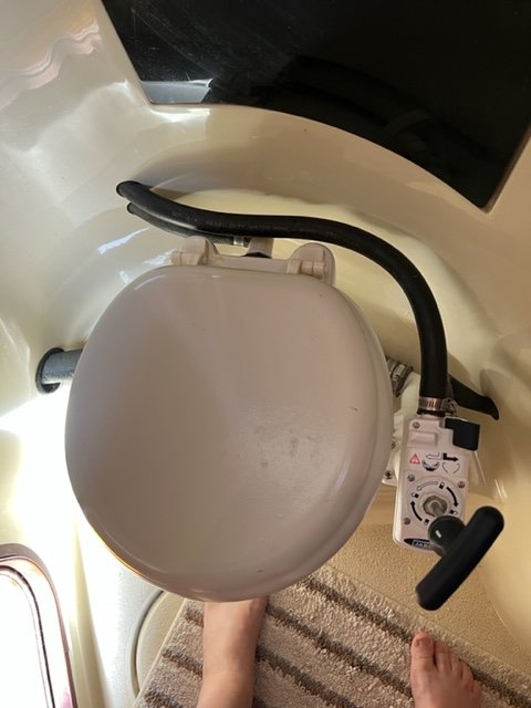

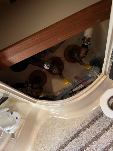

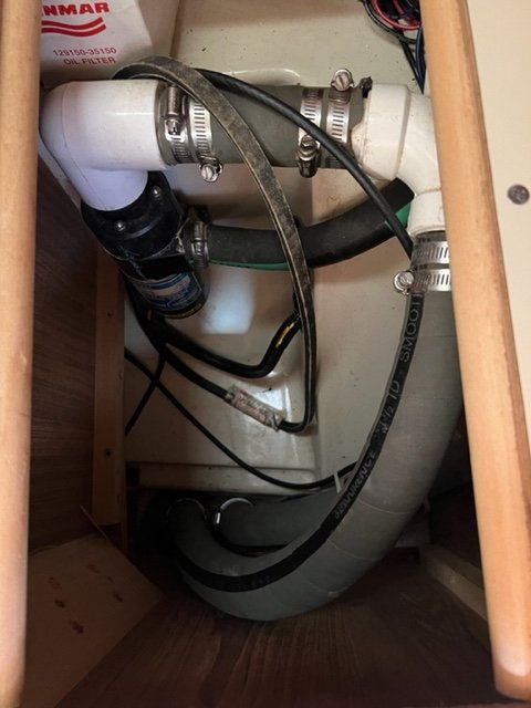

My heads are backfilling with waste. There is back pressure when I try to empty the bowl. Also, it bubbles after I stop pumping.

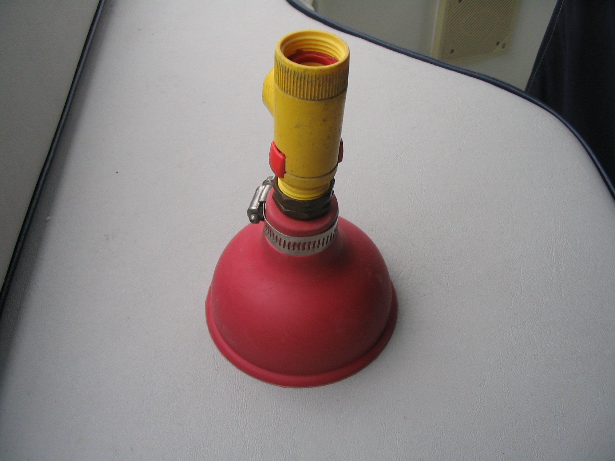

I also strongly recommend you replace the "vent" thru-hull (which are designed to keep sea water out of fuel and water tanks, not suitable for waste tanks, but boat builders use 'em anyway 'cuz it costs 'em less to use the same thru-hull everywhere) with an open bulkhead aka "mushroom" thru-hull. Not only will the allow more air exchange with the gasses in the tank, but it'll also prevent vent blockages by allowing you to put a hose nozzle against it to back flush the vent line every time you wash the boat and/or pump out. Anything that's tried to set up house keeping it will just get a water slide ride into the tank.
