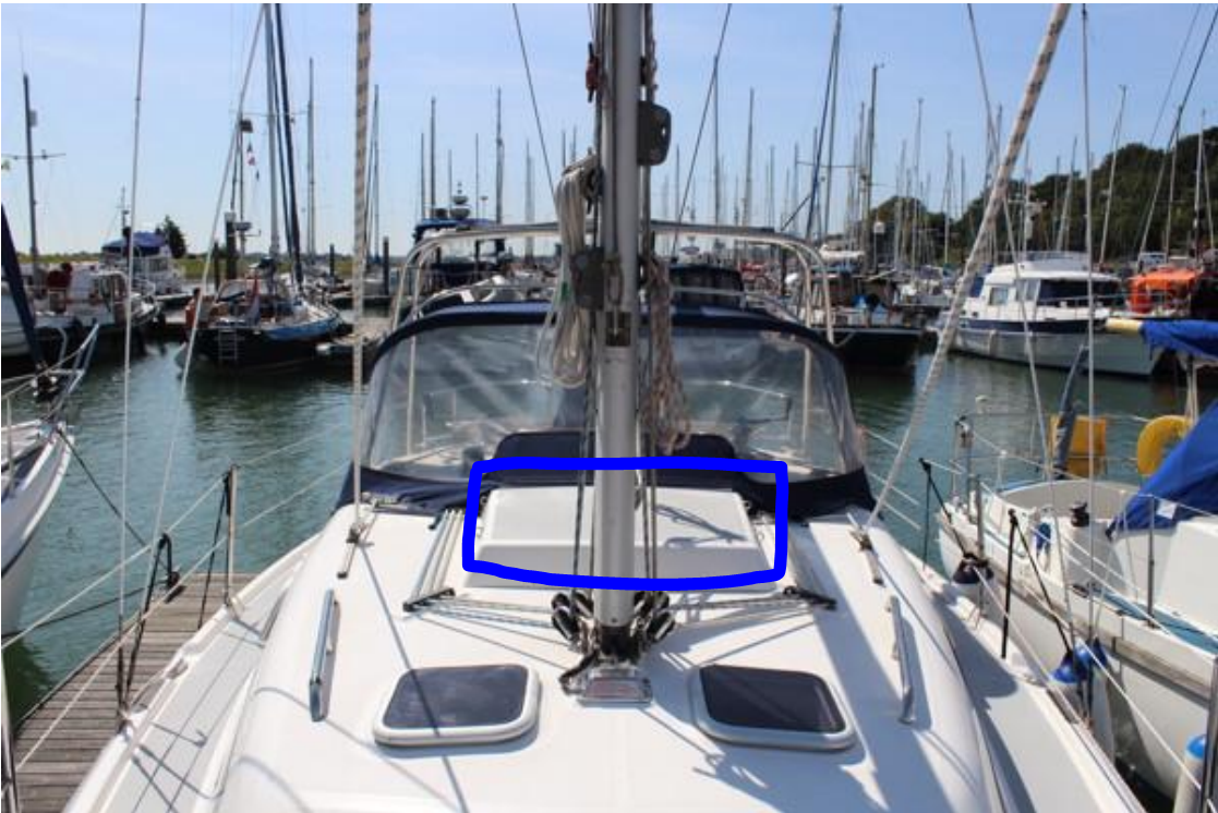

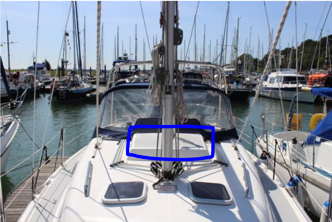

Whilst thinking about this, this evening at home I thought this place (see attached), not sure what thats called. Companion way cover (or something like that?)
Would a panel on this be sufficient in terms of the power it can put out? Looking on Amazon, there are a lot of choices with Charge Controllers. I have seen a few videos on Youtube of people installing them and I think its something I could do myself.
This is the most likely place to install a solar panel but as far as area goes, I don't think it's sufficient. Do some arithmetic and check the area of the panel compared to the area of the panel you require for needed power. I think you 'll find it a little lacking.
