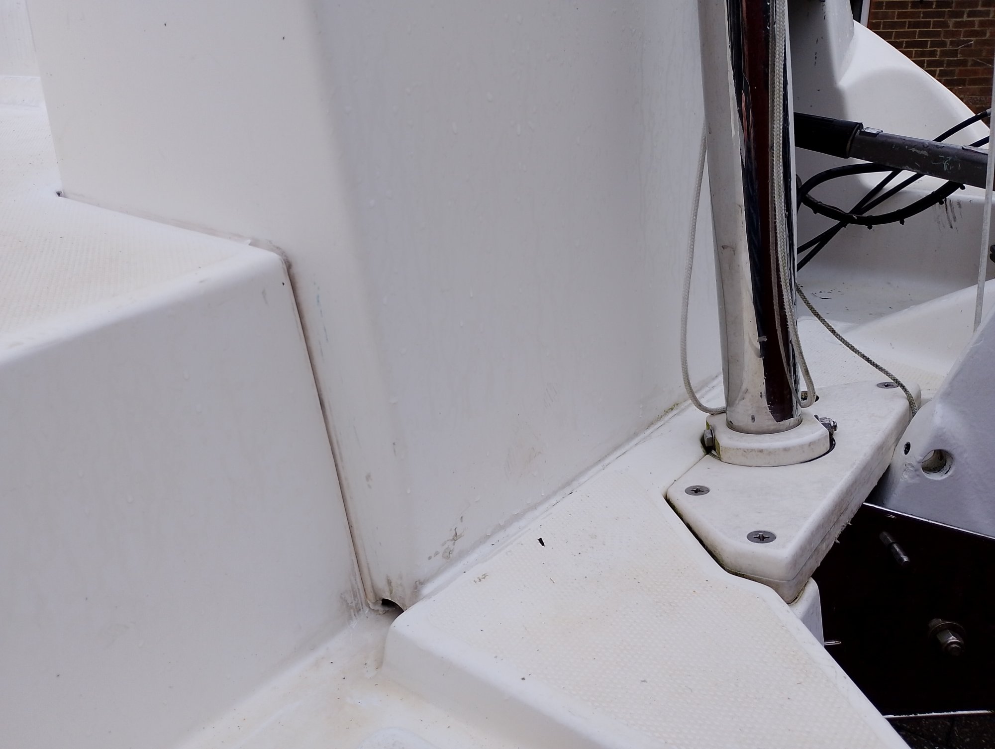

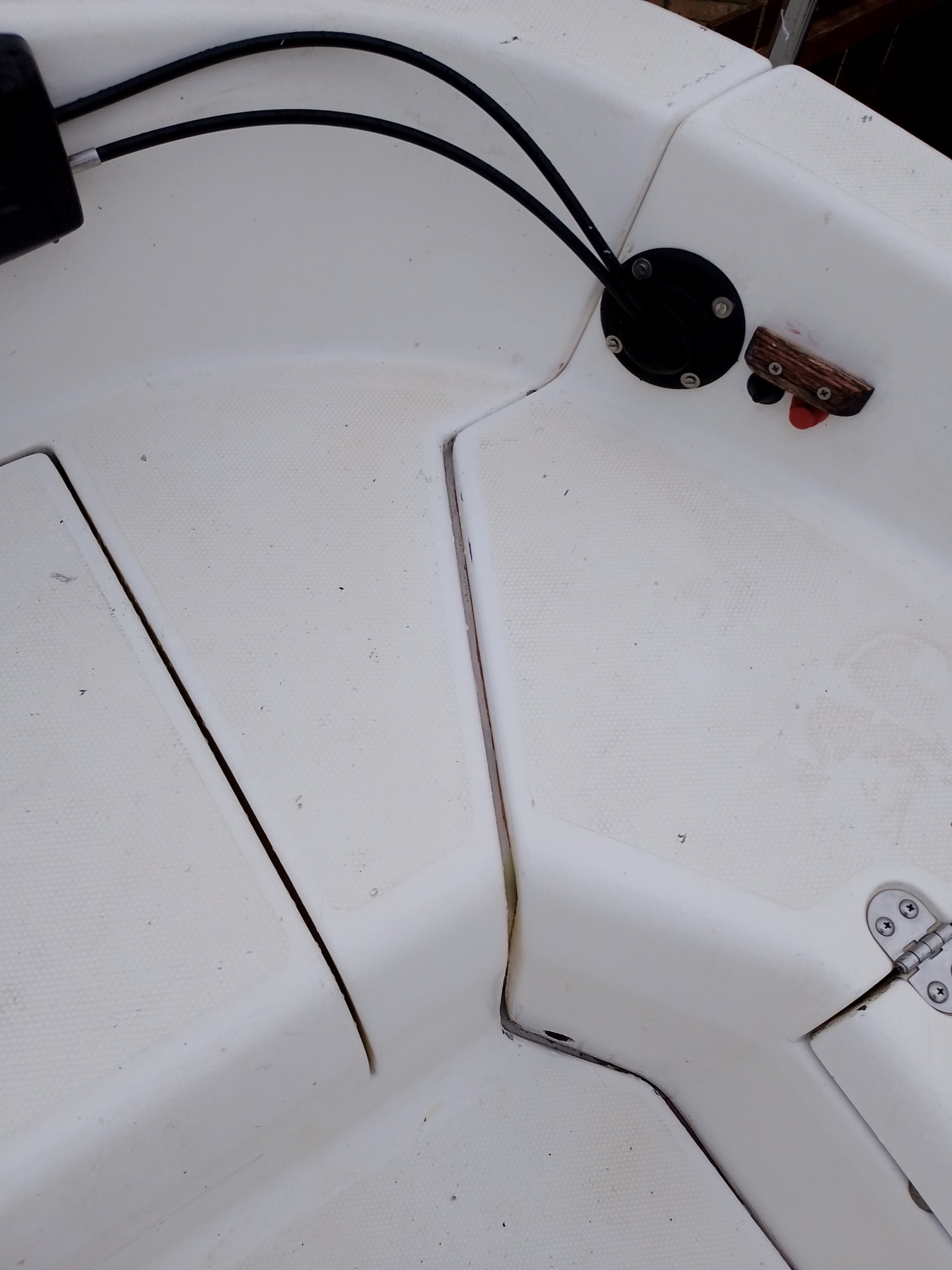

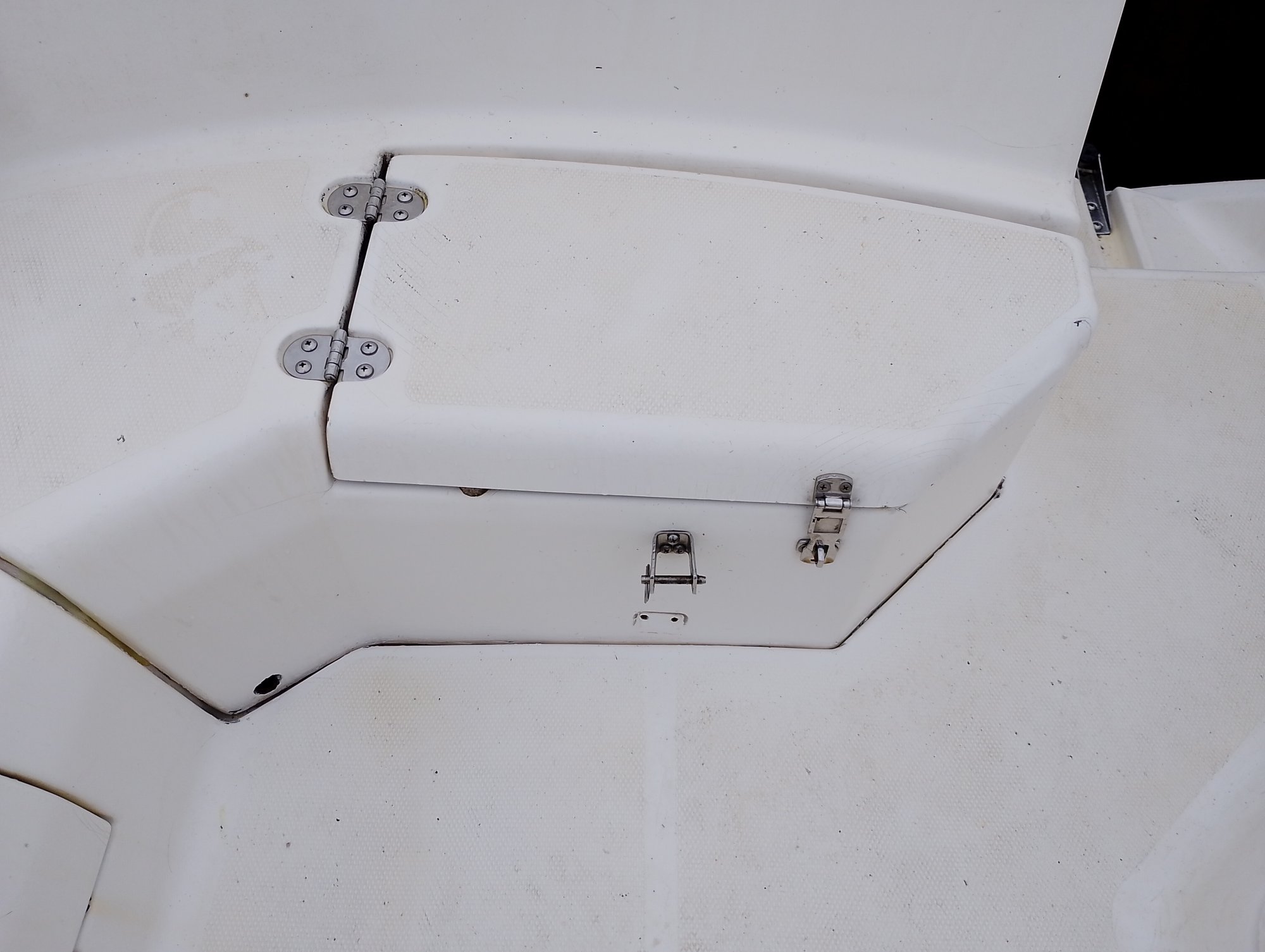

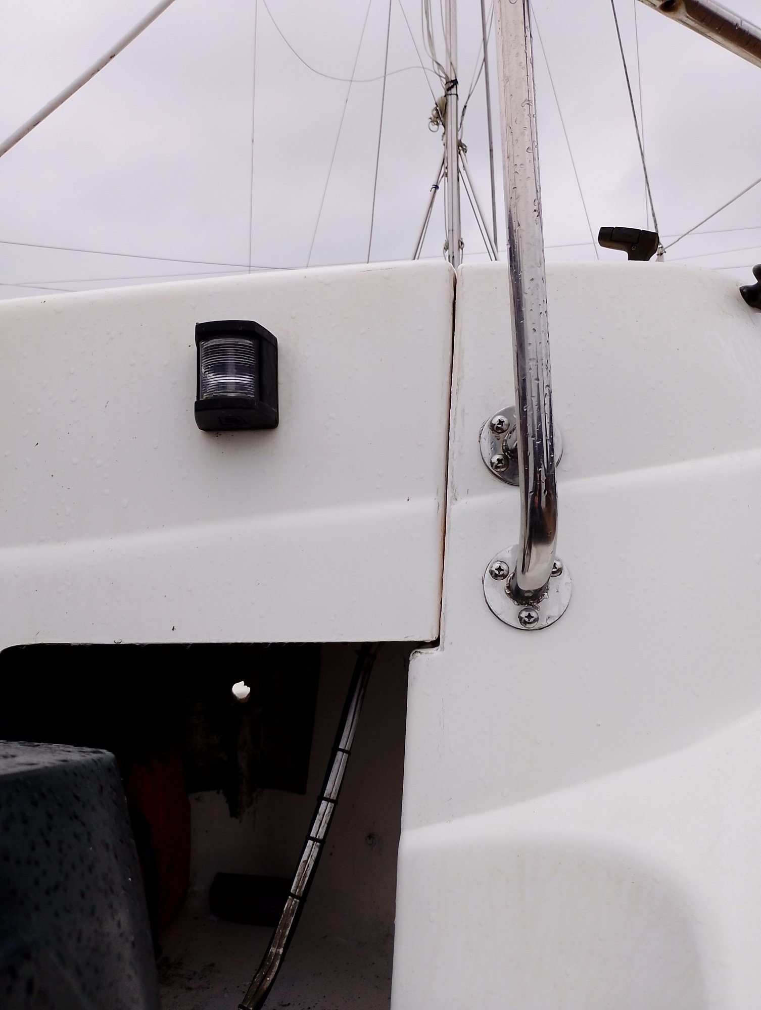

I've owned a 1997 Hunter Legend 240 for the last 10 years, it had one previous owner. It has a bead of silicone sealant in the gap between the rear section of the hull (transom / stern locker etc) and the main hull, inside the cockpit and the outside of the transom. I'm fairly sure the rear section of the boat is an integral part of the hull so not sure if this sealant is necessary? Advice please.

Going to defer to Crazy Dave, but I think that is the primary seal between the cockpit molding section and the hull. It is probably a tenacious, almost permanent adhesive sealant (kiinda like 5200) ... it may or may not have been overlaid with silicone sealant in a previous attempt to syop some minor rain or seawater leakage..

Most likely it is the hull to deck joint that the is filled with marine putty has cracked and/or lower rudder Gideon is loose.
if dry in the rear with no one on the boat, most likely water coming in when sailing or standing in the cockpit. But I will ask if the two nail plug and wing nut are not leaking either

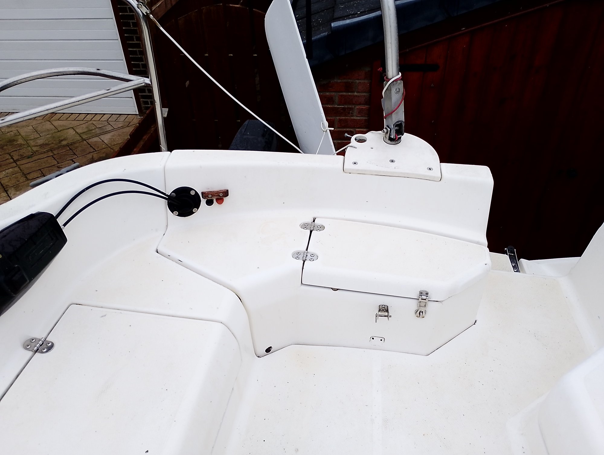

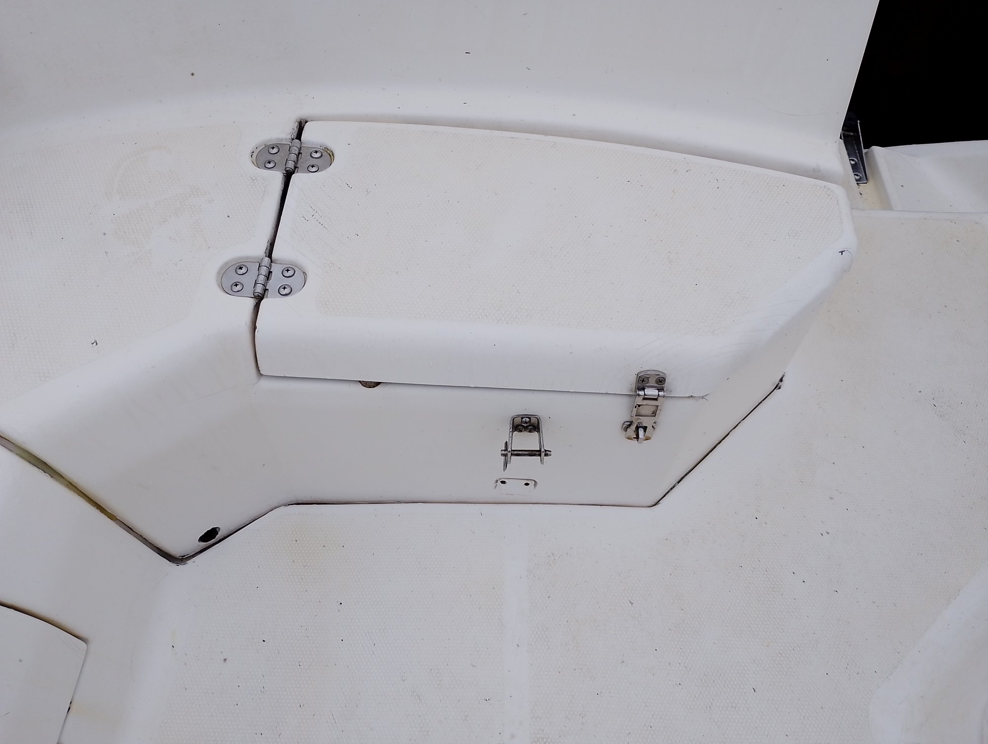

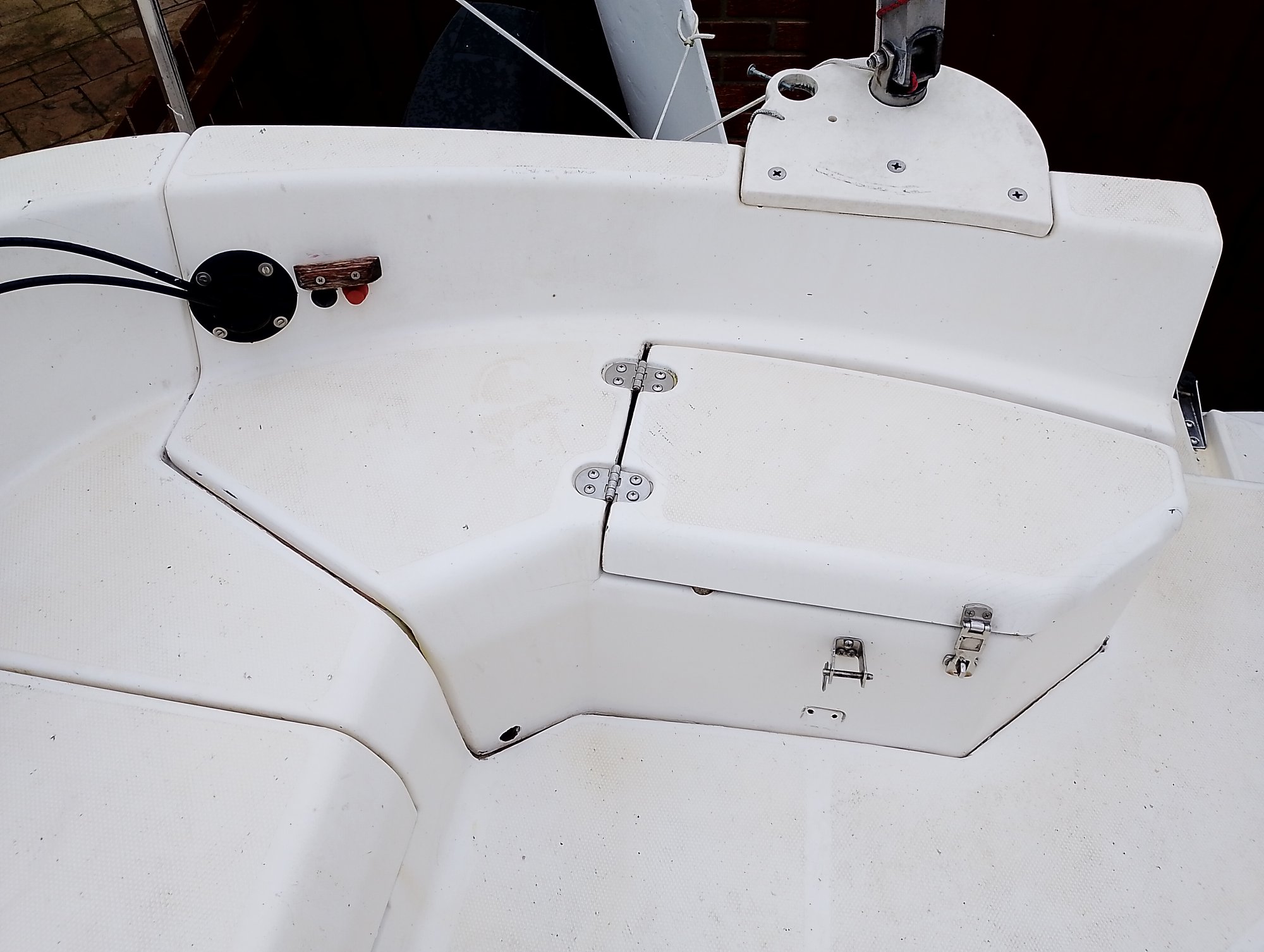

Here are the photos as promised, I have removed the silicone sealant that was in the gap and ran round the entire rear section of the boat. I believe sealant is only required in the section between the cockpit floor and rear locker?

@Ian Robinson Actually I vused to apply white caulk to keep trash, dirt, etc as it made cleaning easier in the cockpit. If there are any screws in those channels for example the hunter 260 holding either the wheel steering or tilller cockpit floors , it added a second layer of caulkinng to keep water out of the cabin.
Read my post “Hunter Water Ballast Transom Leaks” as my first thought you were getting water leaking inside the hull which is serious but not in this case. I posted that recently which I suggest reading for future reference.
