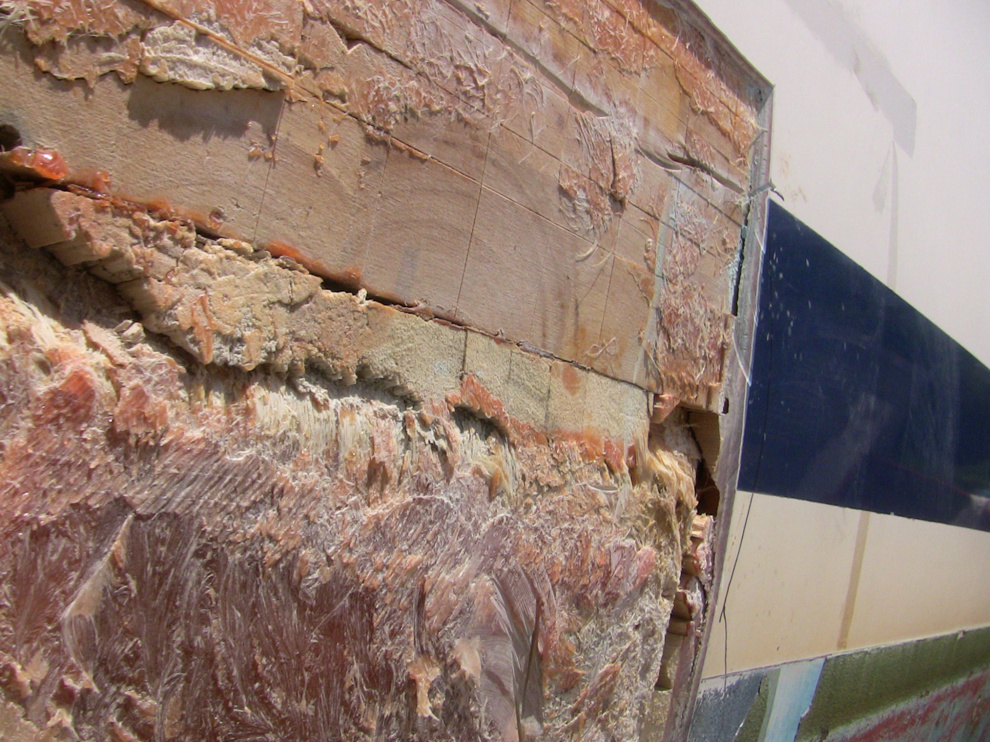

1) One did the Electrical on my boat
2) One was in charge of the Hull Lay up.
I had recent Hull Damage and now I have first hand knowledge , the hard way.:facepalm:
Jim...

JamesG, what year is that on? Did it have moisture between the fiberglass and wood? If it did hav moisture did you find out where it was coming from? Sorry for so many questions.

My boat is 1998
The method of making the Hull Fiberglass, in its Mould, for our size boats, was used for the years of your query.
As @Crazy Dave Condon asked you...
What is your issue or problem?
Hull construction is different for various parts of the boat.
Help us help you. Pictures would be nice.
