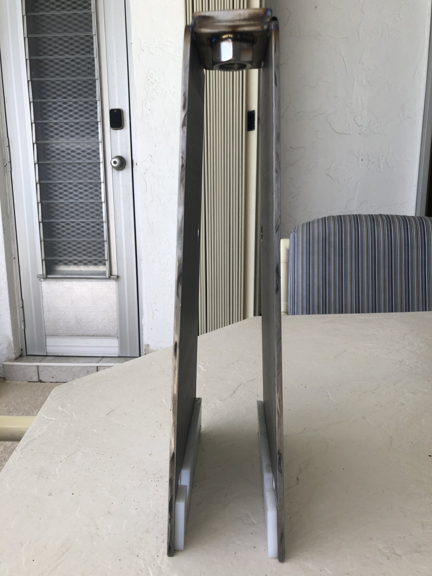

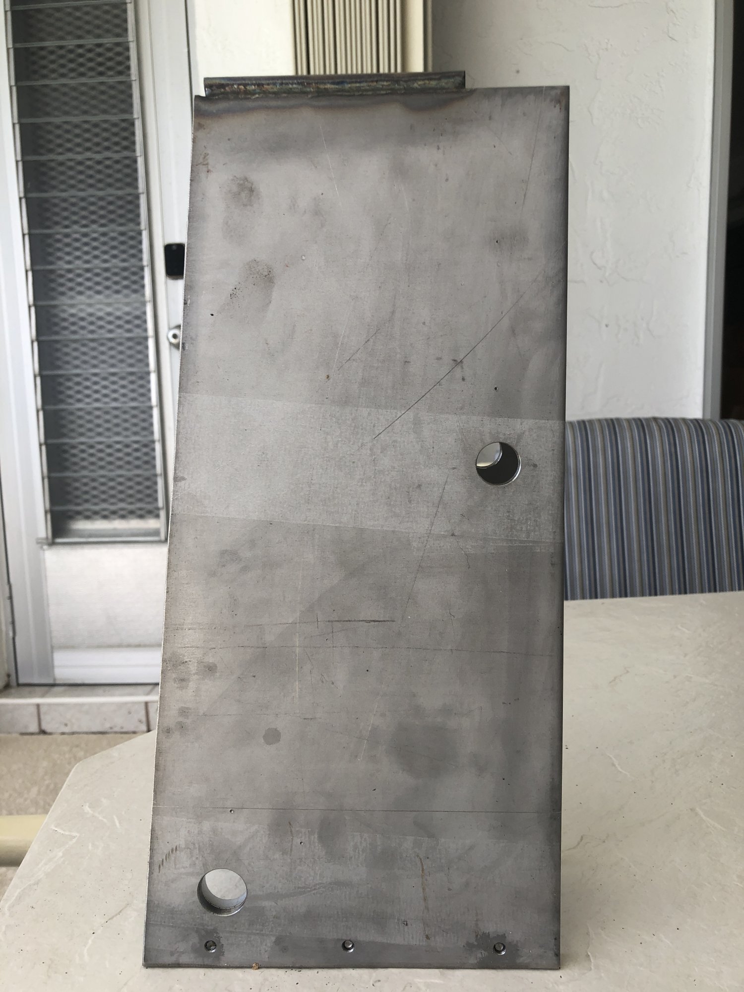

I was replacing the centerboard uphaul on my h240 and this is the condition of the bracket. I realize it’s 25 years old but this was one part of the project I never expected to have to deal with.
If you haven’t looked at yours in a while, I would suggest an inspection be performed soon.

I PM'd @Crazy Dave Condon to get clarification on the proper line size and his response included additional useful information; I'm posting it here for others that may find themselves in a similar situation. Given my boat is kept on a lift with no pressure on the centerboard, the explanation of why my bracket rusted out and broke is still unknown,
@Crazy Dave Condon Wrote:
7/16 inch line. Don’t consider 3/8 and 1/2 inch line. The forum store sells line for the centerboard which I recommend.
I was getting to post a suggestion on the centerboard bracket as this break was a first for me to see as it normally breaks at the weld. The only thing comes to mind is the centerboard pinched between the centerboard housing and keel tray on the trailer. If so, raise the bunk board stalks or supports just enough to allow the centerboard to wiggle between the boat and trailer. You can purchase this centerboard bracket from the forum store as they have the measurements for that bracket. It is not cheap
There is a good article by @rfranger on changing out the centerboard line found on the Hunter 26 and 260 boat information which would be applicable to all the Hunter water ballast sailboats

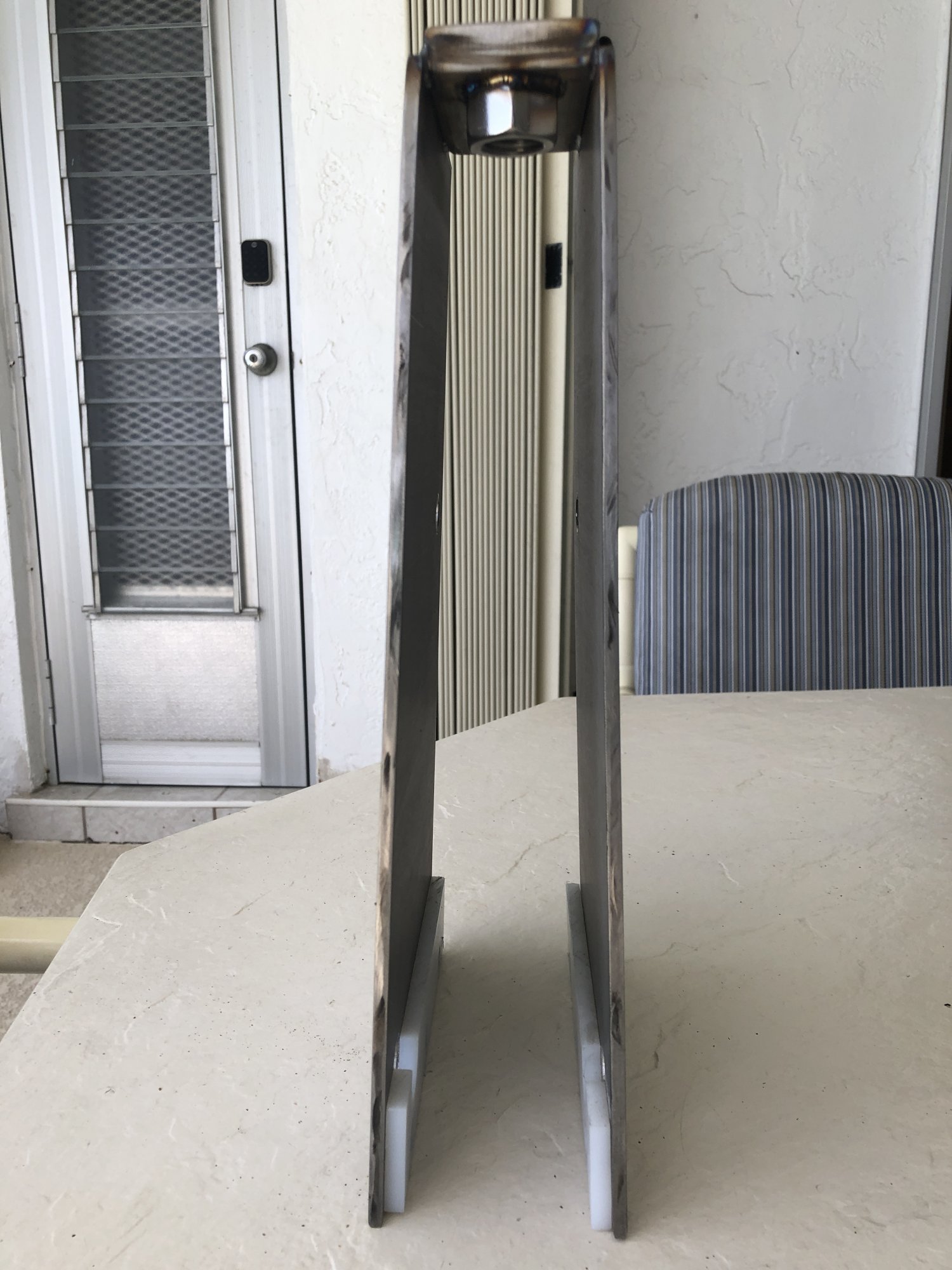

By the way, I've got a new bracket, roller and bushing on order so should be back in business in a month or so .

Best of luck, my new bracket is due to ship next week. I guess they had to manufacture it.
FYI - not sure if it will help your situation but since I am doing this over water on a boat lift, I screwed a 2’ all thread rod (from Lowe’s) into the bracket after removing the bolt to slowly lower it (with a nut I can adjust inside the cabin for control). I plan to use it to help guide it back up into the trunk again too.

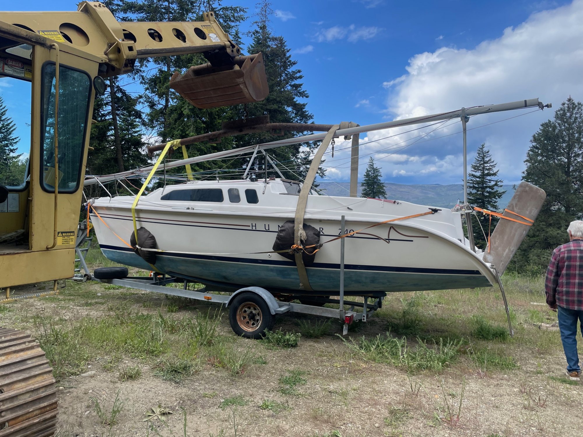

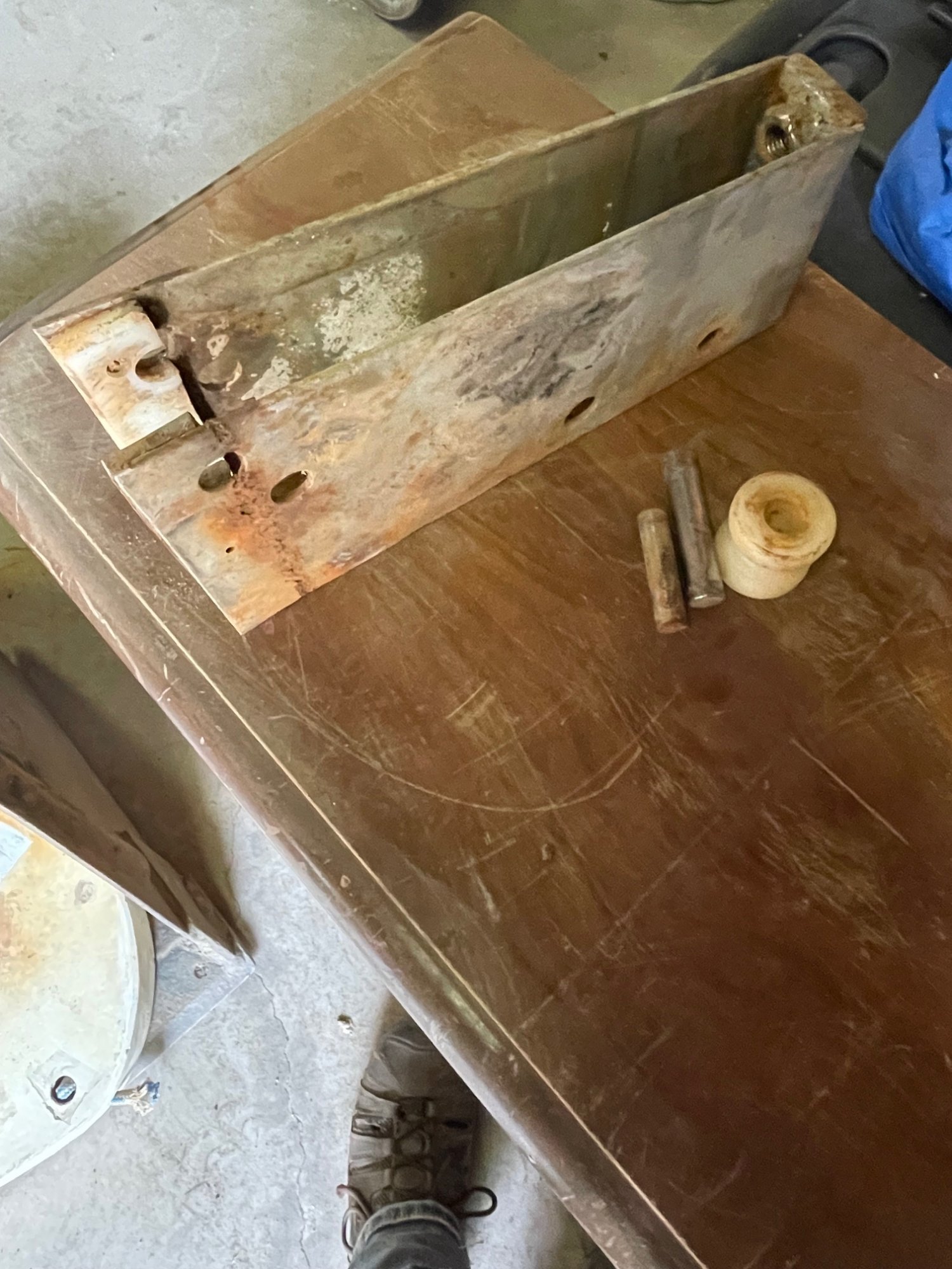

Jun 10, 2024
348
Hunter 240 Okanagan Lake

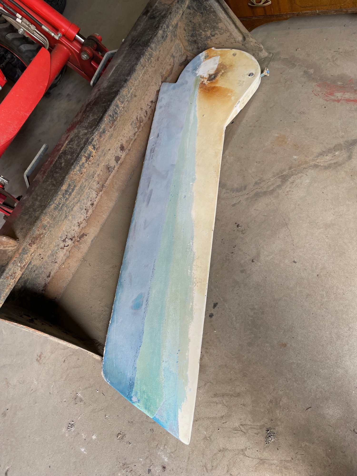

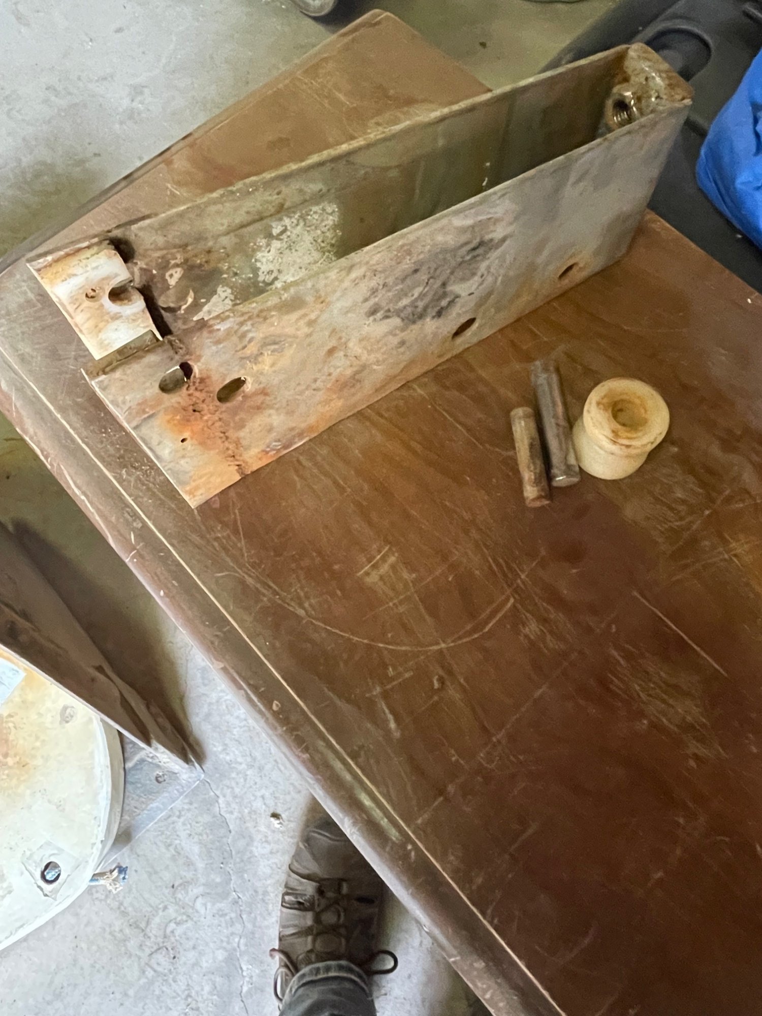

Well, it's out. There is no wear where yours broke but there is a rust line on either side that has my attention. I'll be cleaning it all up and will likely get it welded just to make sure. Not a lot of room in the hull slot though. Pins look good, the roller still looks new. New lifting line for sure.
Glad I'm on the same page :)
Had the same thought to get it back in. Nice!
Not too shocked re bottom paint on the keel. The prop on the outboard is covered too. LOL
