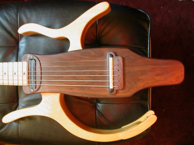

If you stay with wood, consider IPE as a teak alternative; a common decking material. Strong and resiliant as teak. But much easier to find and cheaper. You could (say) buy a 10 foot long piece and rip (say) 3/8" thick (or whatever you want) slivers from it using a table saw. Or a wood shop can do it. Normal thickness of IPE is 3/4", although I've seen it also 1". At your lumber yard, you can pick through their inventory and chose one that has grain and color closest to teak. If you haven't seen IPE before, I've attached a photo of a electric guitar I made with the stuff.
