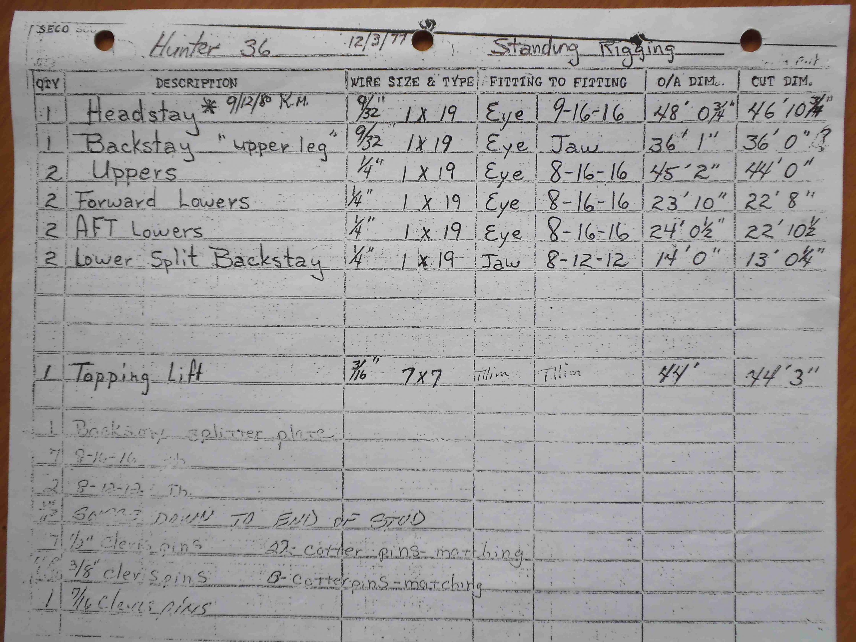

My 1980 36 is the next size down. But actually the mainsail area is slightly greater. And the mast height slightly taller. Although the 37 has the stay sail . The 36, not. Attached is Hunter's running rigging spec chart for the the 36'. 1/4" features for the shrouds.

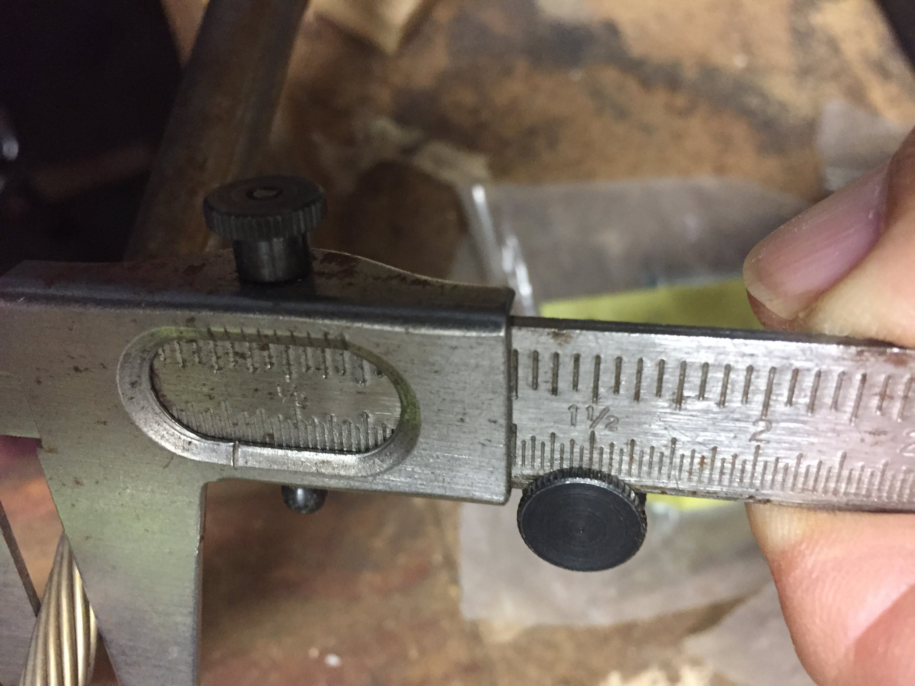

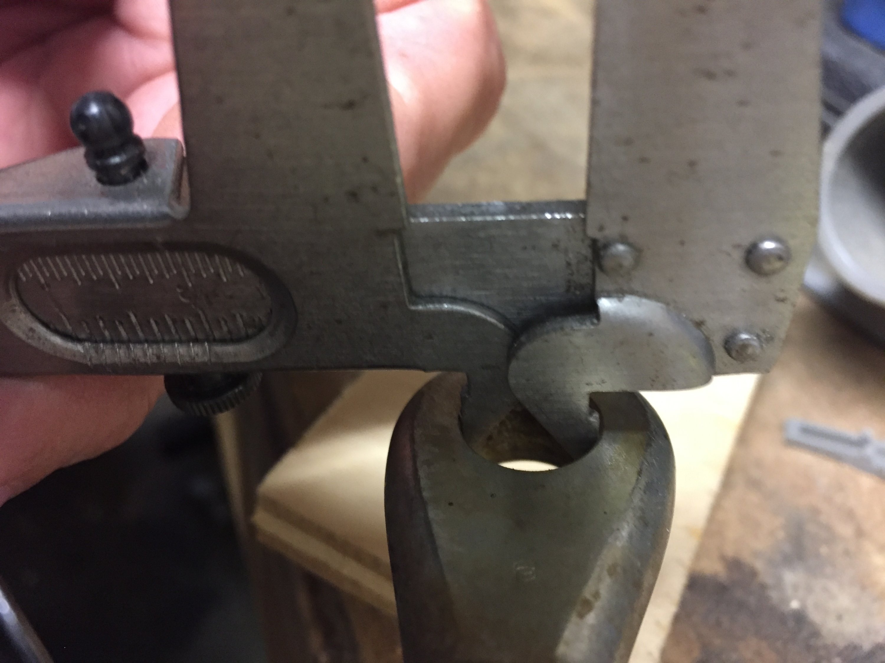

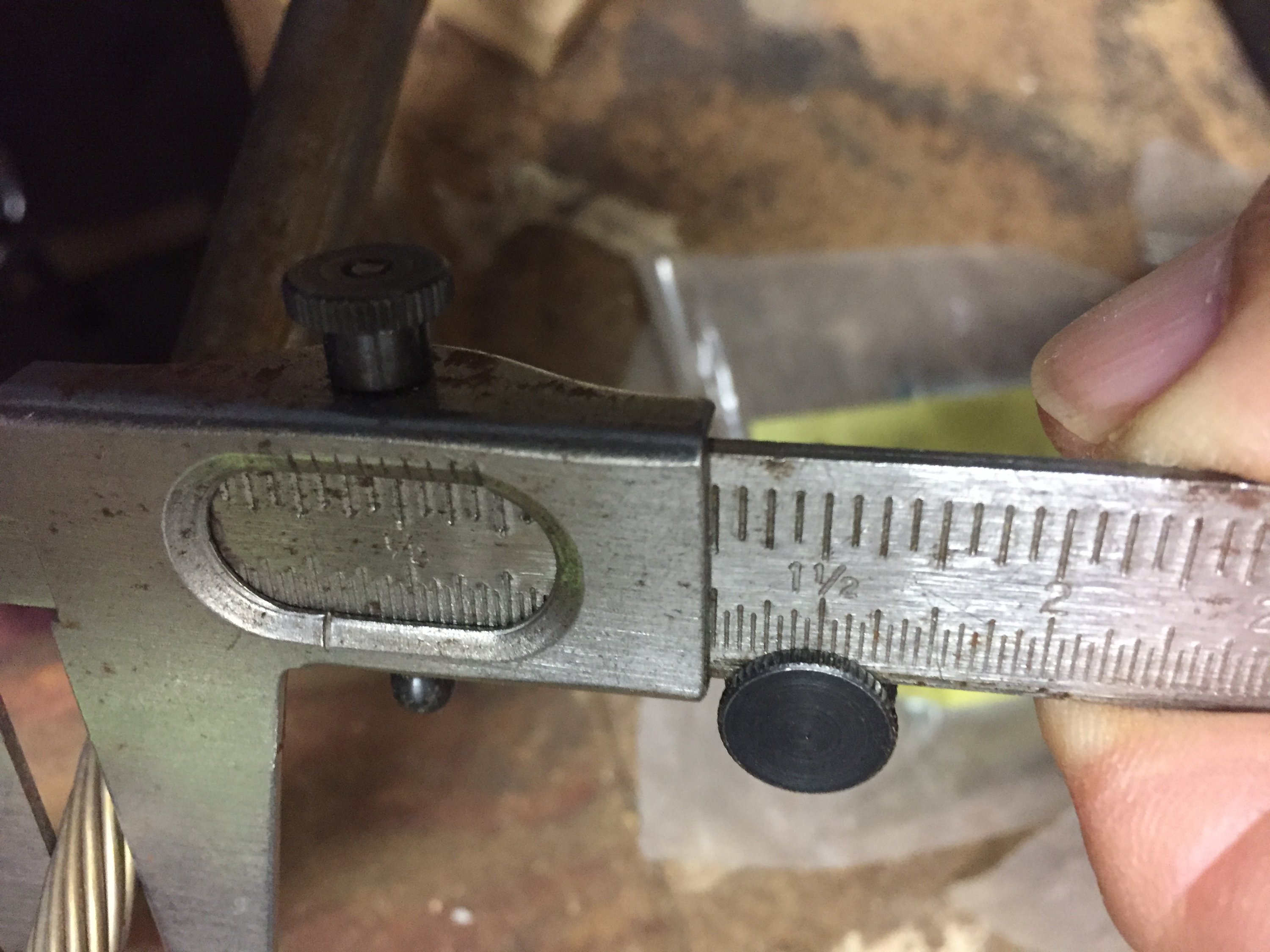

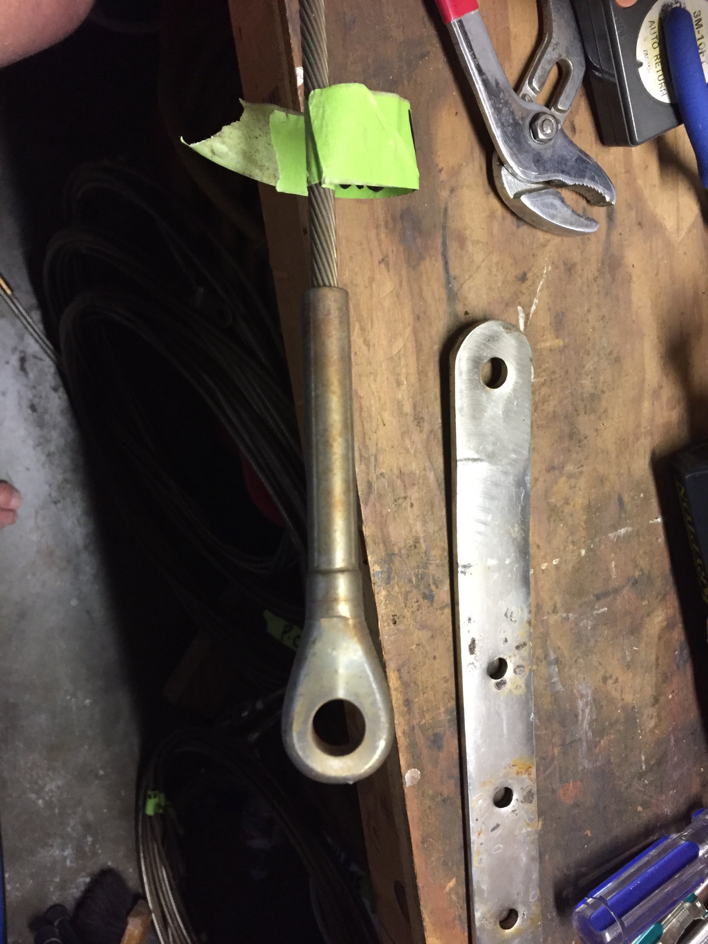

I kept the old rigging so I just went out and measured. That is 5/16" wire and the fitting is for a 1/2" pin.
I am totally confident I don't have 5/32" wire - that is 3/32" smaller than 1/4"=8/32".
Do you maybe mean you have 9/32" rod?
They did replace the backstay and forestay with 5/16.
