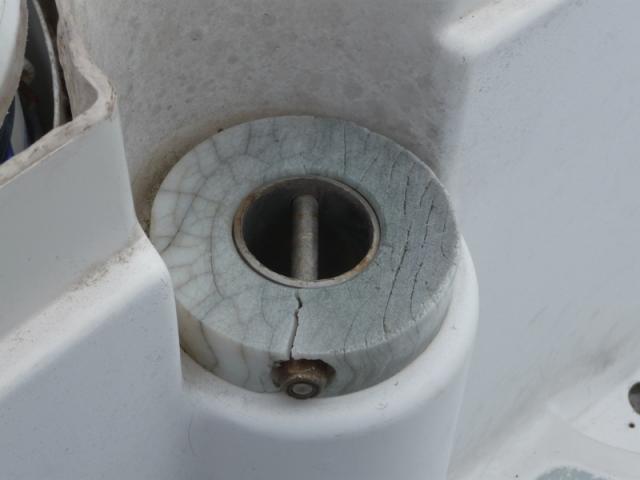

I thought I would share with you all a brief exchange I just had with Hunter Customer Service. This is the first time I have contacted Hunter CS and remember this was a Sunday evening.
From: Tony McMahon [mailto:amcmahon@ec.rr.com]
Sent: Sun 3/28/2010 7:13 PM
To: Eddie Breeden
Subject: 1984 h27 steering
I have just noticed a significant crack in the donut shaped bushing located on top of the rudder assembly (please see pix) visible from the cockpit. Do you know where I can get replacement or have one made? Also can I replace while boat is in water – how do I support rudder? Thanks. Tony McMahon
From: Eddie Breeden [mailto:customerservice@huntermarine.com]
Sent: Sunday, March 28, 2010 7:40 PM
To: Tony McMahon
Subject: RE: 1984 h27 steering
Tony.
It will have to be made locally. I would wait until the next haul out unless it crumbles. The bolt shown keeps the rudder held in place.
Thanks,
Eddie Breeden
Sent: Sunday, March 28, 2010 10:02 PM
To: Eddie Breeden
WOW, thanks for fast response – can you tell me the material.
It was a UHMW material. You might look into a Delrin type material. Most fab shops a re familiar with these types of plastics….< http://en.wikipedia.org/wiki/Polyoxymethylene_plastic >. We use them today for various applications.
Thanks,
Eddie Breeden
