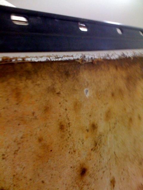

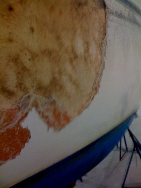

of our 82 H36 is definitely cored and not solid FRP. In November 2007, our slip neighbor's house boat caught fire, burnt to the water line and caused lots of heat damage to the starboard side of our H36. A lot has transpired since then, but the good news is that it is not as severe as originally thought and being repaired this offseason.
I had asked this forum and Hunter Marine about the composition of the H36 hull. Some reported it is solid laminate, Hunter Marine said it is cored from toerail to the water line.
The attached photos show a cored hull. These photos are at the widest part of the hull (pretty much opposite the nav station where the most damage was done). The outer layers of fiberglass delaminated and are being removed. The coring and inner layers of fiberglass are undamaged (whew!).

That is amazing news Mike. That Hunter would build a boat so similar to my H37C but use a different layup is very surprising. I can't tell from the pictures but I will take your word for it. You are sitting there looking at it. Good luck with the repair. Make her solid again.

Amazes me as well. I had noticed that, on sunny days from inside the boat, the hull looked translucent in a couple places (that were not covered by liner, etc.). This as well as info from other posters led me to believe the entire hull above the water line was solid fiberglass. Even after getting the email from Hunter Marine telling me the hull was cored, I thought the hull was fiberglass and Hunter must be mistaken (being an older boat). In retrospect, however, I think the places I saw sunlight through the hull were where there were thruhulls, which are solid fiberglass where the holes for the thruhulls are.

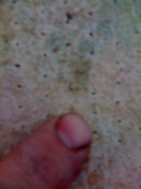

Just curious, Ed, have you drilled through the side of your H37 hull for any reason and confirmed that your hull is solid fiberglass? Has Hunter told you it is not cored? It seems strange to me too that such similar hulls of the same era would not use the same type of layup. What I see as coring material in the pictures (the brown stuff) does not appear to be wood (like end-grain balsa) but a manufactured material (like a thin layer MDF). It is perforated at about 3/8" intervals apparently to allow infusion of resin. As more of the damaged fiberglass is removed, maybe I'll have a better handle on it.

I'm rebuilding an '83 Hunter 25 that was Katrina damaged. It also is cored above the water line. ( except now where I just repaired it to remove delamination) Its a very thin foam... maybe 1/8 inch or less. I expect on some boats core areas may be ommited for stess reasons.

Ed - The H36 Cherubini model displacement is 13,500 lbm, substantially less than the H37C. I think the H36 was more an extension of the H34 Cherubini than a smaller H37C.
Dennis - The tan (brown) material beneath the delaminated fiberglass layers shown in the pictures above seems to be the foam material you describe, relatively thin. I picked a hole in it to reach the inner fiberglass layers and, near the toerail anyway, it is about 1/8 in. thick, maybe a little more.
