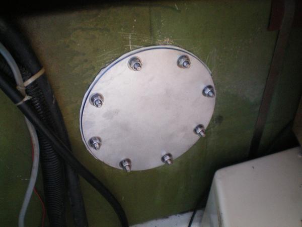

I installed an access plate http://www.downwindmarine.com/SeaBuilt-Tank-Access-Plates-p-91002326.html to allow internal access to my tank. I just drained the diesel, and cut the hole to the appropriate size. There is a vertical baffle dividing the tank fore and aft, midway in the tank. Most likely, a leak will develop at the lowest point in the tank. In my case, forward in a corner. If you can figure out (by internal examination) where the leak is occurring, it can be repaired using Splash Zone - https://www.go2marine.com/product/7...-788-kit-underwater-two-part-epoxy-putty.html
You could pull the engine to get the old tank out and re-install a new one through the cockpit floor hatch....that's the only way I can see if you intend to replace the 30 gallon tank. We are a Hunter 36, 1982 year.

Many thanks for posting your information and pictures. Your solution to the leaking tank is what I was originally contemplating ... but I wasn't able to find the information.
For now, I have already started to go down an alternate route.
But after that, I will contemplate repairing the OEM tank with your method of install access port, clean inside, then epoxy fill from the inside solution.

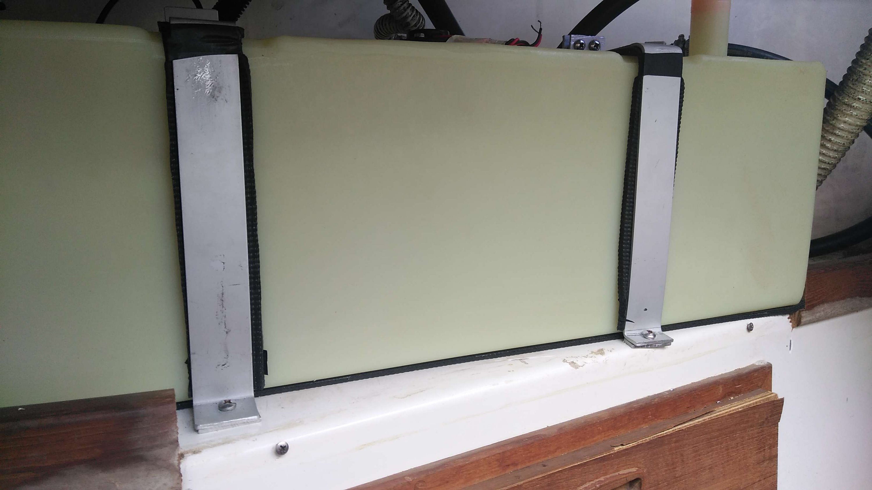

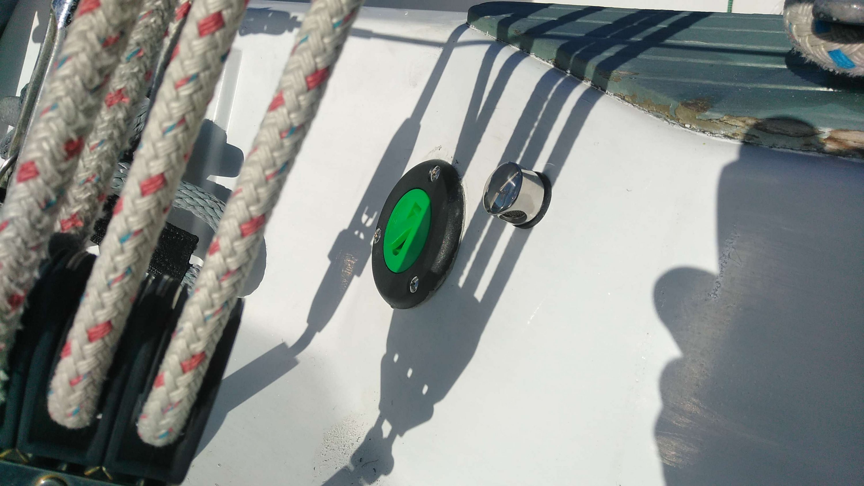

I read them on my mobile this afternoon while at my boat ... while still futzing around with my just installed new tank connections. I have included a few photos. And further below some description of the new tank installation experience.
I looked again today at the OEM tank on the port side. Possibly it could be removed if the bulkhead just forward is cut out. And the storage area with the sliding smoke plastic doors above the oven space is dismantled. Maybe?...Possibly?
As for removing the OEM tank without any destruction to the FRP, I think it would need to be cut into three pieces. When the middle cut section is removed, then the fore and aft can be slid into the resulting opening and extracted out and up through the open lazerette seat.

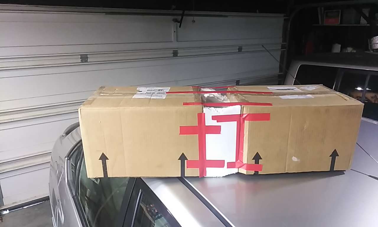

Yes, two smaller Moeller tanks probably could go in. But to be sure about the size(s) to order, the green OEM aluminum tank first must be removed. I think the only way the be sure about the replacement size is to make some "templates" out of cardboard that are the exact 3D dimensions of the contemplated replacement tanks. Be sure the templates will go in. And also there is enough access to strap them adequately. And there is enough access to install the 1.5" fill hose.
One of the attached photos is of a couple of cardboard boxes, taped together with spacers. It matches within .5 inch in all axis the dimensions of 13 gallon Moeller tank I was considering. Only after confirming that this mock tank fit into the lazertette opening and then onto the starboard side shelf, did I actually make the purchase.
The other two photos are of my installation.

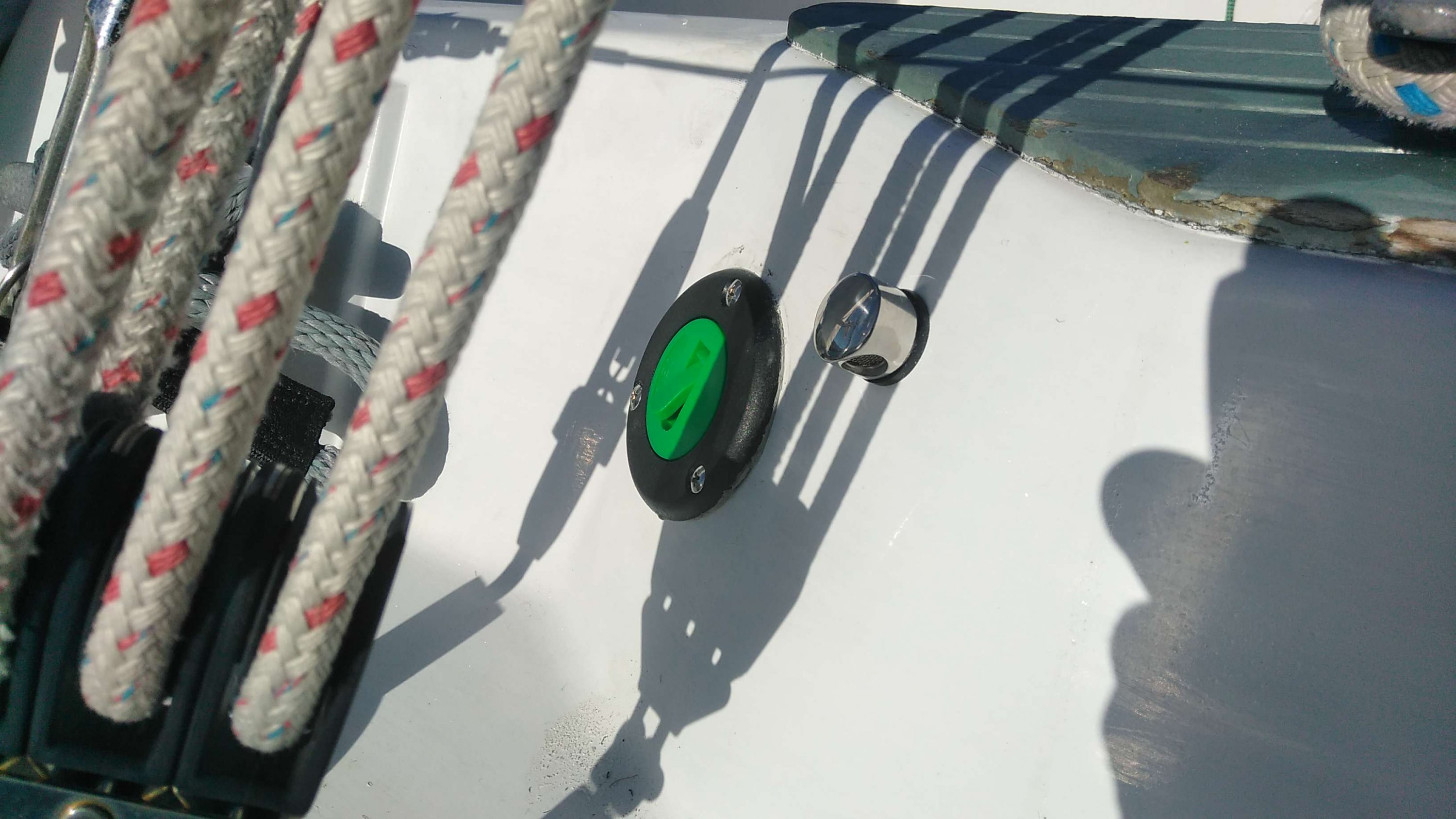

My main issue now is getting out 100% of the OEM tank's contents. So it won't continue to leak for many more months. I was able to use my boat's electric fuel pump to remove about 18 gallons of good fuel before it began to suck air.
One pleasant surprise about the Moeller plastic tank... it is quasi opaque. I can see the fuel level through it just by opening the lazarette seat. No need for a fuel guage!
