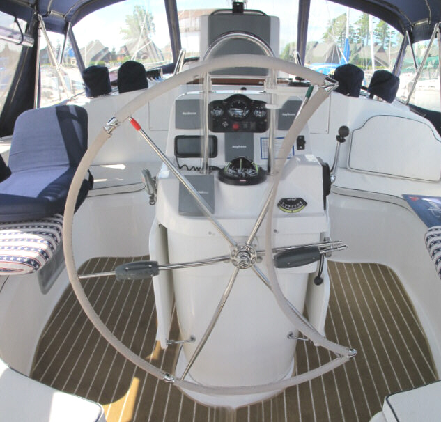

I have a 2001 Hunter 410, I'm interested in upgrading the Chart Plotter 1 which is a Raymarine RL70 C along with accompanying gauges and radar installed. I have another Chart plotter 2 (same model) networked with helm station unit and mounted below at nav station which I have seldom used primarily due to our cursing lifestyle to date. The old Chart plotter has seen better days and its getting time for an update. Im looking at the Axiom 9 wanting a MFD and something with a forward looking sonar option. I could do with or without the Chart Plotter located below deck at this time. I also have looked at the SIMRAD. Im also not sure where the transducer is located since I purchased the boat used and have not needed to locate it to date any direction on this would be appreciated. So my questions are pretty much as follows.
1. Any experience installing a new Chart Plotter that has older accompanying instruments? They are mounted on the cockpit pedestal.
2. Any suggestions on the sonar? Would radar connect and still function with a new MFD unit?
3. Thru-hull transducer could or could not be used or get new one?
4. Get some friends and some beer and install it or get professional installation then drink?
