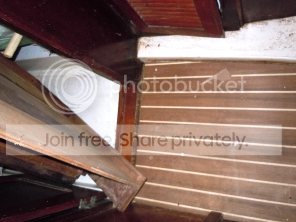

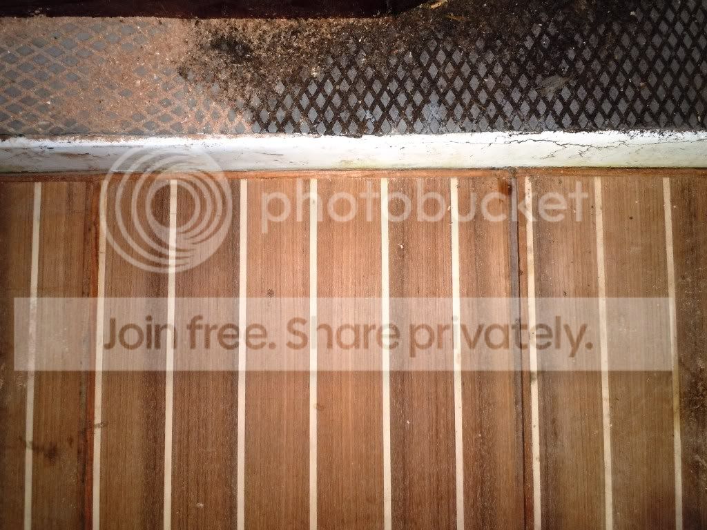

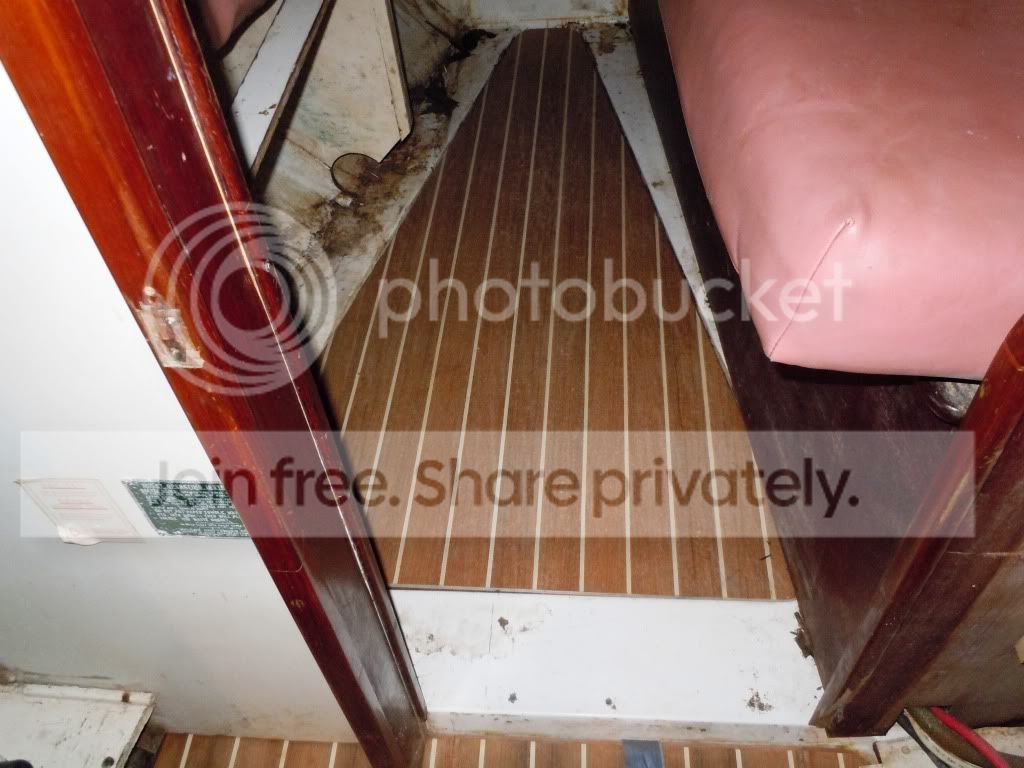

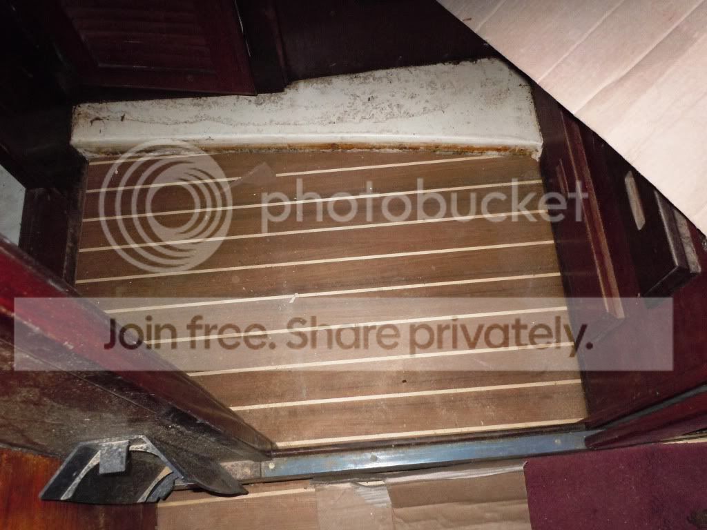

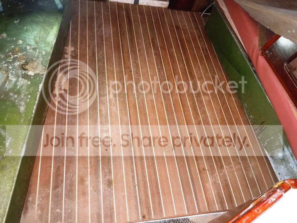

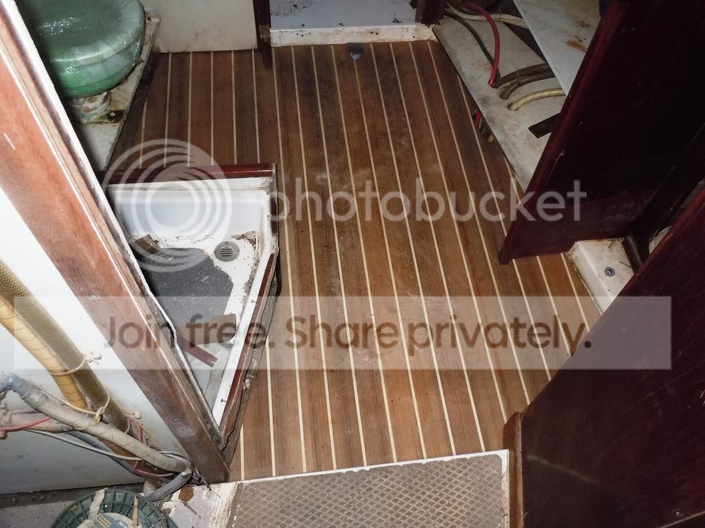

It's been a long two weeks on the H-54. As you can see the cabin sole is done except for some trim, fastening and polyurethane coating.
We'll start from aft and work forward...
Galley
Nav

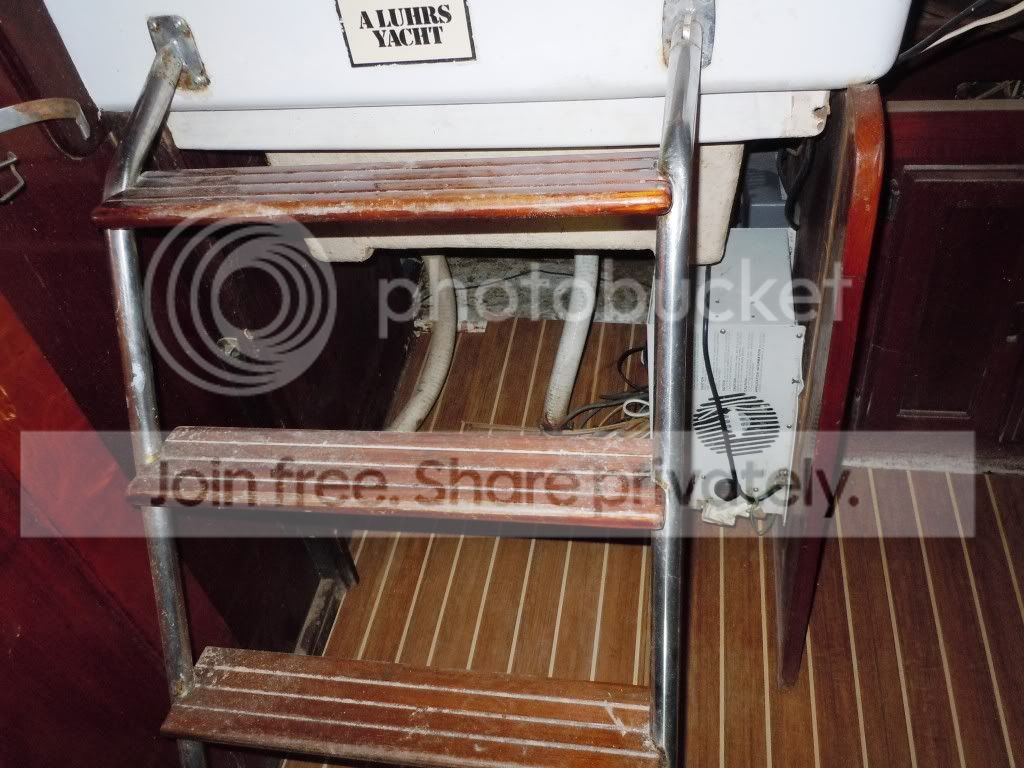

Aft berth
More aft berth

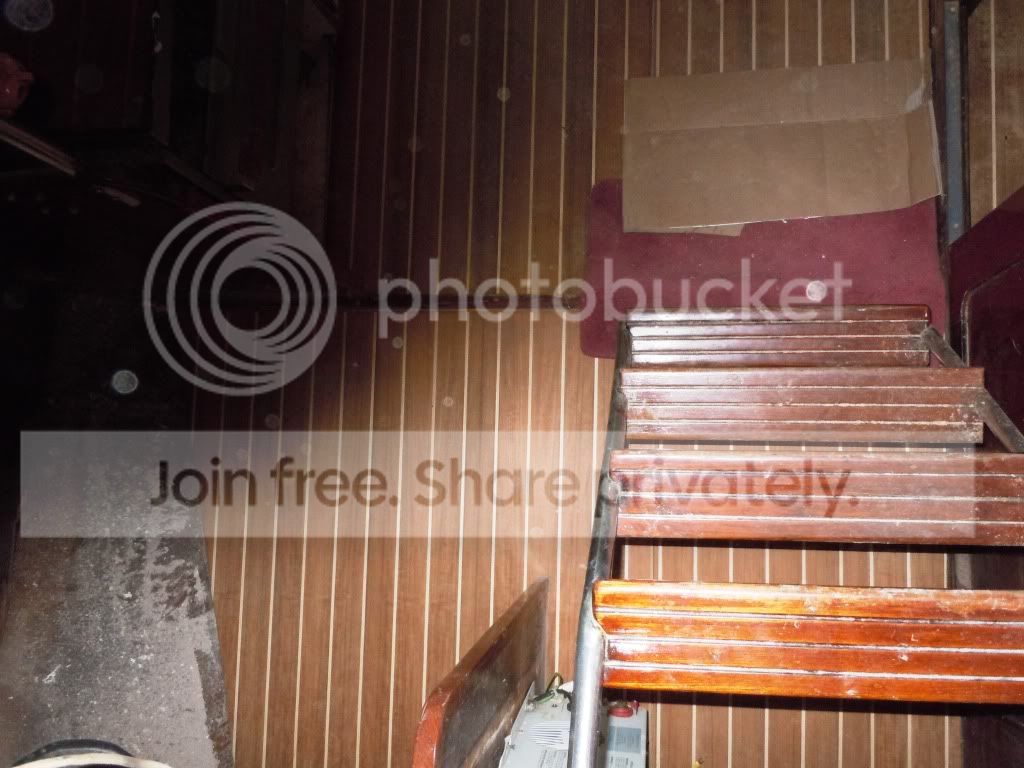

Salon
Forward head area

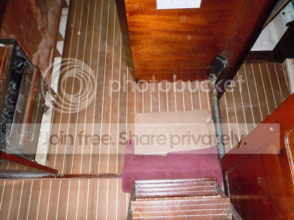

V-Berth
Close up of bilge access teak trim

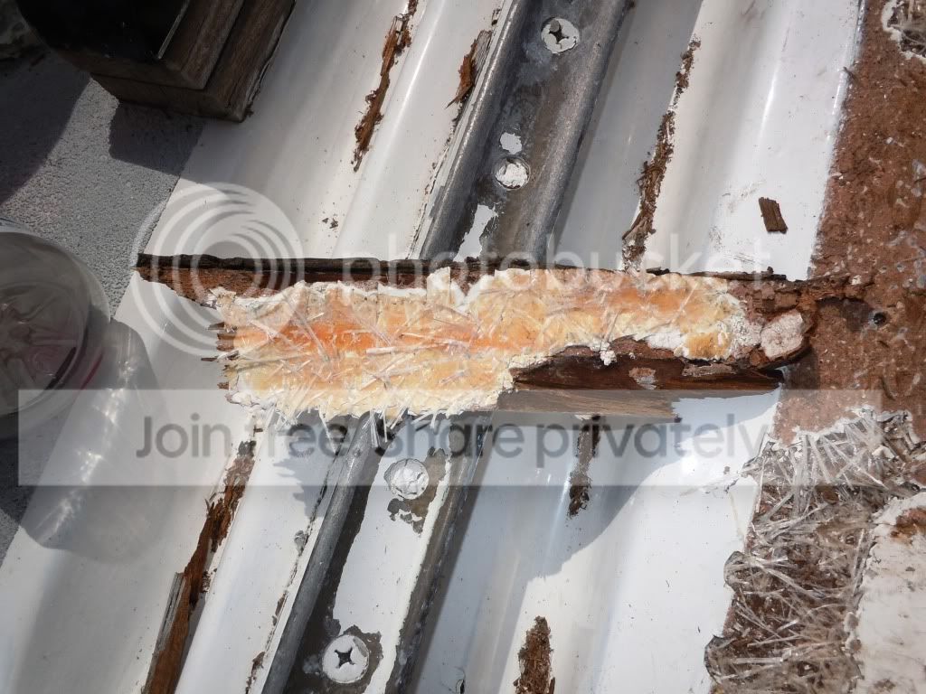

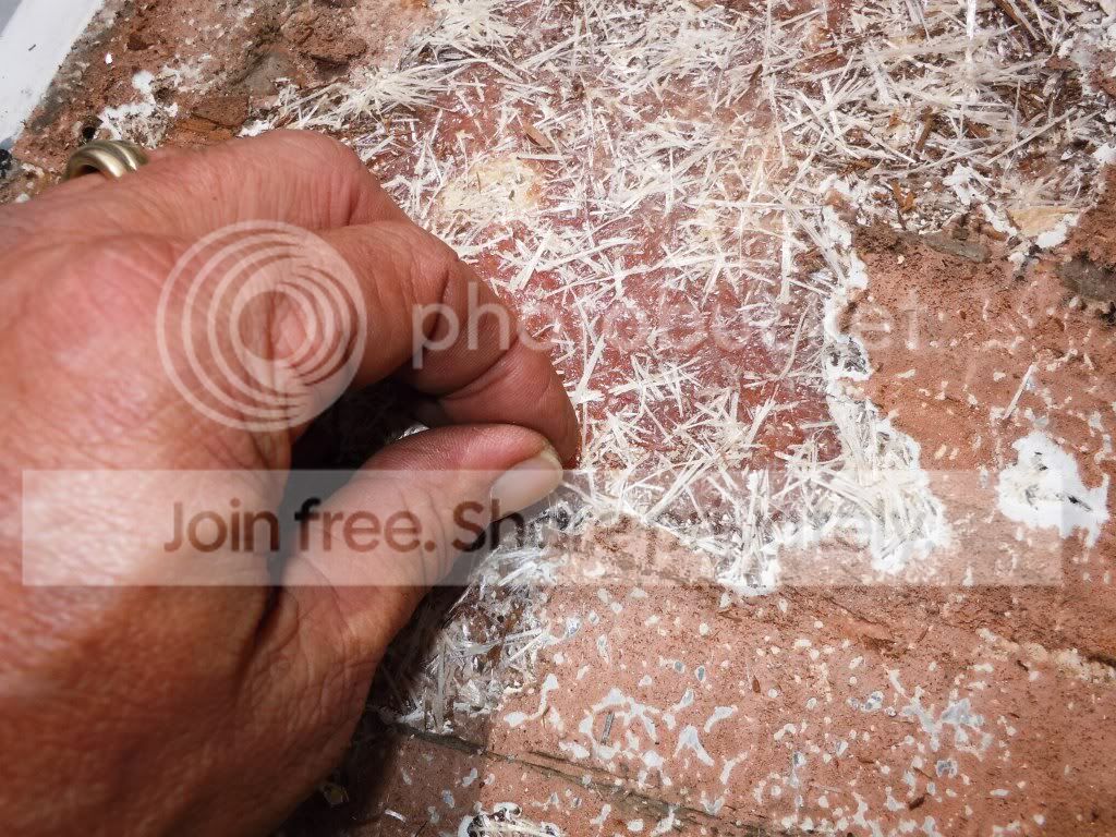

Here's a couple of shot of what we're dealing with after the teak comes off.
Apparently, Hunter didn't get enough resin against the gelcoat and I can reach down and pull fibers out with my fingers.
Much of the forward housetop is soft and will need recored. The side decks are not as bad. Maybe a layer of glass will do the trick.
