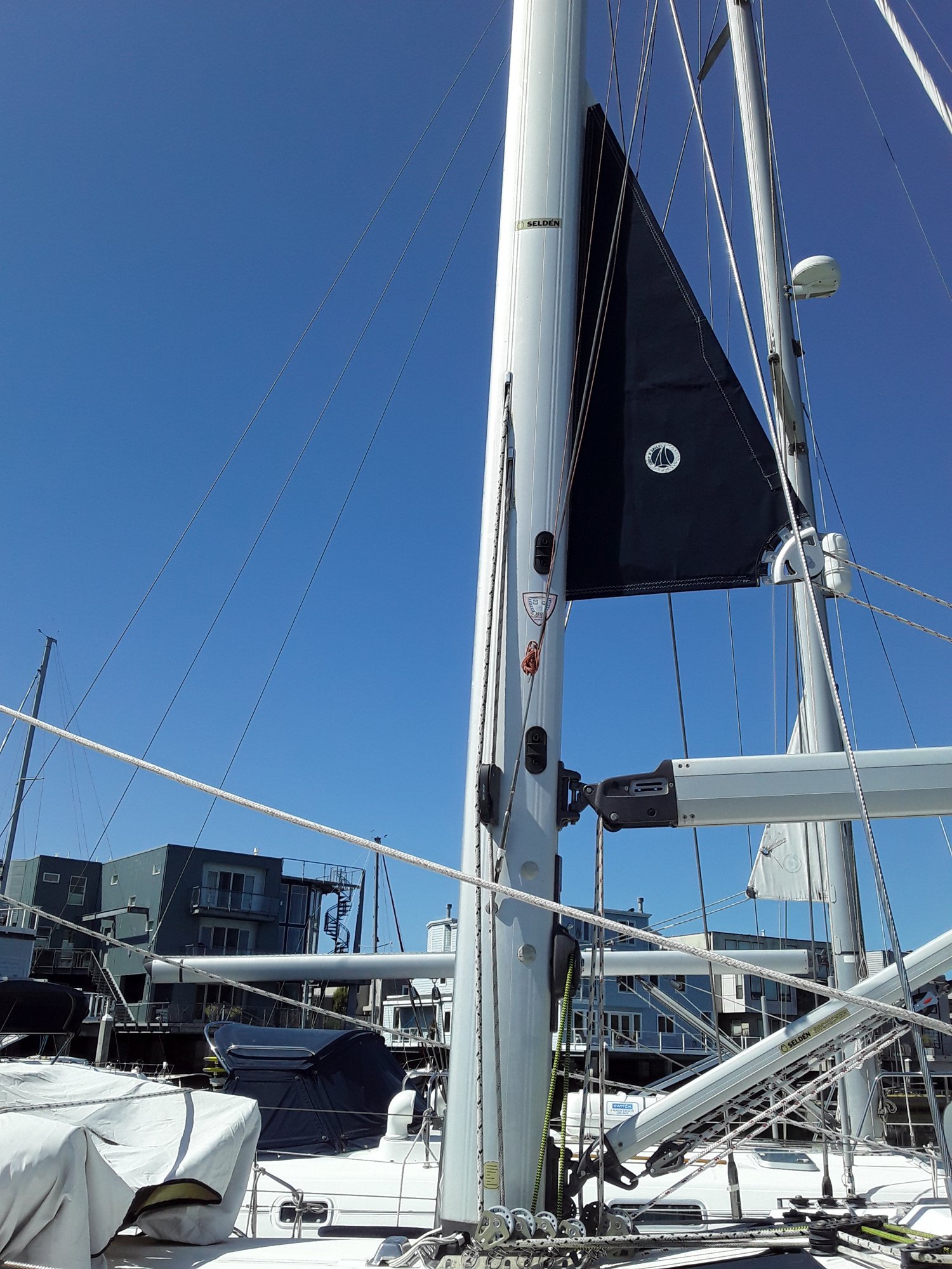

Hi everyone, I'm in the process of measuring for a new furling mainsail. I've never been happy with the 160mm mast pretend and feel it inhibits smooth furling, especially as sail becomes a bit fuller. In rig documents I see 150mm prebend is normal, is this true as well for inmast furling rig? do others know what their pretend measurements are?
thanks again in advance
