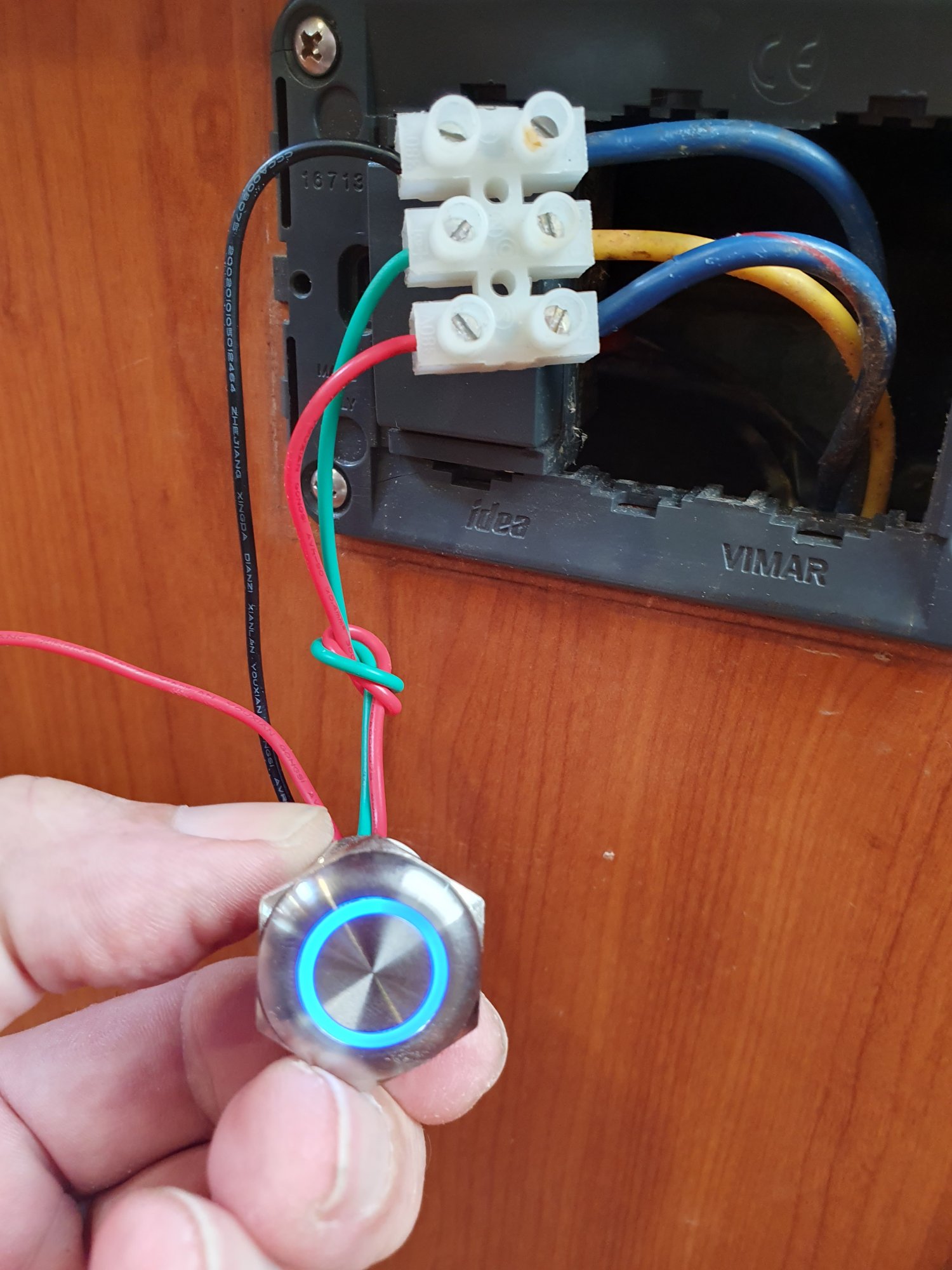

Hi, Yea ya probably three weeks late for me. However I thought I would share some general info that might be helpful.
Yep Im in Ozy now typicaly though further north between +-8 degress.
In reference to the original fluro lights, the inverter inside normally dies and I have had them fixed many times over the 15 years. I move partly to Leds & original fluro combo for while as a make shift measure that ended up being a couple of years.
For those that don't know the existing fluros are powered all the time and not from the switch. Each fluro has 3 wires, plus minus and control. All the dimmer switch does is raise and lower 12v on the control switch. The Dimmer is NOT Vimar product as per all the other switches, or if it is Vimar that don't recognize it.
I was not looking for as much sophistication as TJ is. Essentially my fluros were now beyond repair and the swithc has had worn through the bezel. VImar could provide a new one.

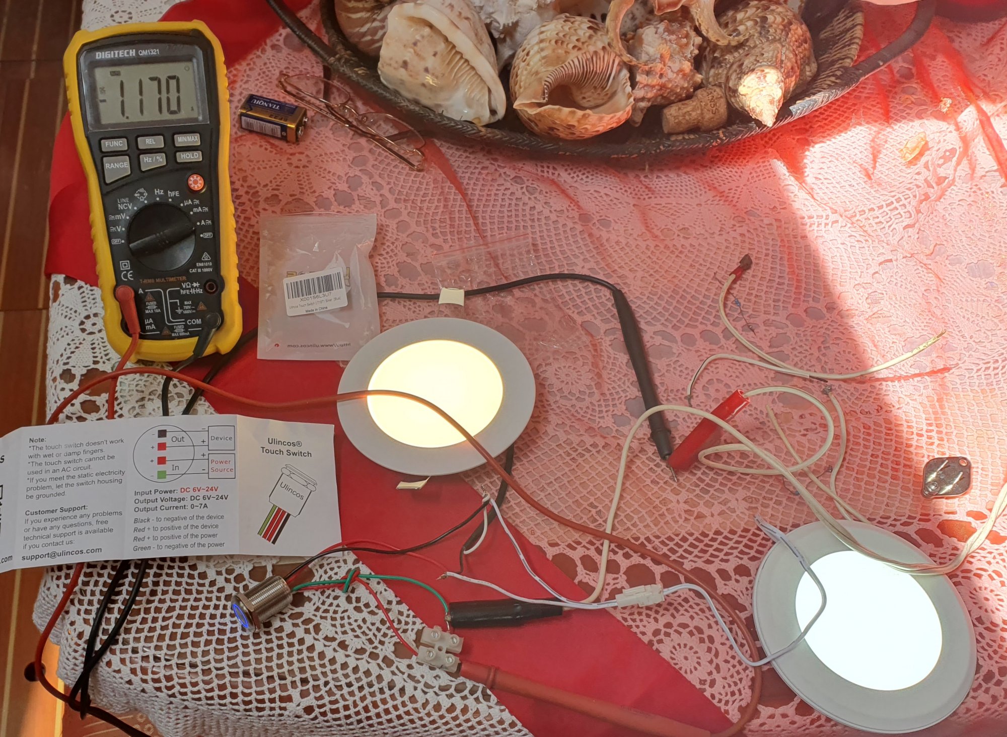

So I moved to these LED's replaced all 6, they drop into the Chrome fitting, now mounting required, thought they are not snug, but they wont fall out.LeisureLED 5 Pack RV Boat Recessed Ceiling Light 480 Lumen Super Slim LED Panel Light DC 12V 4.75" 6W Full Aluminum Downlights, (Neutral/Natural White) : Amazon.com.au: Automotive
Sadly only 5 so I bought 2 lots, and I will use them throughout.
I wanted to move to touch dimming to I bought Ulincos Touch Switch UT19T1 Stepless Dimming Switch DC 6V to 24V Blue LED Suitable for 19mm 3/4" Mounting Hole : Amazon.com.au: Home Improvement
Each LED light draws about 0.6amps full brightness. So total load is about 3 amps for all 6 full brightness. The touch swatch is rated well above this, so it should be fine.
You can chose to get the above switch in different forms with or without its own lamination which draws under about 0.06
This has only be installed for a week, but so far it works just fine.
I removed the original dimmer from its housing and for the moment simply cut a whole to fit in where the dimmer was. Assuming it continues to function I will make up a tinted Perspex Bessel and slowly migrate to all touch dimmer able. It will not be as per original for sure, but you cant repair the dimmer Bessel nicely.
In reference to measurements in the original post. There is 70mm from the front of the Vimar switch to the left hand side of the fridge which is behind the switch. However when I first poked my tape measure in there it went for ever, and it actually went across the top of the fridge. So essentially the top half of the switch has nothing in its way. The bottom half of the switch has a gap of 70mm as noted.
Hope it helps.
