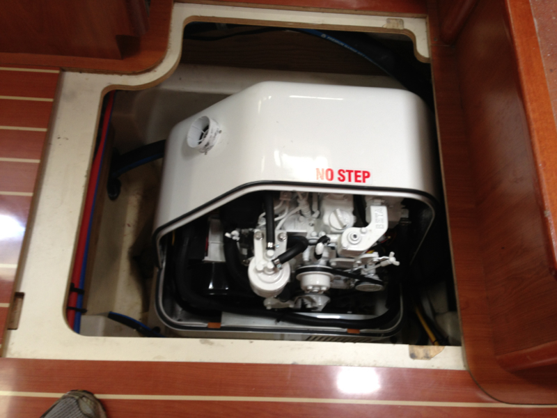

It's not structural in fact that whole board sits under a engine cover that supports the companionway steps.
The engine cover is to the right of the generator
What make, and size of generator is that?

I wasnt thinking vertical structural support, but lateral. Such as bumping a dock, would it transfer loads to the other side. No biggie, just observing.
By the way, I like how they encapsulated the genny, thats gotta be pretty quiet.

The genset I have is a 12kw Fischer Panda, which I just love.
It is super quiet, in part because of the excellent install Hunter did with a water / gas separator. Sitting in the cockpit having dinner, you can't even hear it running. Way over-rated for the boat. You need to run all your airco units etc to ensure you aren't running it with too low a load.
