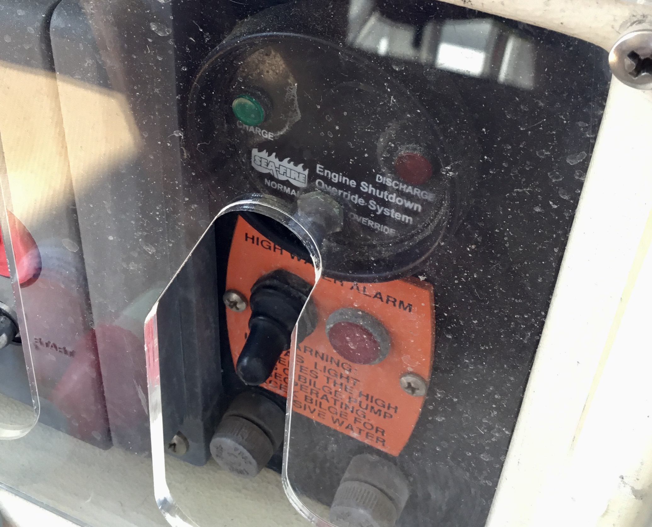

Guys problem was in this little gauge. In "normal" position of the toggle switch I would get red "discharge" light with audible tone. Engine would not start.
In "Override" position of the toggle switch tone silences and engine starts right up.
What is this device do?
Dennis
