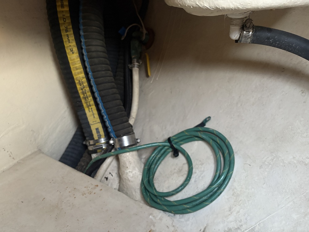

Hi,
I recently purchased a 2001 Hunter 460 which had had significant work performed by a boat yard about a year before I took possession. In the aft port locker, I discovered a large (8 awg?) AC Ground Wire (green with a yellow stripe) neatly coiled up, but connected to nothing at this end. (See photo). The other end appears to go to a stud attached to my propeller shaft support strut (?) aft of the engine compartment. (See 2nd photo). The only wiring diagrams I have are for a Hunter 466 and are unclear as to specific connection points. Any thoughts on where this was originally connected, or if it is just 'pre-wiring' that was never used? My diver has reported rapid deterioration of my propellor zinc. So, I suspect this ground wire should be attached somewhere. But where?
Fair winds,
Rob

It isn't an AC ground wire, but a bonding wire. This is used to bond all underwater metal together electrically so they all remain at the same DC potential, with the goal of preventing current between them, thus stopping stray current or galvanic corrosion.
Likely candidates for the other end of that would be a thruhull, the steering system, or even the engine block if it is not meant to be isolated.
My guess is that your rapid anode depletion is not because this wire is disconnected. You might want to look for other issues like stray current.

It should be a #10 wire, that should ground most everything metal on your boat.
Then your engine is grounded by the [ - ] terminal on your battery, which should reduce Zinc loss.

I agree with Mark on the anode deteriorating - having a bonding wire disconnected would leave the anode doing less work than intended, so it would corrode slower, not faster. So you may need to track down two problems.

Thank you Mark. This is VERY useful. There is an Air Conditioning thru-hull near there that's above the water line. Nothing else is close by. However, the cable is long enough that it could have gone to a lot of other locations. I'll continue to investigate.

Hi Jim, You're right! 10 gauge (not 8). Thank you. Rob

Hi David. Thank you. The loss is definitely not slow. It's loosing >20% of its mass each month. I'll feel very fortunate if this turns out to be only two problems. (Smiling). Fair winds
