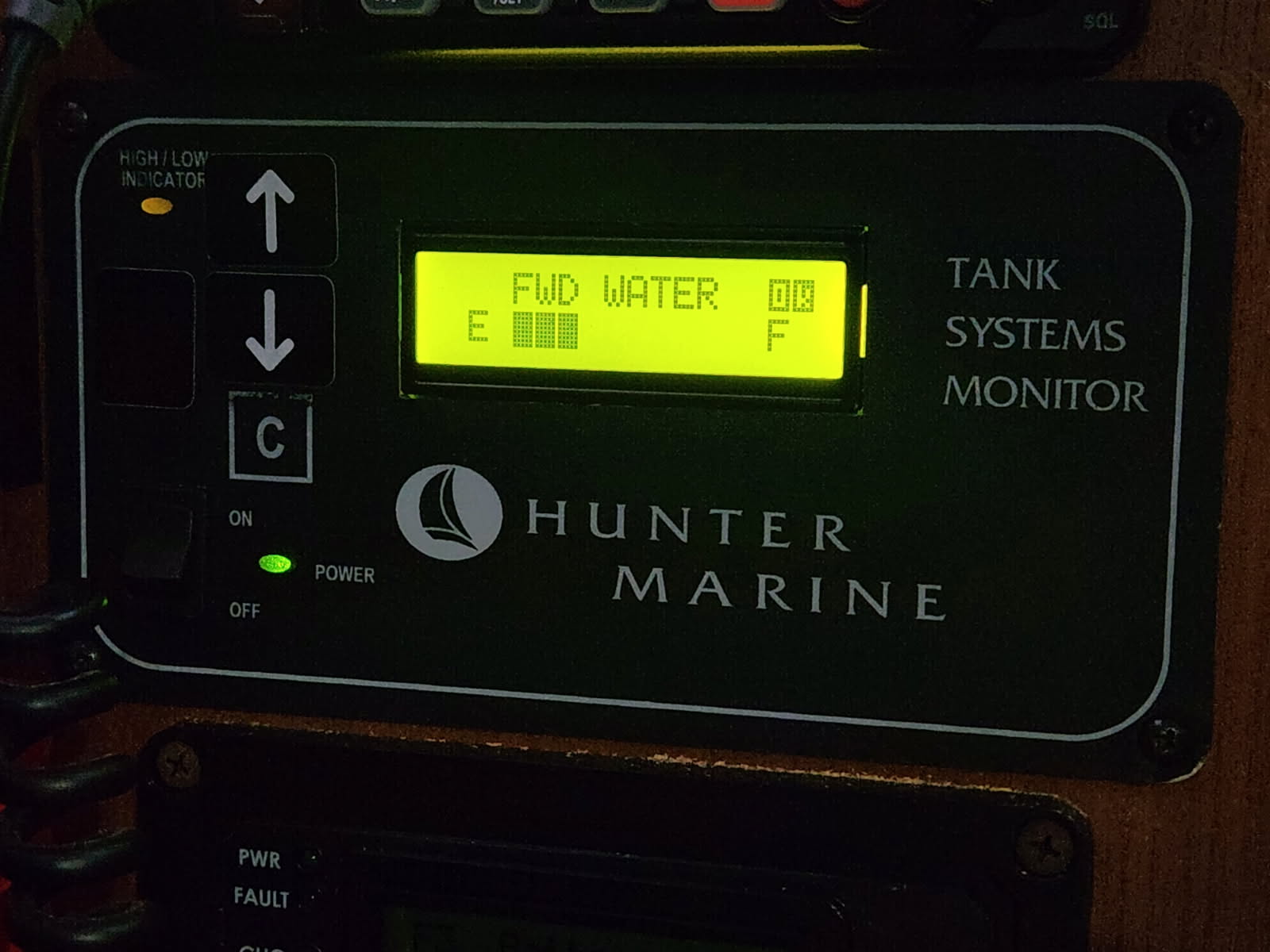

B Believe H46 . Dec 10, 2023 23 Hunter 46 Corpus Christi Mar 16, 2025 #1 You can replace the LCD. Plug and play but need to solder new connector male pins on it. Digikey PART: 3387-ACM1602KR-FL-YBW-ND. 15 bucks. Cheers! Attachments IMG_20250316_160812.jpg 129.6 KB Views: 87
