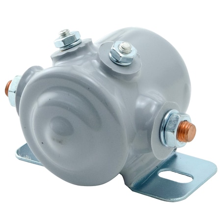

Hunter 410 MDR
It looks like this on my 410, it's behind the wall under my nav table next to the windlass breaker.

It’s a 12v solenoid. Look for a metal can with some heavy gauge wire running from it,
The Blue Seas ACR wasn’t available when your boat was built. This solenoid is activated by the engine key switch
